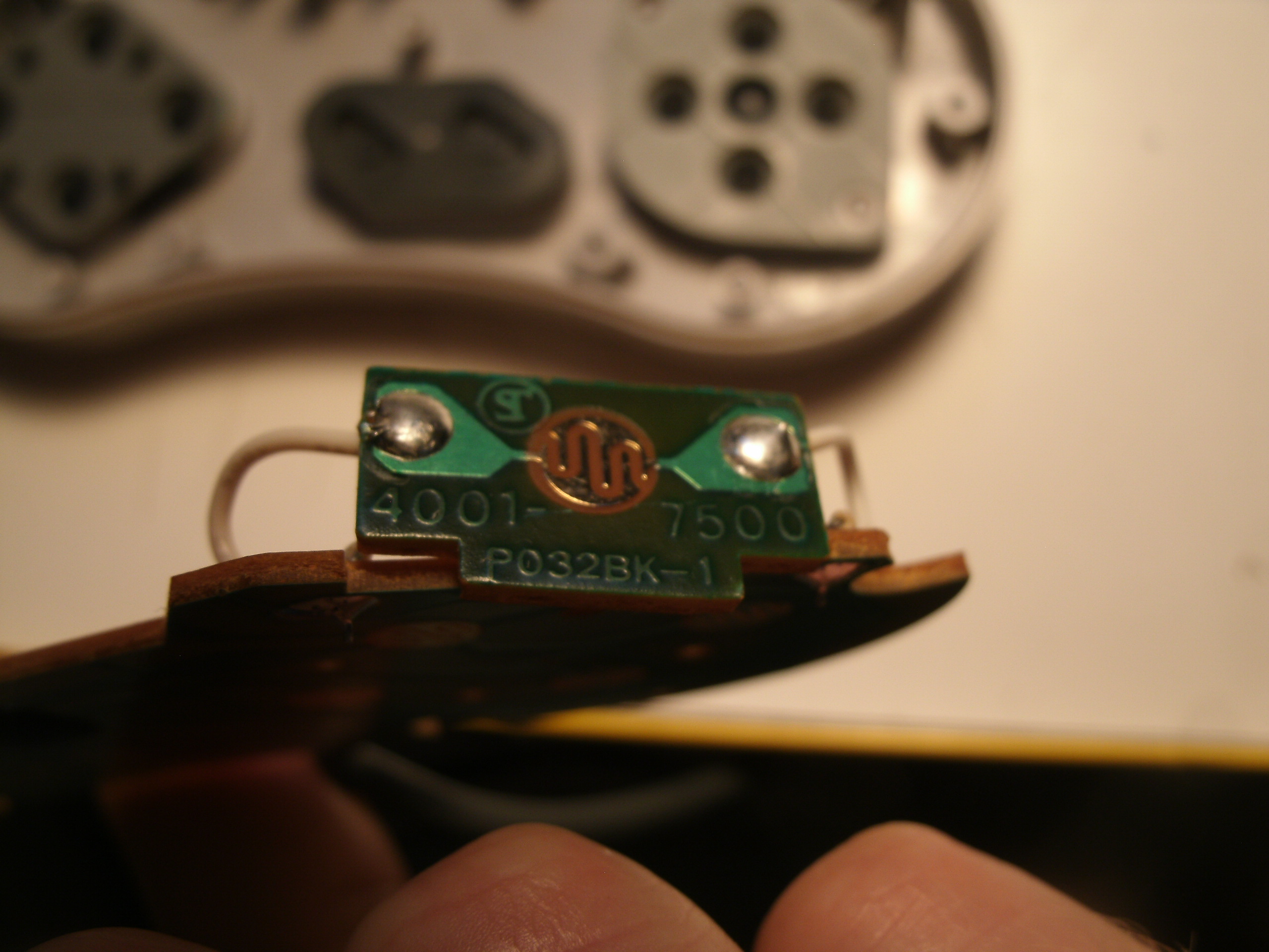

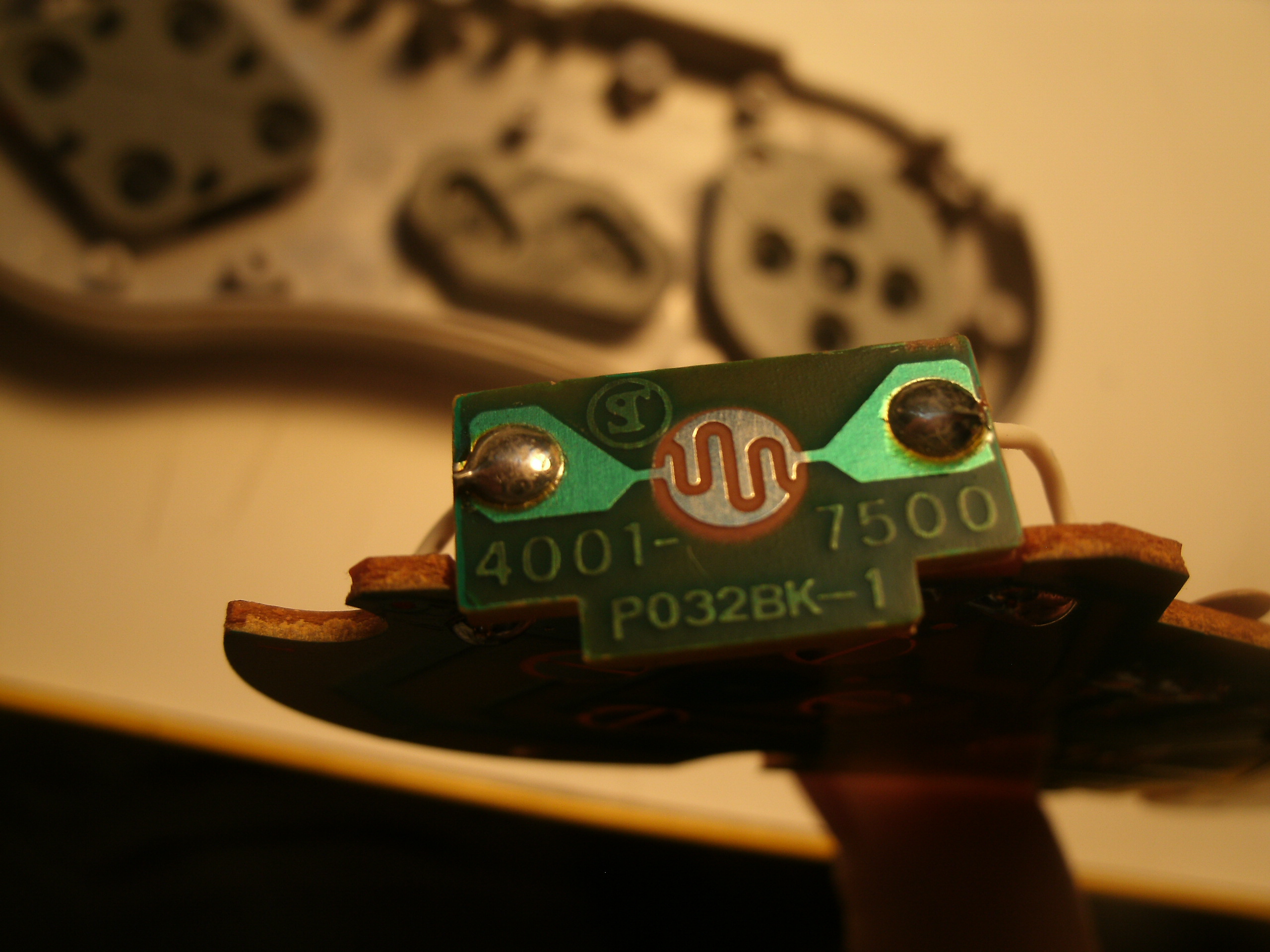

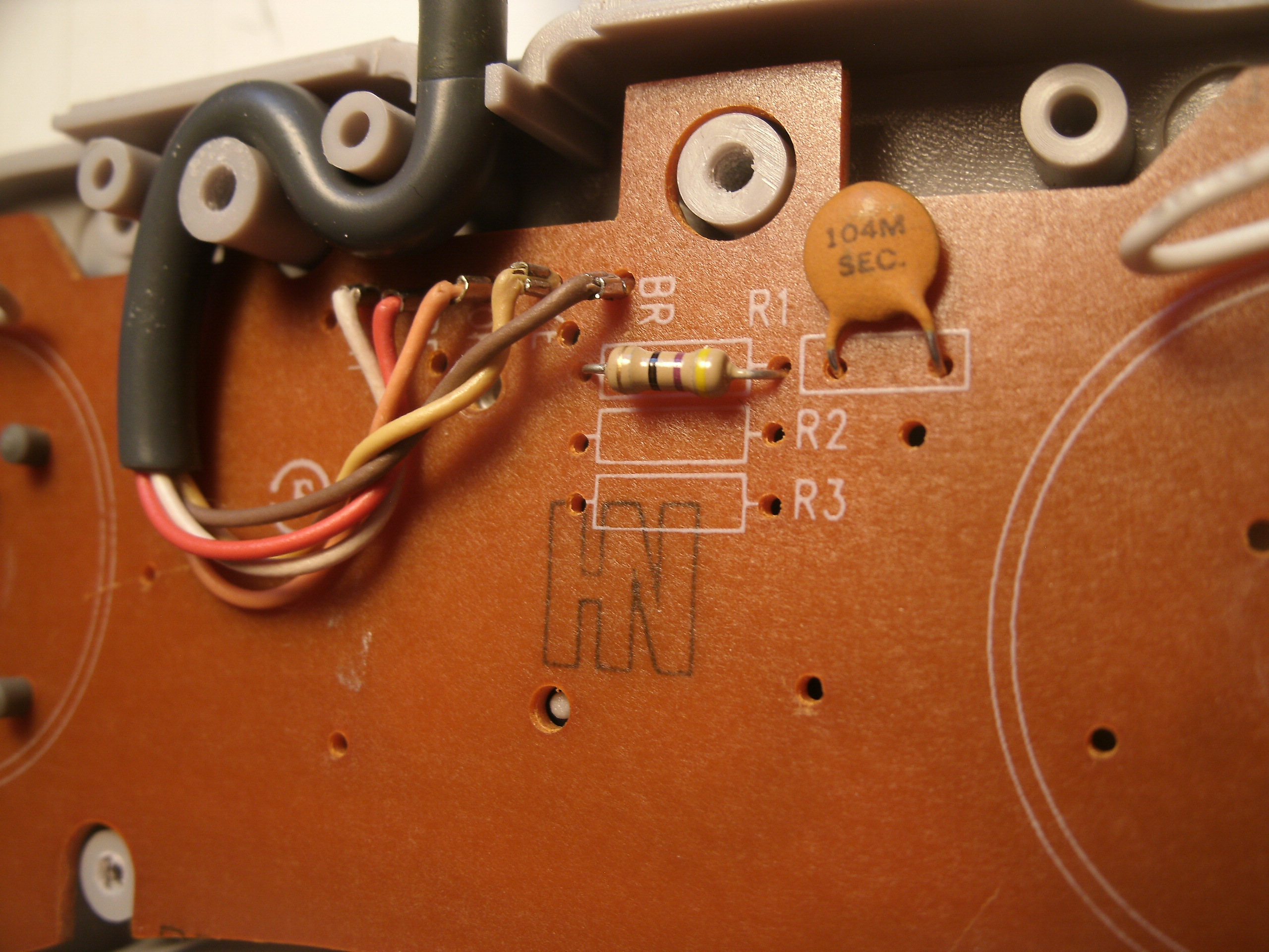

Hello!
I have issues with a third party snes controller made by InterAct: Super Pad.
I thought sharing it here could help me find clues.
What happens is that if I move the controller while playing and holding the B button, then the controller "presses Start by itself" so the game pause.
While playing Mario Kart, I noticed that when it presses Start, it also moves Up or Down too and since I hold B, it resets the race!
I opened the controller twice. The second time, I cleaned with alcohol the contacts, but mostly everything was clean already.
The solders seem ok too..?
Could it be the cord?
Here's some pictures along with this message.

on the picture GEDC1188.JPG seems that the solder points are almost touching each other on the line on the left, near the D-pad contacts. Check continuity there.
Check if the resistor is, well, resisting correctly.
Check if by placing the multimeter on continuity mode the buttons react if touching both exposed traces on either side of the buttons.
Also, clean the rubbers. Water, soap. Let dry.

Little update after a year later...
I checked with the multimeter and the buttons are well reacting!
about the resistors, I need to change my soldering iron, not heating well at all. so I can't put them out to test them and resolder them.
however, I cleaned the rubbers as suggested.
the problem still occurs and my guess is that there might be something wrong within the cable. it's really when I move the controller around that sometimes I lose the connection with the console and when the current seems back in, it sometimes presses another button like L, R, Start, etc.
So if I do not move at all, I can play for a while without issues.
To be continued...
