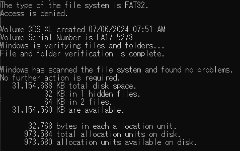

Tested with h2testw and returned no errors, formatting the SD seemingly - at least visually - deleted the files that wouldn't go away but I suspect that not all is resolved as chkdsk returns this.
Which falls in line with this here, having invisible files taking up a few KB. Also, It is no longer 32GB, and instead 27.9GB which I find weird as h2testw claimed it had no issues.
What do you suggest doing next? Is there anything I can do for this SD Card or should I just move to a new one? It has been functioning seemingly without issue on the surface but I still don't feel right about the size change and the weird files I can't see.
All good and normal. The usual 1000 vs. 1024 calculations. 10243 > 10003
1GB is 10003 Bytes for manufacturers. Available space is roughly 31,900,000,000 Bytes in your screenshot. 👍 :)
You can continue using such an SD after it passed the test. Keep an eye on it, backup the data form time to time. If it corrupts again for no reason I would replace it. File system corruption can have pure software (crash for example) reasons with no hardware problem at all.
