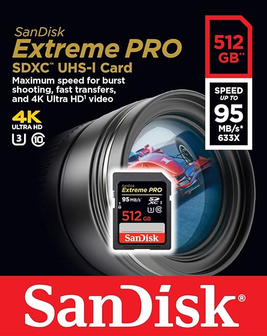

Hi Guys, back from work.
The exact SD-Card Type is SanDisk Extreme Pro 512GB 633x 95MB/sec.
It's the card that I usually use for my Photoshootings with the DSLR Cameras
As I do a lot of RAW 4k Video Stuff and HDR RAW Photography you never can have enough Storage ;)
Basically the 256GB version of the card should perform the same. But for sure I know that the cards below 256GB use some kind of different controller on the SD-Logic board.
Following you can find the card that I use.
Unfortunately it's only in german but should give you a rough idea how the card looks like:
http://www.amazon.de/SanDisk-extrem...=1456251107&sr=8-1&keywords=extreme+pro+512gb
Cheers, CableLeecher :grog:

Thanks for that, that's a nice BIG card! it's also worth twice as much as the console... :) I'll be curious to know how long it takes you to load Wonderful 101 on this bad boy... Also what do you use to format your sd on OS X? here I use SD formatter (https://www.sdcard.org/downloads/formatter_4/) for low level formatting, followed by this command line in terminal to change the cluster size to 64K:
newfs_msdos -F 32 -v NameOfVolume -c 128 /dev/disk2s1

I don't format the cards on MacOS X as it would write the Apple specific hidden folders on the card. Even tho I work on MacOS X El Capitan with Photoshop etc. I format the SD-Cards on my Business Notebook (Windows 10) with guiformat.exe
https://www.sdcard.org/downloads/formatter_4/eula_windows/SDFormatterv4.zip (Windows Version for LLFormat)
http://www.ridgecrop.demon.co.uk/guiformat.exe (GUI Version- Limited to 64k Clusters 2TB HDDs)
ftp://ftp.heise.de/pub/ct/ctsi/h2format.zip (CMD Version - Limited to 256k Clusters 8.8TB HDDs)
