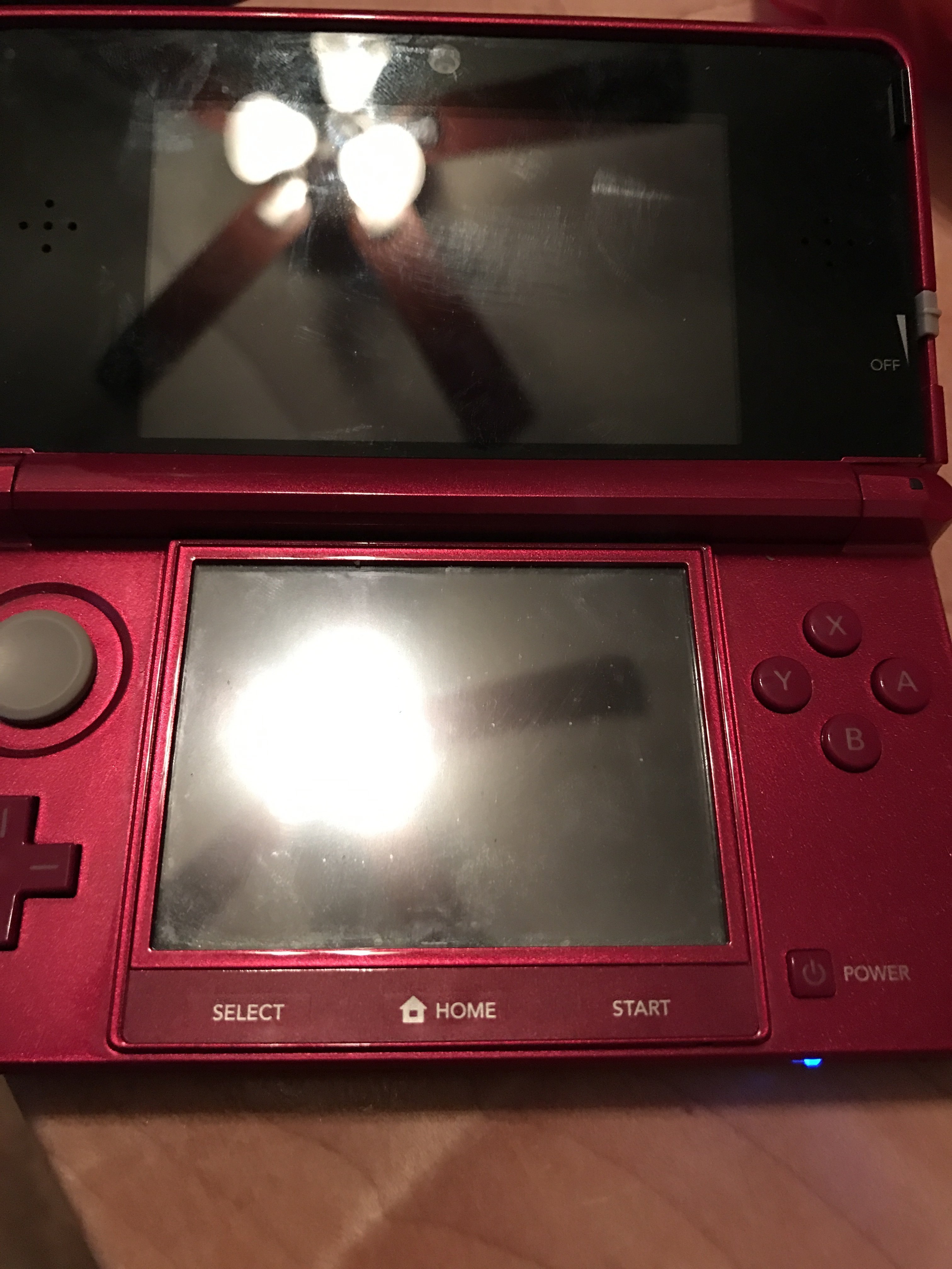

    hi all, i have an old 3ds which i downgraded to 9.2 i did the auto ctrnand transfer, but when it try to back up the sysnand it telling me there is not enough space on the sd card giving me two option continue or press B to go back (stupid of me press A continue)which came out fine system got down to 2.1 so here is the part that fuk it up. i install the a9lh by pressing Select button. and it was successful, but when i try to turn it back on just the blue light on black screen appear, i need to hold the power button for 15 seconds to force it to shut off. thank you

    follow the steps, but no luck still black screen with blue light

    So you can boot payloads? That's good at least, but no backup...
    Try making a backup of sd then deleting the "Nintendo 3DS" folder and see if it boots.
    Also, what guide where you following that has you downgrade to 9.2 then to 2.1?

    I use one of the Spanish guide on YouTube I hacked at least 5 3ds this is the only one that got me in black screen (no back lit light) just black screen pitch black. Any other solution I could try? Hard mod would bring it to life even without the nand back up?by the way I'm not the only one with this problem.

    Correct. A hardmod will do nothing for you without a NAND backup.
    Strange that even after completing a 9.2 ctr transfer it fails, you tried this https://3ds.guide/9.2.0-ctrtransfer.html correct?

    Download hourglass9, rename it start_h9 and put it under /luma/payloads and try booting with start pressed
    Also try deleting the Nintendo 3ds folder
    2.1 sometimes can take longer than normal to boot

    No luck either, still black screen with the blue led light.

    You might as well be holding one of these:
    [​IMG]
    Only thing you can do now is buy a motherboard replacement. Check aliexpress, they have some cheap ones.
    Next time, follow a trustworthy guide such as 3ds.guide and make a NAND backup.

    that brick is too heavy, well I hack at least 5 device and back up all five. This is the only one didn't backup nand which is the only fuk up. Changing the mother is complicate right? Let me check YouTube for that. Thanks for all of your help and respond. Thanks

    Have you tried placing Decrypt9WIP.bin on the root of your SD as arm9loaderhax_si.bin (and removing the current arm9loaderhax.bin) to see if it does anything?

    Where do you get this si bin? I'm planing send it out to change the motherboard $30 bucks on ebay

    My suggestion was to download the latest release of Decrypt9, extract Dectryp9WIP.bin to the root of your SD, and then rename it arm9loaderhax_si.bin (and remove the current arm9loaderhax.bin as I am not sure which it uses if both files exist). If the console isn't completely bricked, it will boot into Decrypt9.

    I'd do it with luma3ds's - name it arm9loaderhax_si.bin put it on root and see if that solves it.

    Nope! Still the same, guess need to spend that $30 bucks

    I saw someone said, if the console could boot into any payload (Luma3DS/Decrpyt9/Hourglass9,ETC).
    May be the cause is the nand is messing (by CTRtransfer or whatever).
    A NAND backup is needed to fix this issue. Not sure this is true or not.
