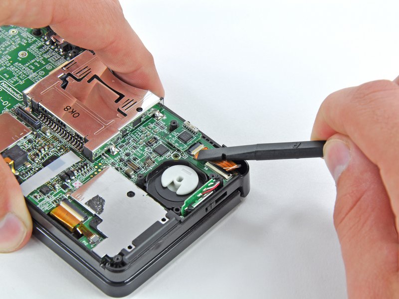

The 3 ribbon cable that are not plugged are the most difficult connection, be very careful, if you bend the cable too much, you will break it:
You must connect it correctly:

You only need a precision tweezers for connect the 3 flex wire. I recommend this guide instead of the other because this show the 3 flex wire connection that you need.

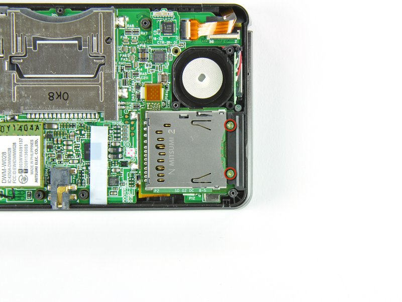

The ribbon cables actually look fine, but you won't know for sure until you put everything together to check, more than likely though the antenna cable is broken. You can get away without fixing it but the WiFi range will be terrible, a new antenna is cheap but a pain to replace.
Check iFixit for all the info you need, and see for yourself if you want to attempt to fix it.
https://www.ifixit.com/Device/Nintendo_3DS
Thanks :) i gave up trying to unscrew the thing that is behind the battery but will retry today or get someone to help cause i cant unscrew them really
