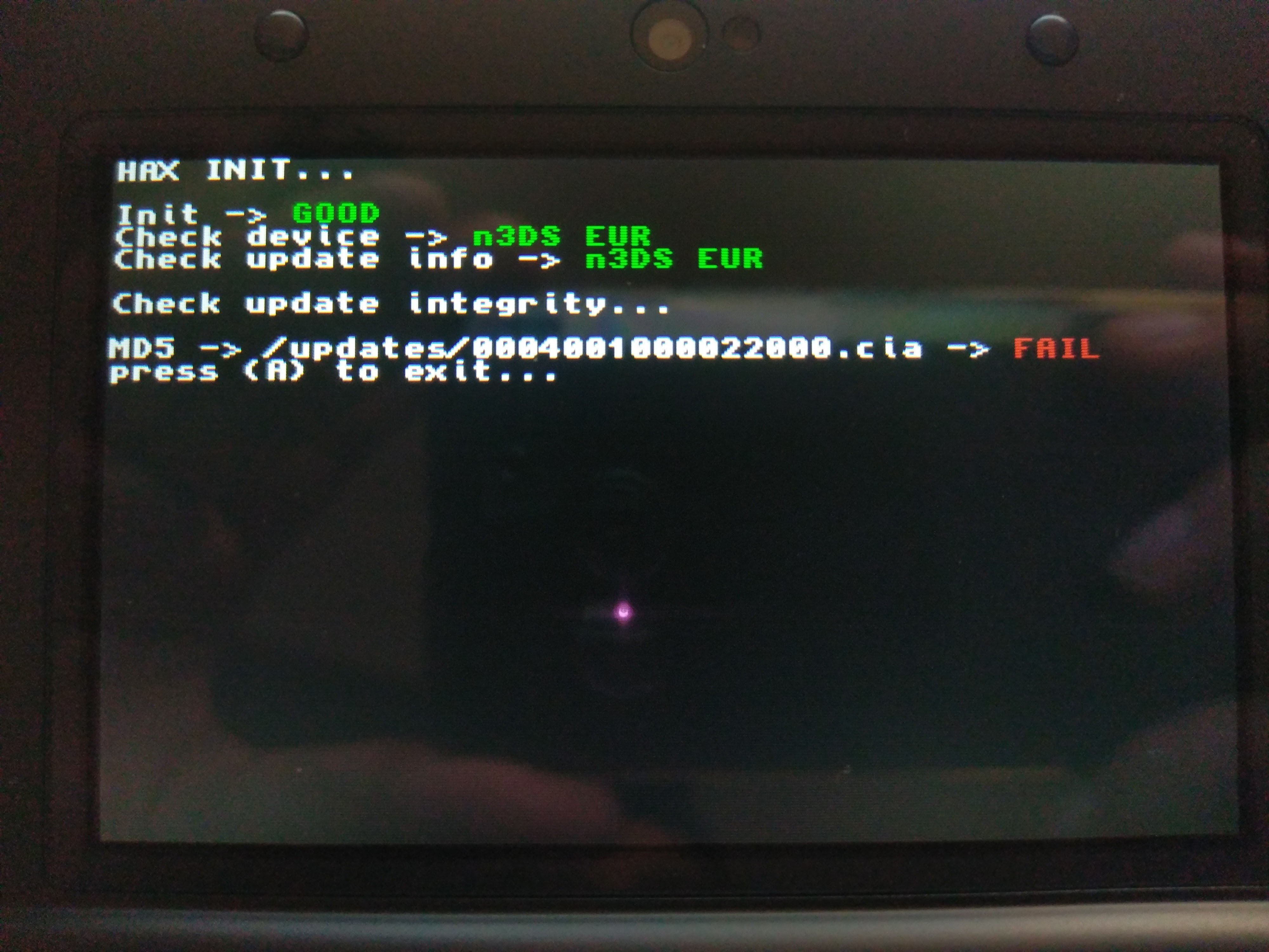

Hello - A little stuck. I think I got wrong CIA files, the error I am getting is in the screenshot:
I have a N3DS on sysNAND 9.9E and I do believe I download the correct firmware files to downgrade: 9.2.0-20E(Full)_n3DS
What am I doing wrong?

Your CIAs might be corrupted. Or just the wrong pack.

hmm that's a pain because I tried to re-download the file a number of times and kept getting the same problem. The filename seems like its correct and have downloaded from two different sources. Can you send me a link via PM if you know which site to go to to re-download the CIA files? Too many dodgy websites riddled with viruses around there.

Follow Plailect's guide, really. It's updated frequently. This isn't.
