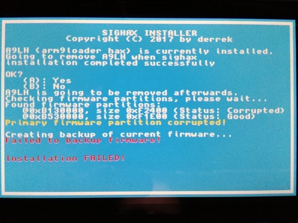

Doesn't work for me. Tried the upgrade on two systems (o3ds and 2ds). Both just say "Primary firmware partition corrupted" in yellow and then "Failed to backup firmware" in red.
