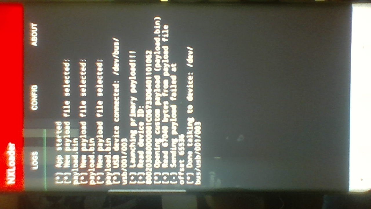

i tried to start the hbmenu with my phone (samsung galaxy note8) but it won't work.
the first time i tried i used a different phone (s7) and it worked, but now i can't use it for personal reasons.
It's a problem caused by the phone or by the switch? i can i solve this?
thanks, Alex
:!:*important*:!:
i just solved this problem by changing phone (i used a samsung galaxy note 4):switch:

So you took a picture of your phone with another phone and in the wrong orientation, yet the screenshot provides no useful information anyways :rofl2::rofl2::rofl2::rofl2:
nope, i used my laptop because i can only use it, i can't take a picture with a different phone.
That's why the orientation is wrong
