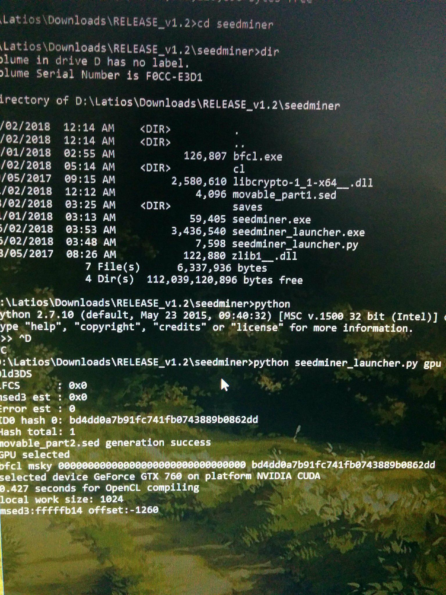

My bruteforcing step is taking a very long time on my GPU (nvidia GTX 760), over 12 hours and still going.
I suspect I may have made a mistake somewhere since my LFCS is showing null (0x0) rather than my actual friend code, along with other values being off; (ID0) doesn't match.
Any ideas where I may have gone wrong? Also, will the <friend code>_part1.sed still be valid if only the CFW 3DS adds me to their friend list?
Attached screenshot for context.

Thanks for creating this awesome technique @zoogie!
There is no lfcs in that msky command.
You will be brute-forcing until the heat death of the universe.
That's correct and that's where you messed up.
the next release will check for that error.
Resolved and thanks again @zoogie!
