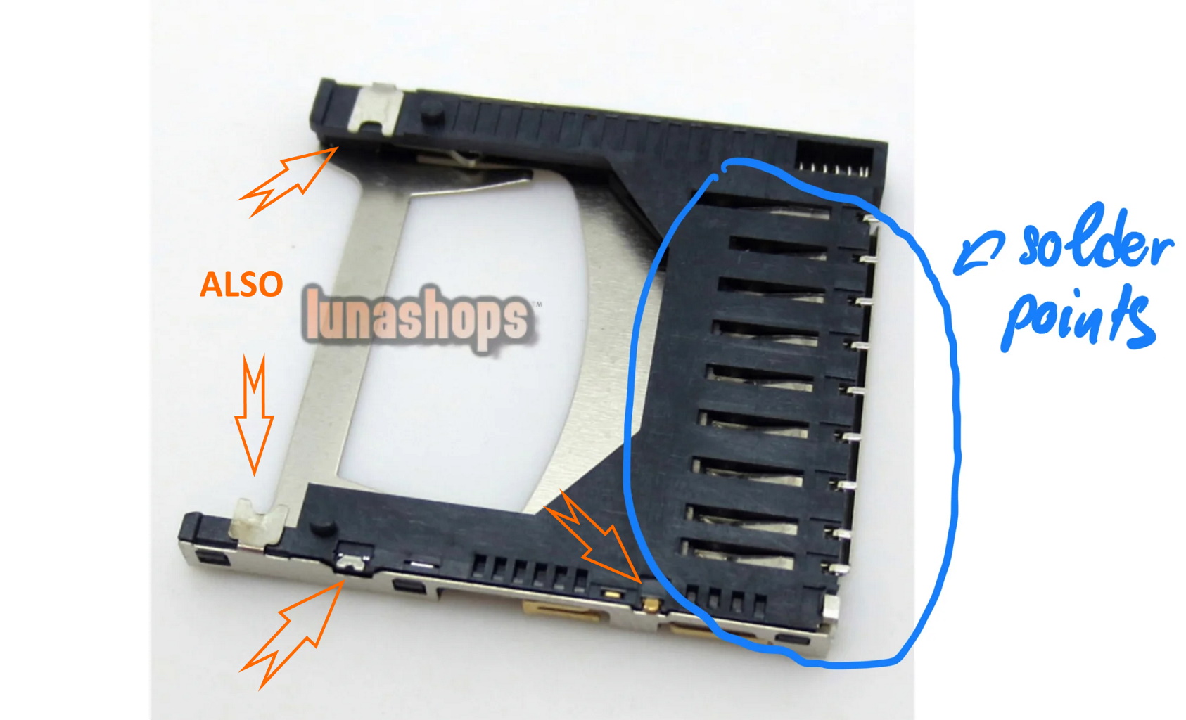

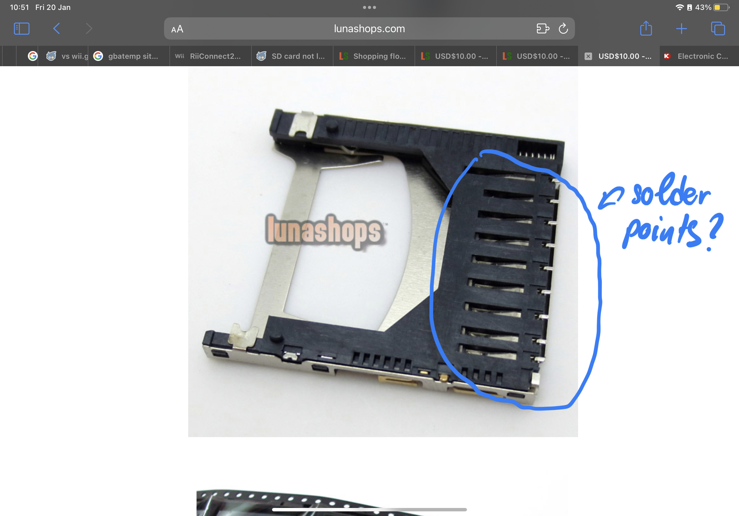

It does. At least 13 solder points.
Are these the solder points?
Yes, those are the solder points. Those and the metal grounding tabs at the corners in the front.
