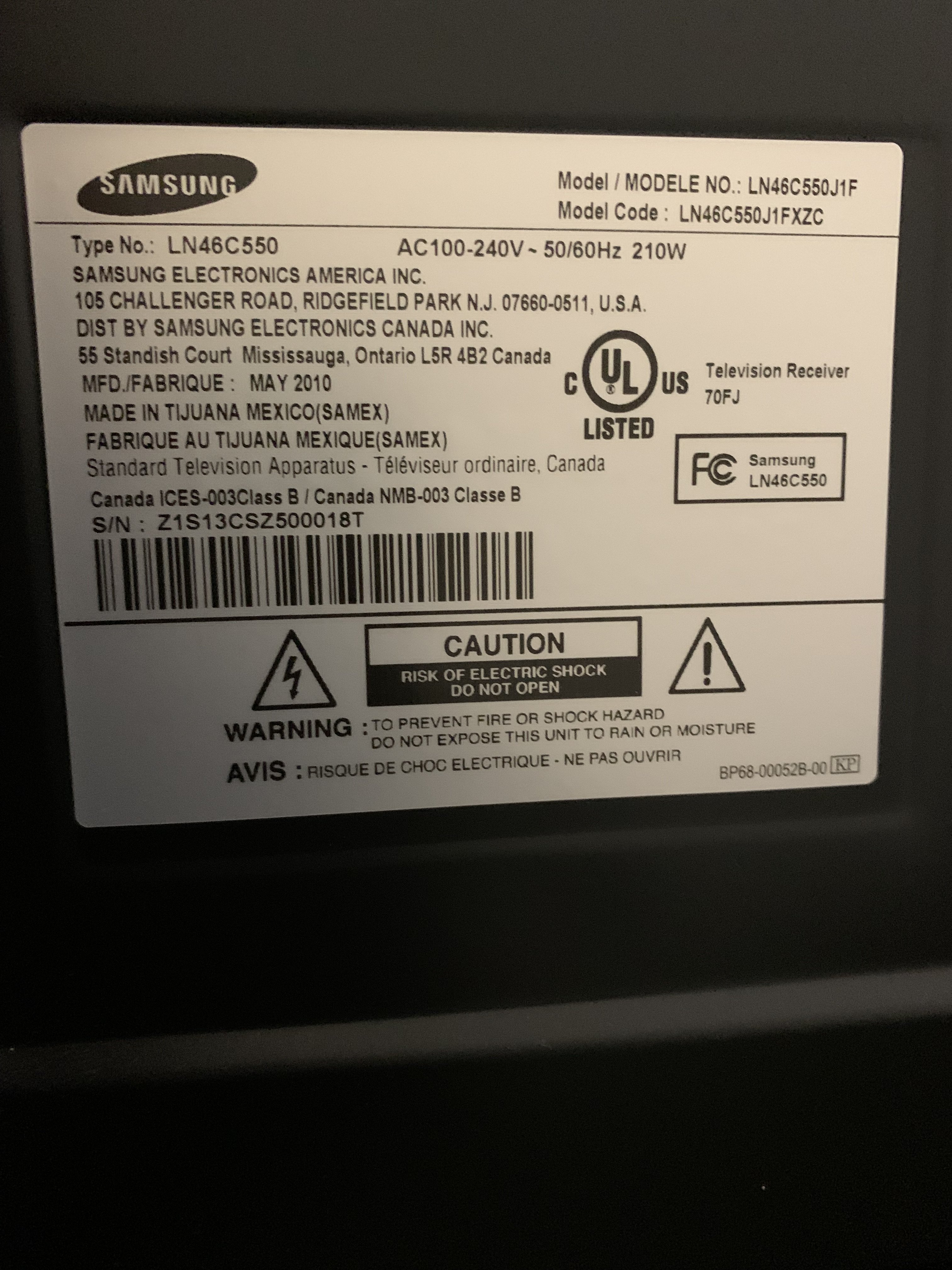

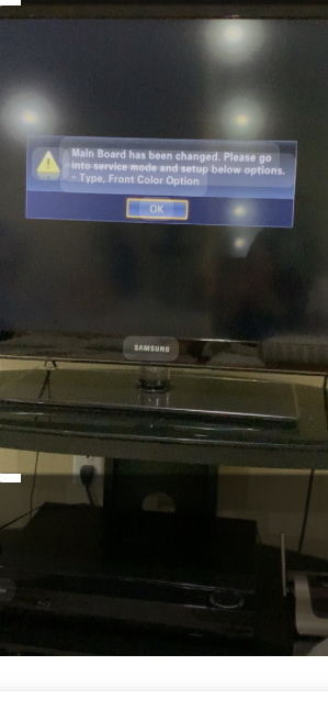

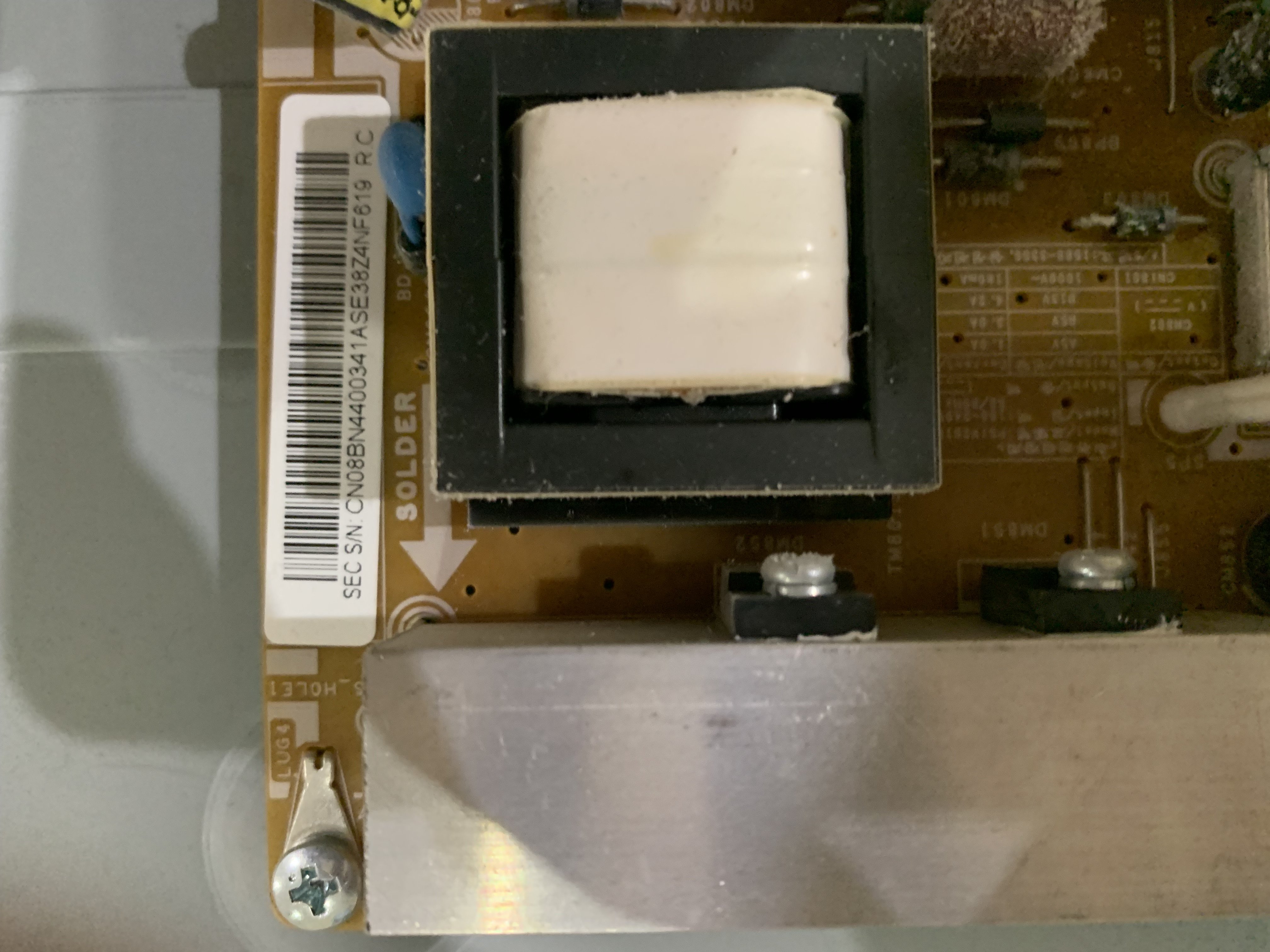

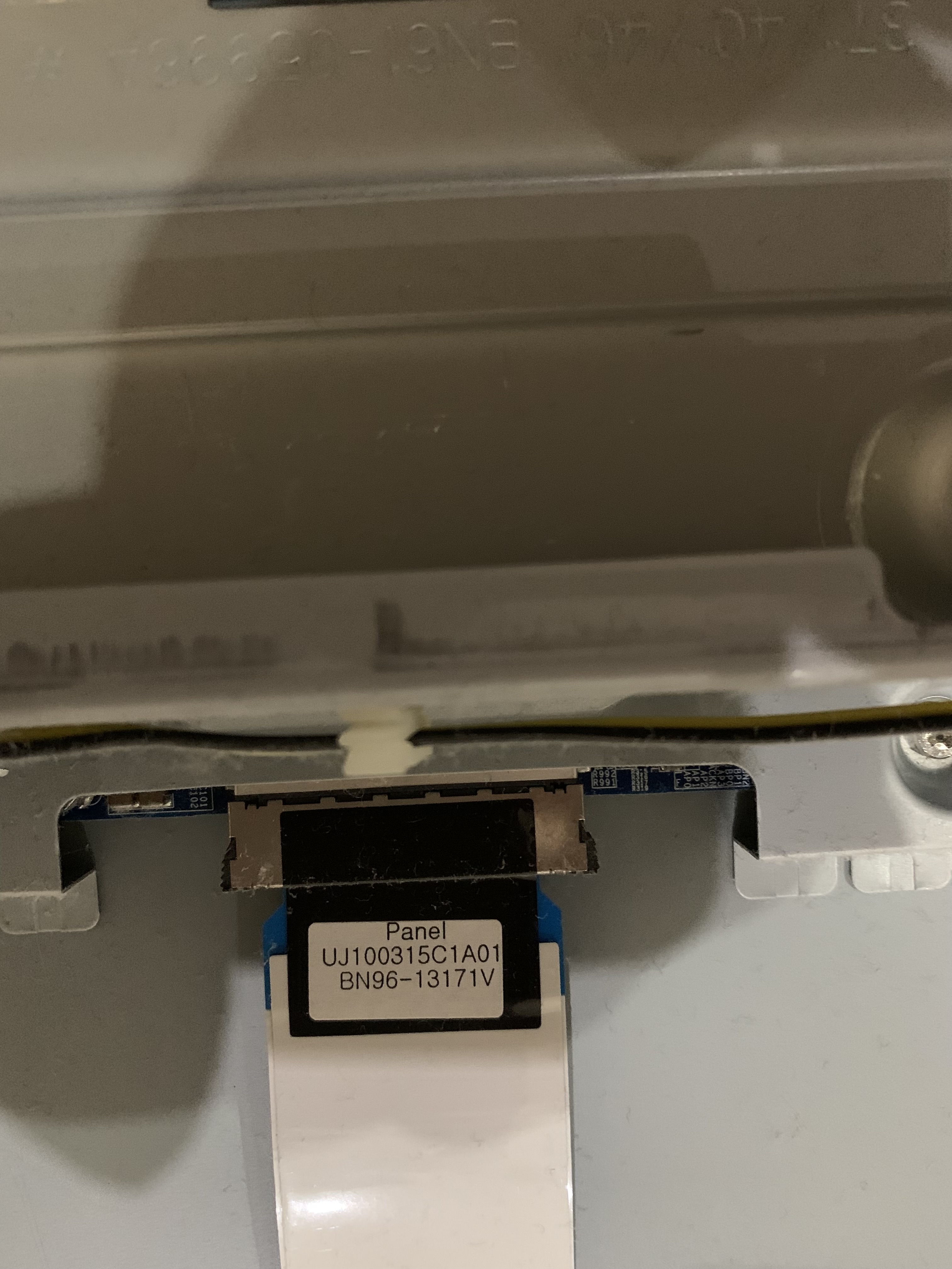

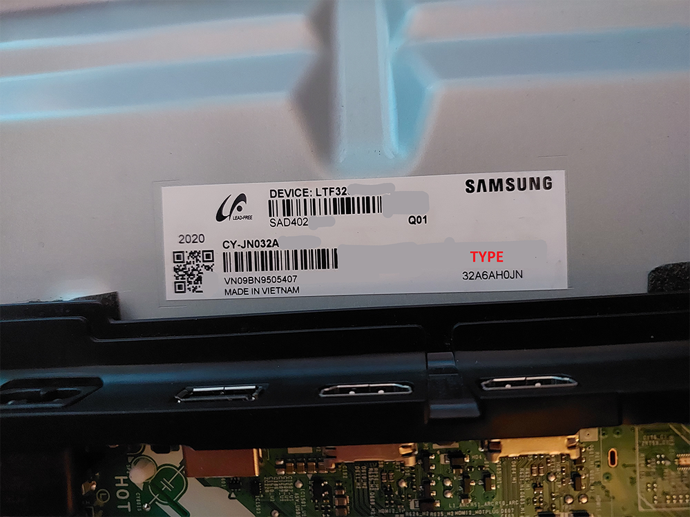

Hi, my tv model is ln46c550k1f. I did factory reset when the screen was inverted because there is no mrt option. I unplug it and after plugging back in the screen was back to normal but al hdmi is not working. There’s amessage when i turn on the tv. The main board hs been changed go to service mode and serup below option type, front color option. The fields of these two options are set to none. Can you please help me. Thanks!
soundslike your hdmi ports are in service mode (this mode is for repair and hdmi calibrating) and can only put in normal mode by an samsung repair
what does the message say? service mode or maintenance mode some newer models have an maintenance mode wich is like safe mode for windows
i
I attach the photo. I only need the right parameters in type and front color option. For some reason both type and front color option are none. There are so many option and it’s impossible for me to get the right combination.
Ah now im getting your Problem
You can find the type and Font on the back/inside the Panel
Reactions: Nephiel

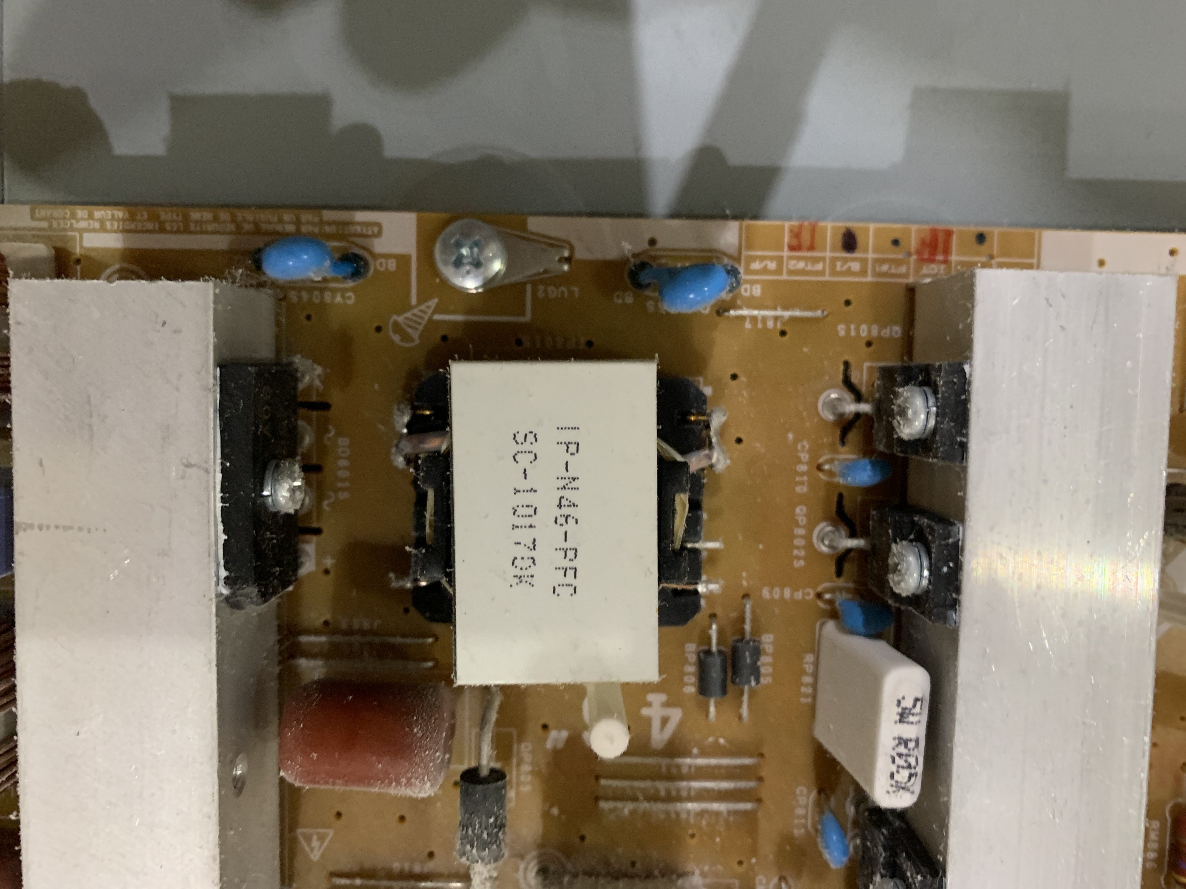

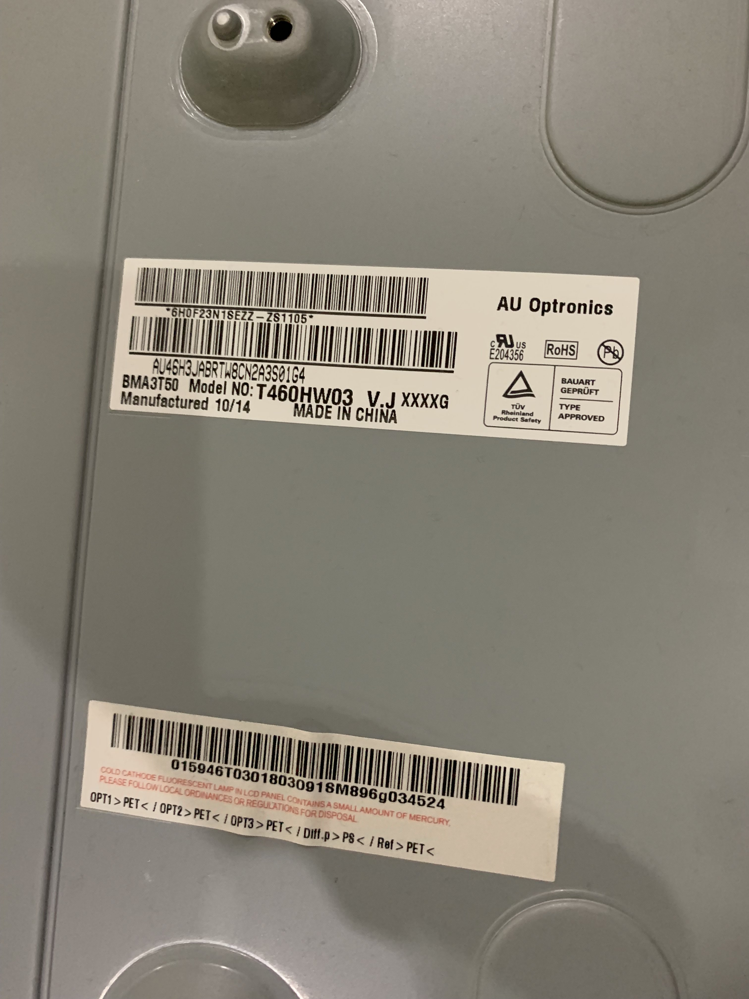

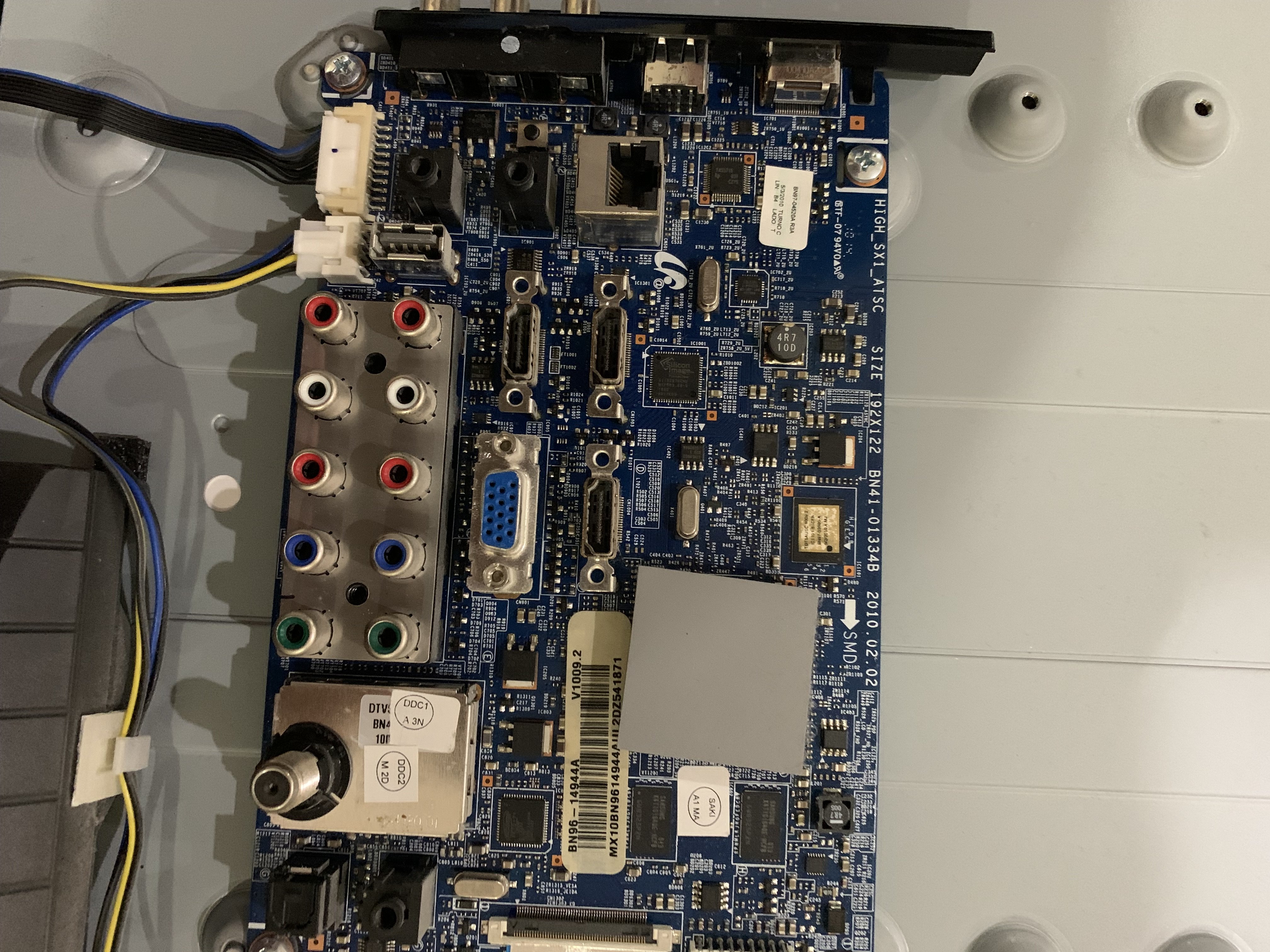

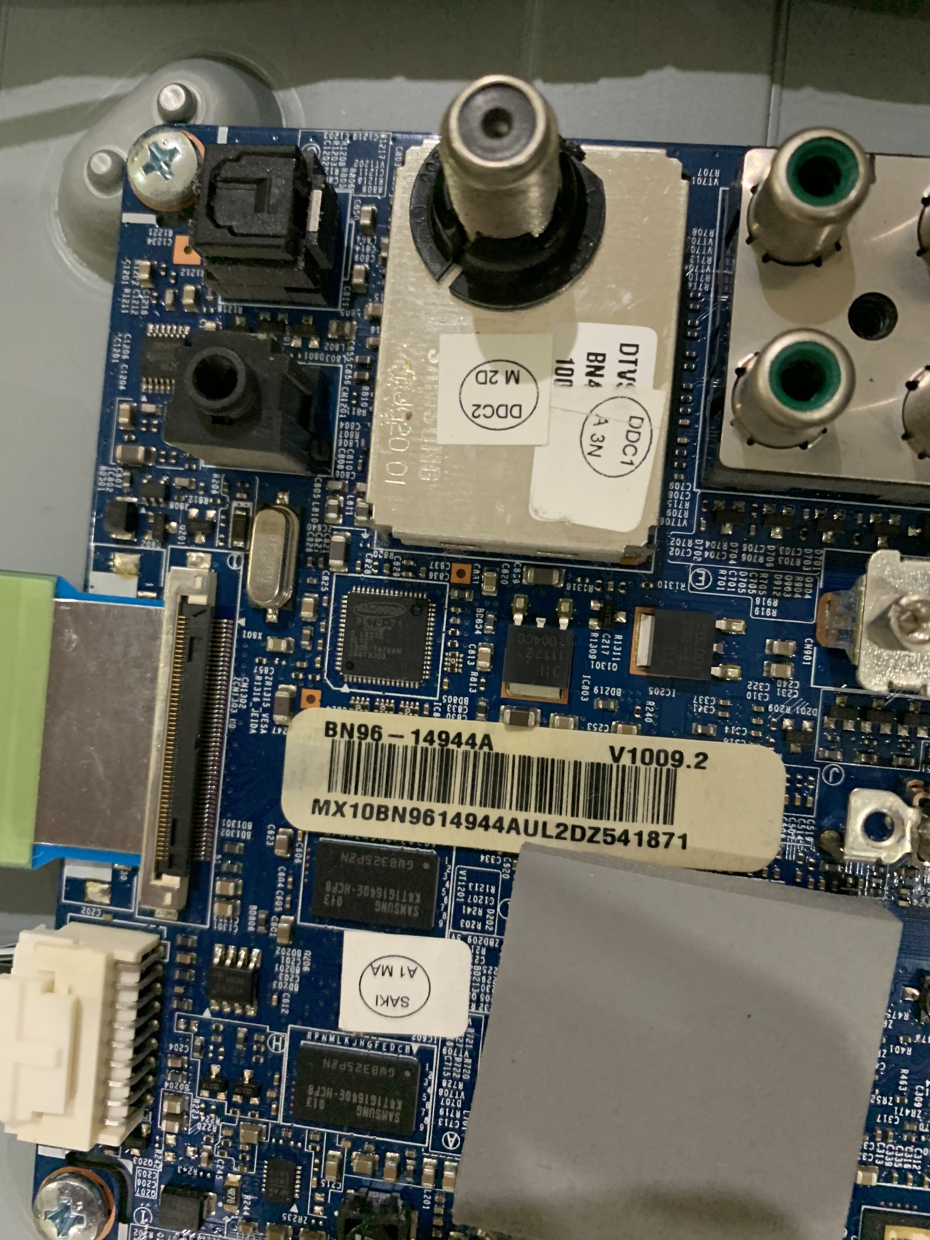

Yes, I did that but it’s not showing the type and front color. I open the back and took a picture of all the sticker. I will attach all the photo. Thank you for taking time to help me. You’re very kind. I really appreciate it.
