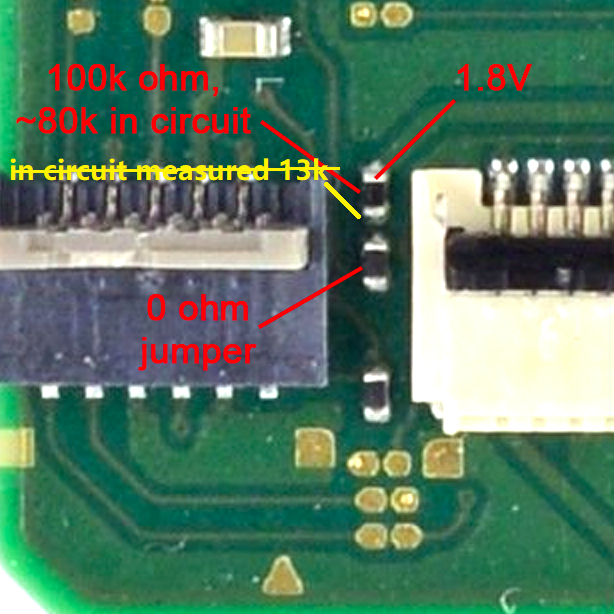

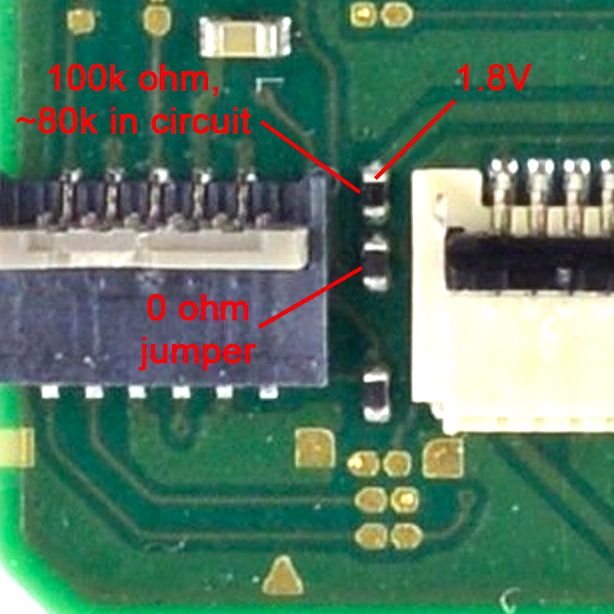

I have had this issue before (on the left joy-con); it was caused by a burnt resistor on the serial data (console -> joy-con) line. you might check this area and see if these values are okay. though, I have also seen posts on tronicsfixforum where the issue was on the CPU side, but ultimately did not cause any further issues, as the console is just assuming the joy-con is already connected and waiting to start communication.

Thanks for your interest, I checked and everything corresponds to your instructions, there is voltage and the values are correct.
what is your diode mode reading for that line? with red probe on ground and black on the 0 ohm resistor, I am measuring 0.480-0.500 across a few hac-cpu-20 boards.
Have a had-cpu-10 by hand having right joycon no detection issue,.
On that 100k ohm resistor circuit, the 1.8v didnt get pull down to 0v when joycon connected. I measured the 100k in circuit is around 13k( on a working board is around 60~80k ohm), this is pretty much a cpu side issue for me.
Just not sure if I permanently short this pin to ground would cause any further issue or not
pin5 requires a high to low level switch in order to initializing a handshake, permanently ground pin5(stays low) will not toggle next handshake so joycon will not recognize as handheld model.
