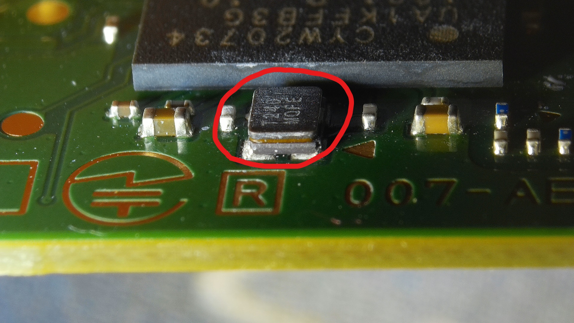

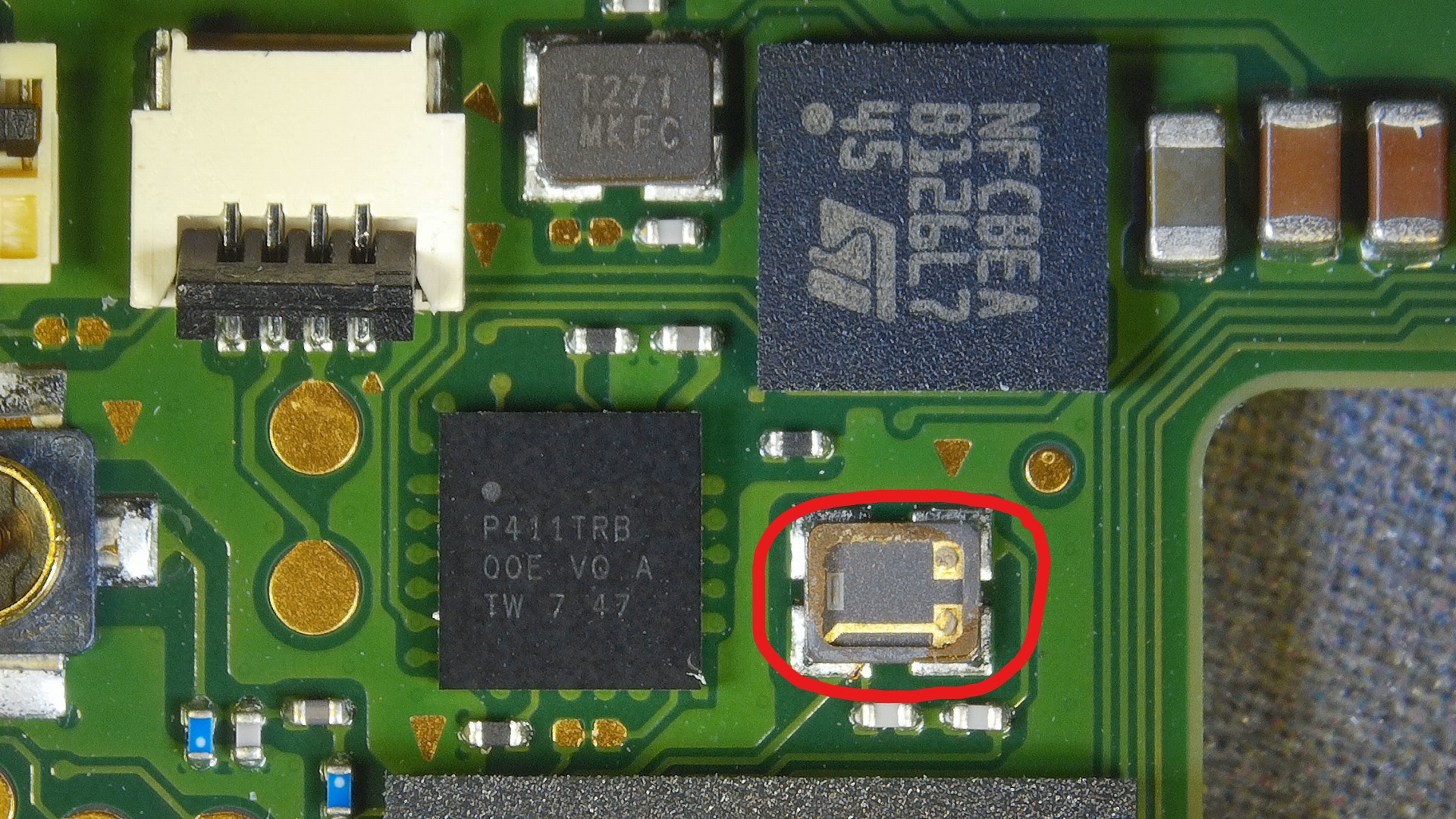

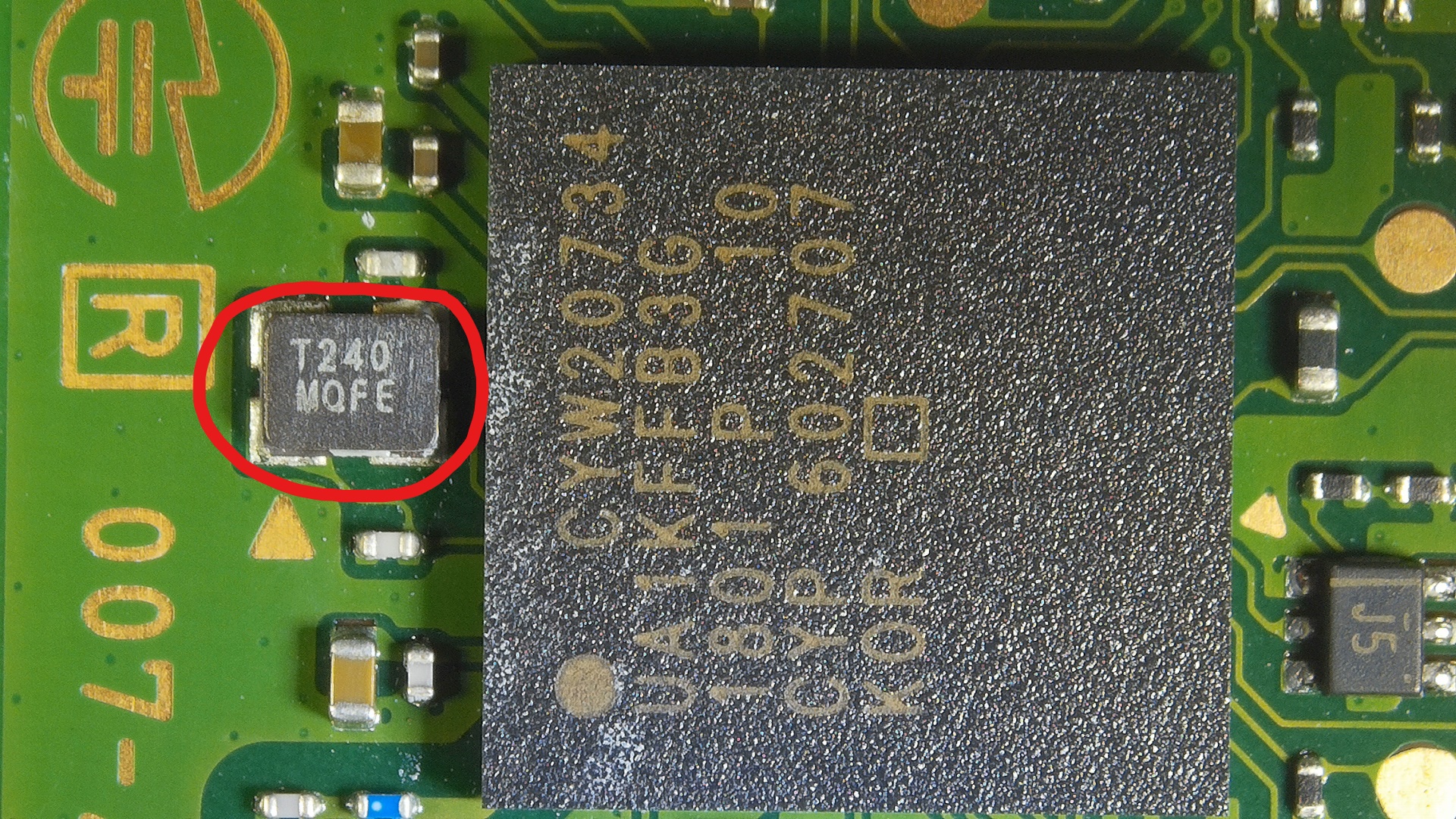

I found this guy right here, element "lid' was popped out, i found 2 more non working boards from my donors, looks like it's common situation.
It can lead to Joy-Con is not turning on or has bugs like mine.
May be some one knows what is that?
That is a24MHz crystal oscillator. You can search for T240 oscillator in google.
