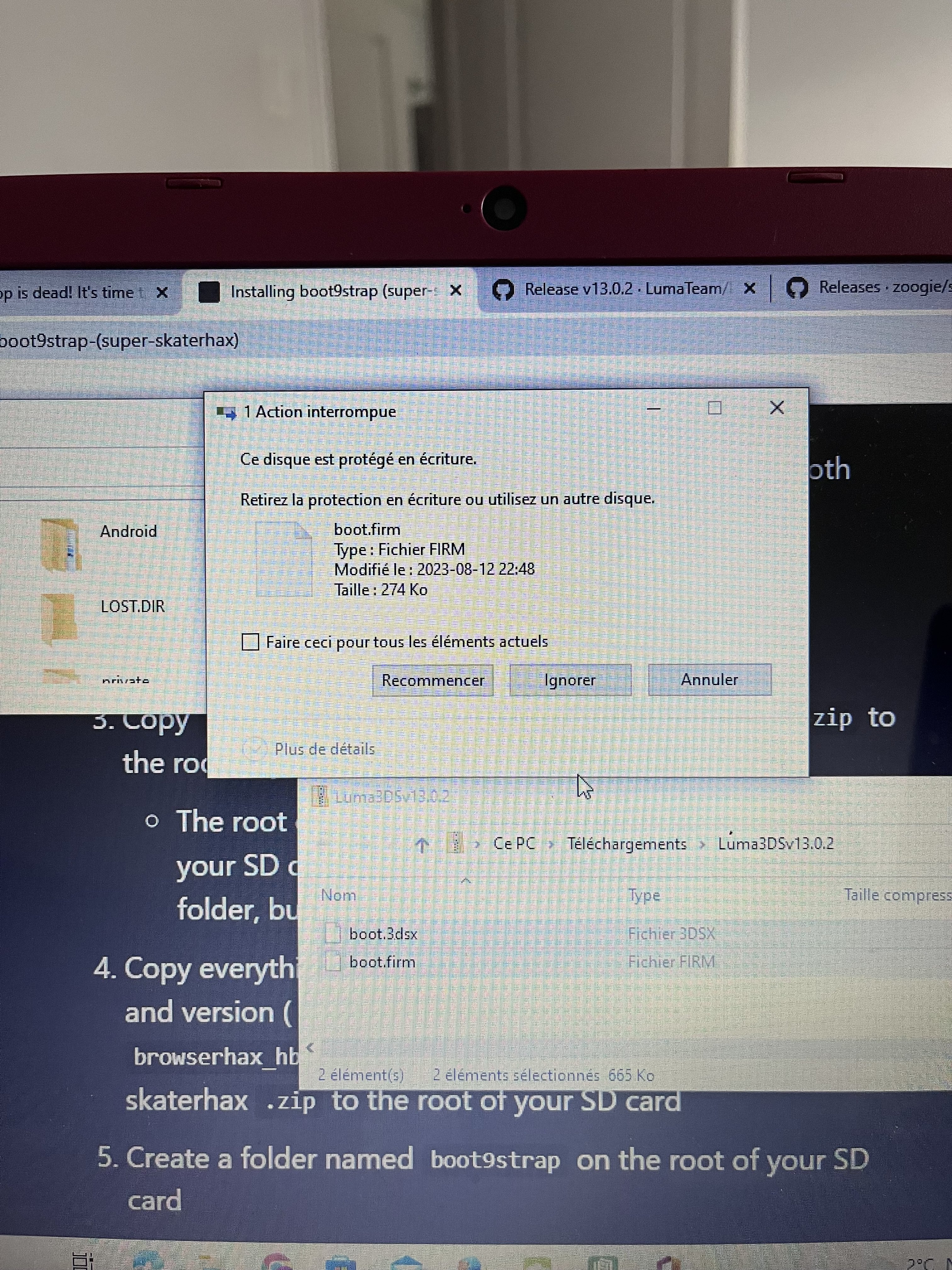

You didn't respond to specific questions I had about this. Anyways, I'm having issues copying the boot.firm and the boot.3dsx from the Luma3DS folder ( mind you this is one of the steps to mod your 3ds https://3ds.guide/) This is what its showing :
It’s basically saying that this disk is write-protected and to remove the protection in written or use another disc (translated). The check box below says ”Do this for all current elements “. How do I turn the protection feature off so that I can copy the files?
