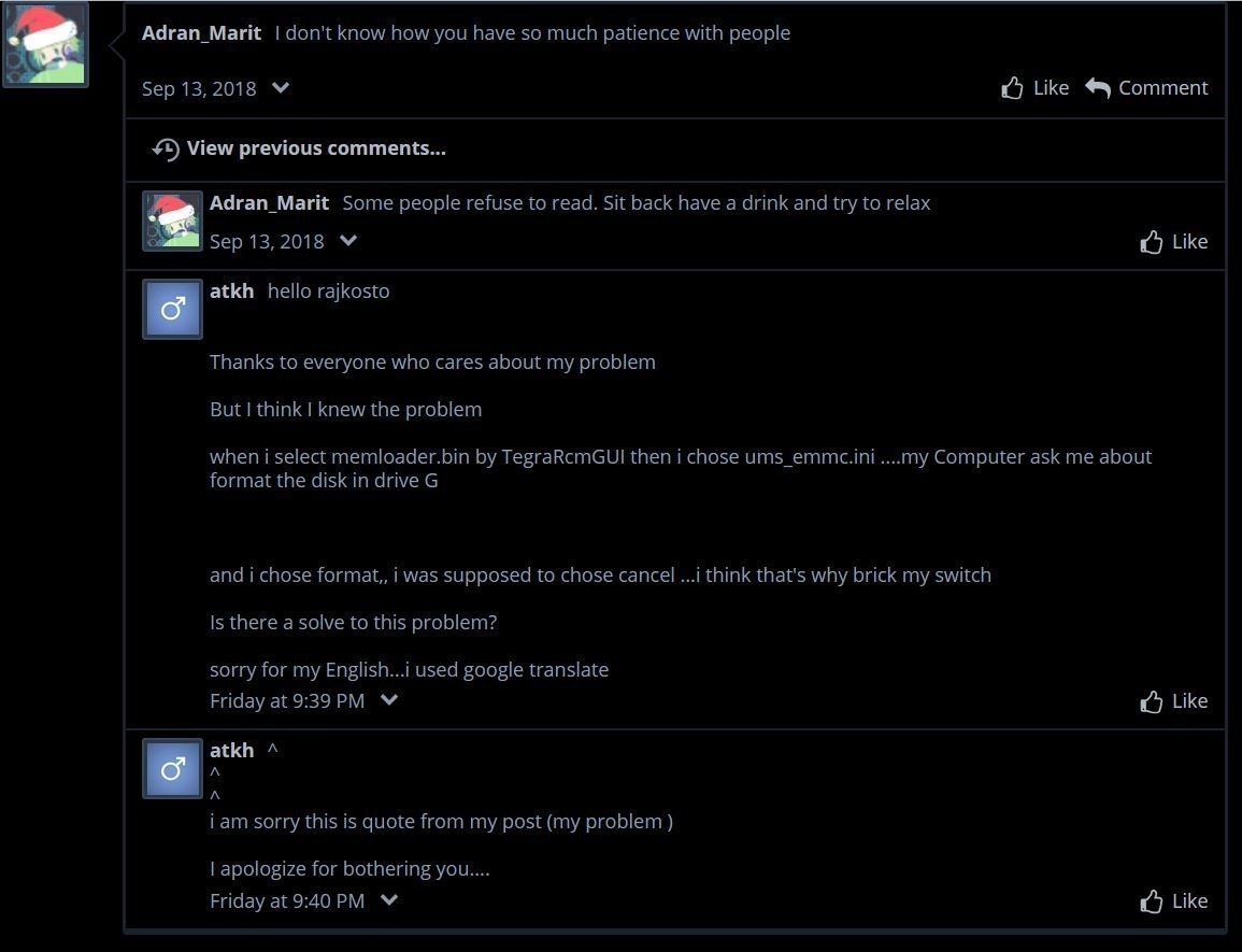

thank you for your care... i don't have a backup (this is my mistake i konw ><")
I want to know if there is a chance to fix it ?
as i say "my computer ask me to format the disk in drive G " and i choose format i don't konw if it was full format or quick format ....can i know if there is a way to check (full format or quick)?

I noticed my switch has unallocated 515.98 ...is this normal? or this is The problem that caused (brick ) ?
Maybe you do not know ...i had post in section Switch - Exploits, Custom Firmwares & Soft Mods
this is quote from it
I apologize for bothering you again....

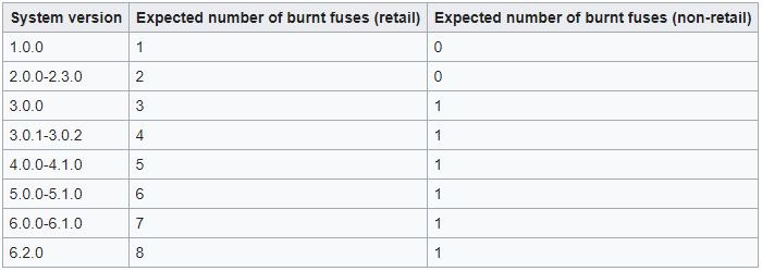

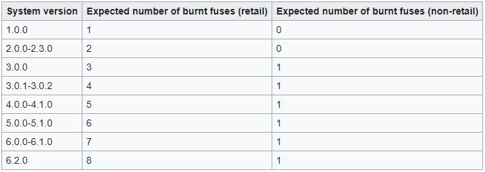

Command is fine..
Use system files, for the system version that match your fuse count..
Use briccmii payload to get your fuse count...
^^^^^^^^^^ Here were it says system version is the system (fw) files you need to download.

Command is fine..
