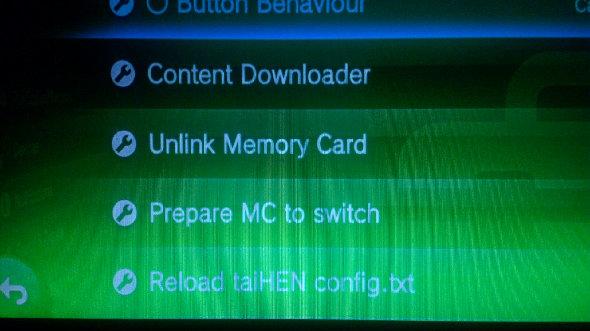

Suprx* version:
1) Do the steps on vita:
place swmc.suprx in ur0:tai/, edit config.txt and replace henkaku.suprx line with swmc ONLY under NPXS10015/10016, rename id.dat to idv.dat
2) Power off the vita, place the MC in psTV, the db will refresh.
3) Do the steps on psTV:
place swmc.suprx in ur0:tai/, edit config.txt and replace henkaku.suprx line with swmc ONLY under NPXS10015/10016, refresh Tai config via settings.
You should have a new option in henkaku settings called "Prepare MC to switch" - Click it and it will rename :
If psTV - id.dat to idtv.dat and idv.dat to id.dat
If Vita - id.dat to idv.dat and idtv.dat to id.dat
And will display a "Success" message - now you can power off and place MC in the other console
Also you may just use the heavier swmcl.self from UPDATE2 in OP if you dont want to use the suprx/self method
