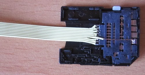

and this here is a raspi setup I found:
http://flashkarte.blogspot.com/2014/02/unbrick-eines-3dsxl-die-durch-eine-3ds.html
he is using it via SD card adapter. how to do this on a raspi 2? same as above only the adapter Dr.Crygor 07 posted?!
I have never heard about this method. If you absolutely want to do it like that (from what I understand it does not need a NAND dump), yes that's the solution. But if you have a NAND dump, you're better off doing it like I said.
