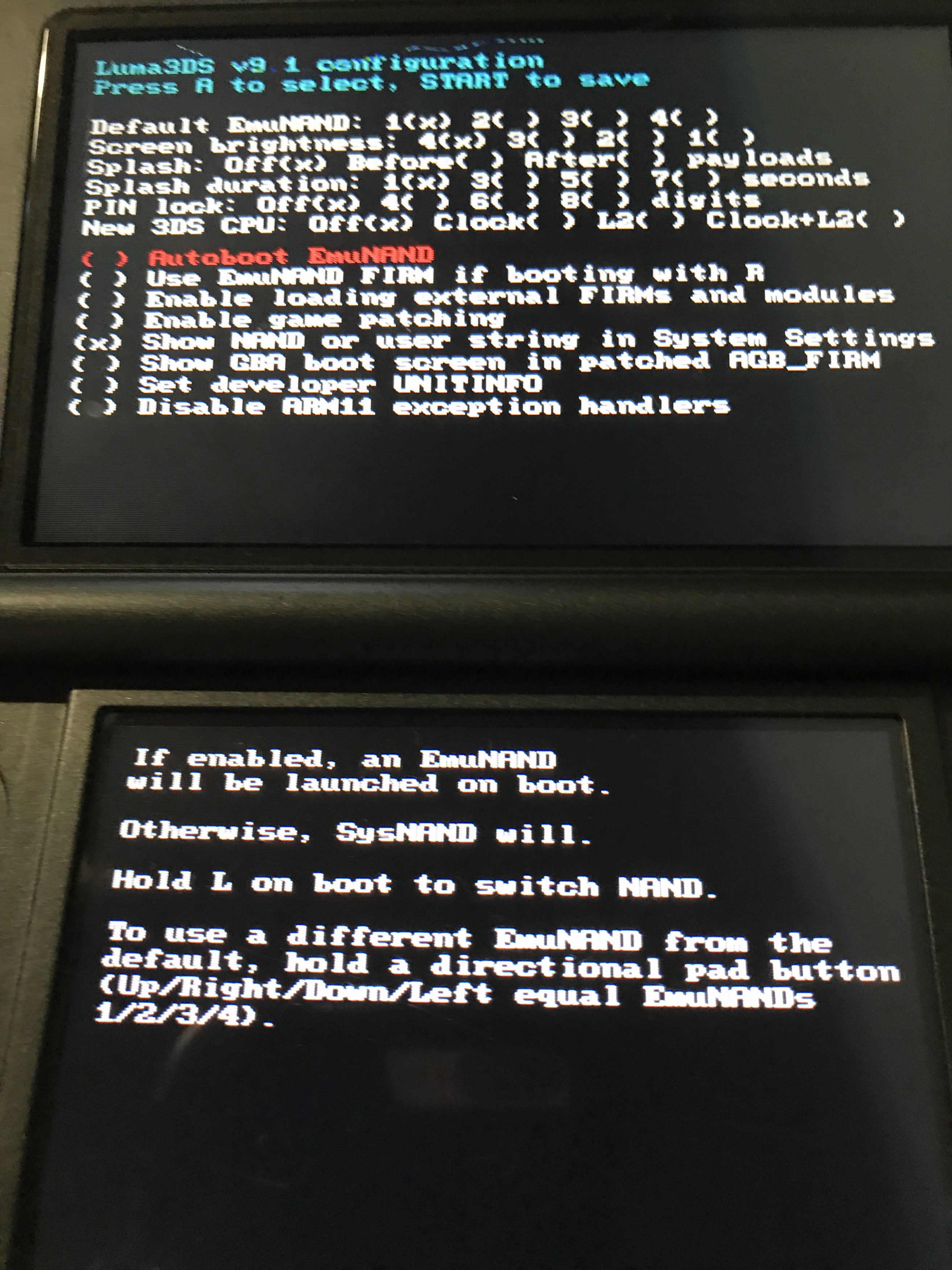

I see boot.firm, which leads me to believe you have boot9strap and Luma3DS.
Do me a favor and turn off your console. Now turn it back on while holding SELECT. Does anything appear on screen?

All you really need is boot.3dsx from https://github.com/fincs/new-hbmenu/releases/latest . Then you can follow https://3ds.hacks.guide/finalizing-setup .
Also I don’t know if this matters but I deleted the steelminer app from my 3ds
It doesn't matter.
There is a blue light but the screens are all black?
As you were told in the other thread you started, that means your 3DS was unable to read your SD card. (Specifically, it wasn't able to find boot.firm.) It could mean that your SD card wasn't inserted properly – or it could mean your SD card is starting to fail. You should probably make a backup.
