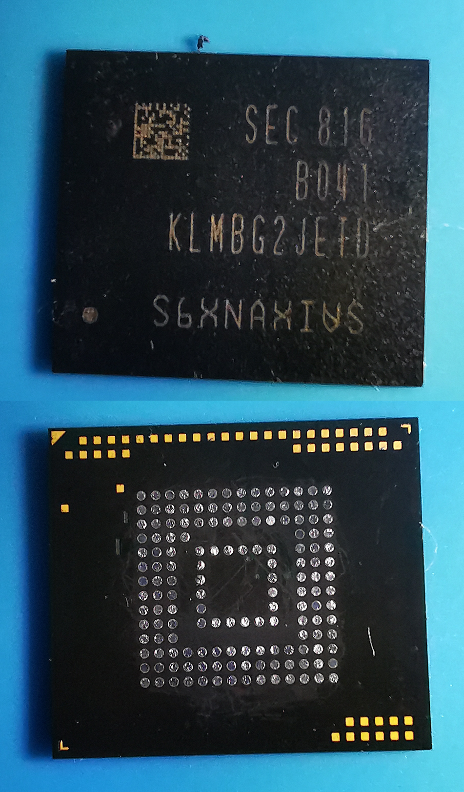

Hello everyone!

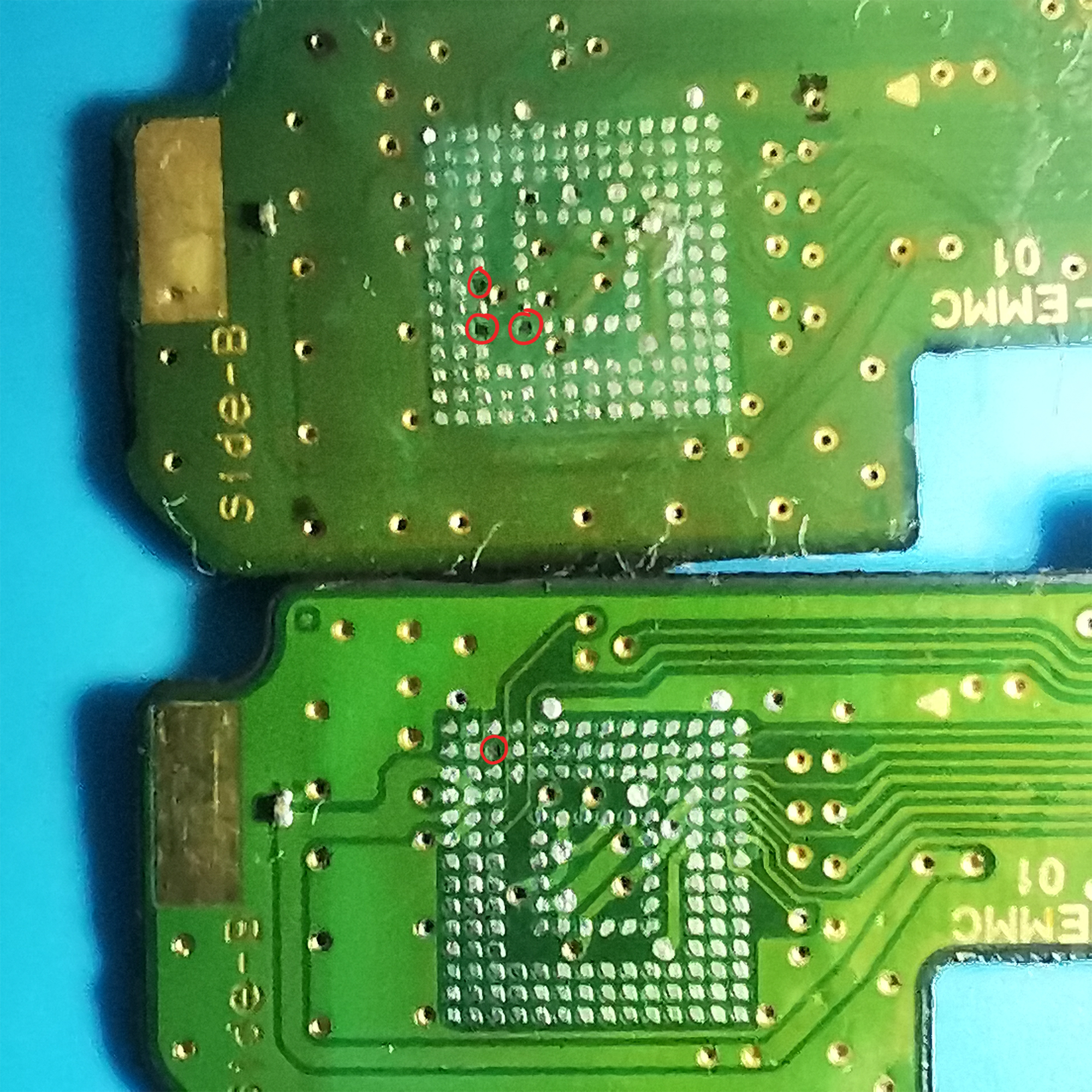

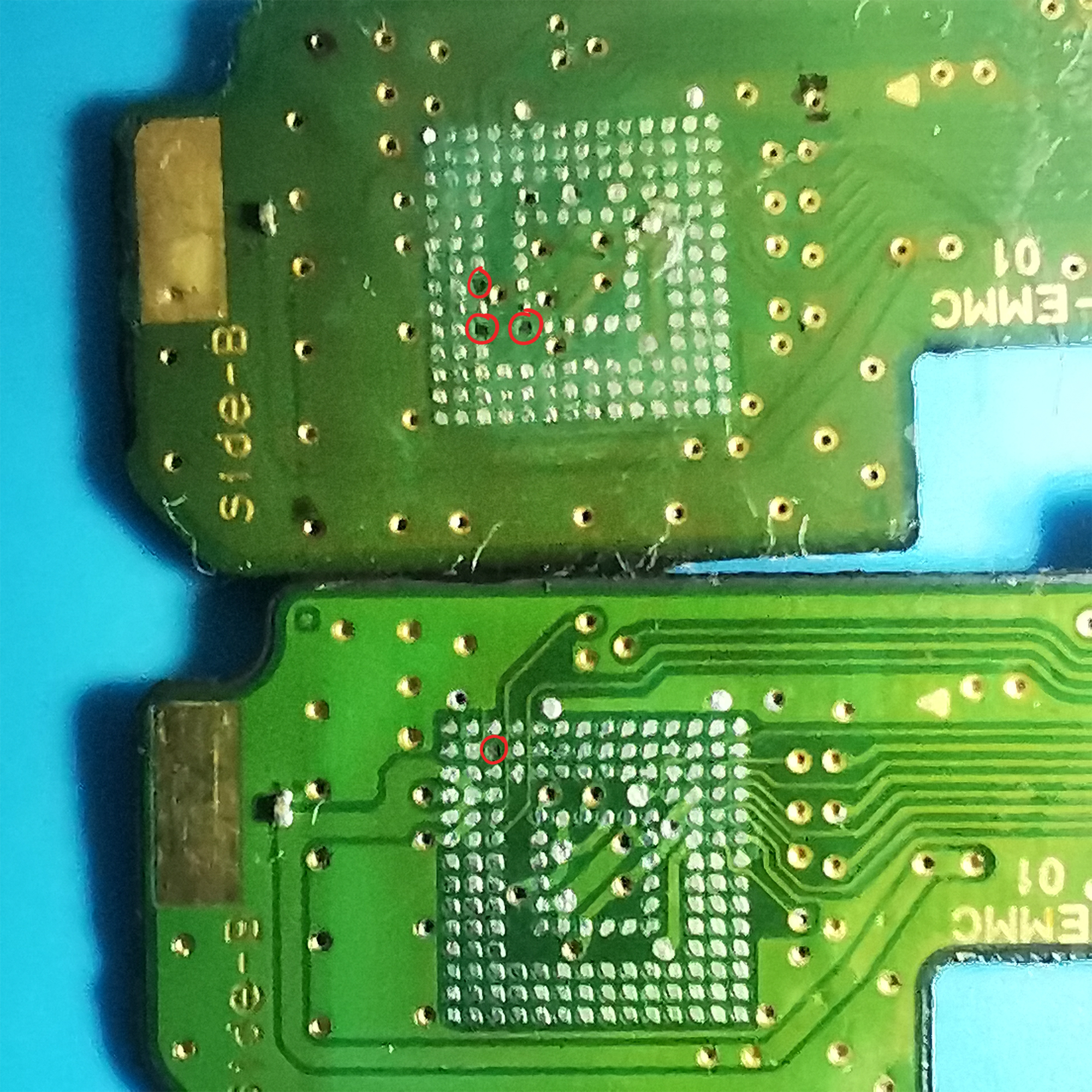

guys i have 2 nintendos switches, one functional but that was unable to read the nand.
the other one that had the nand intact but it doesn't turn on.

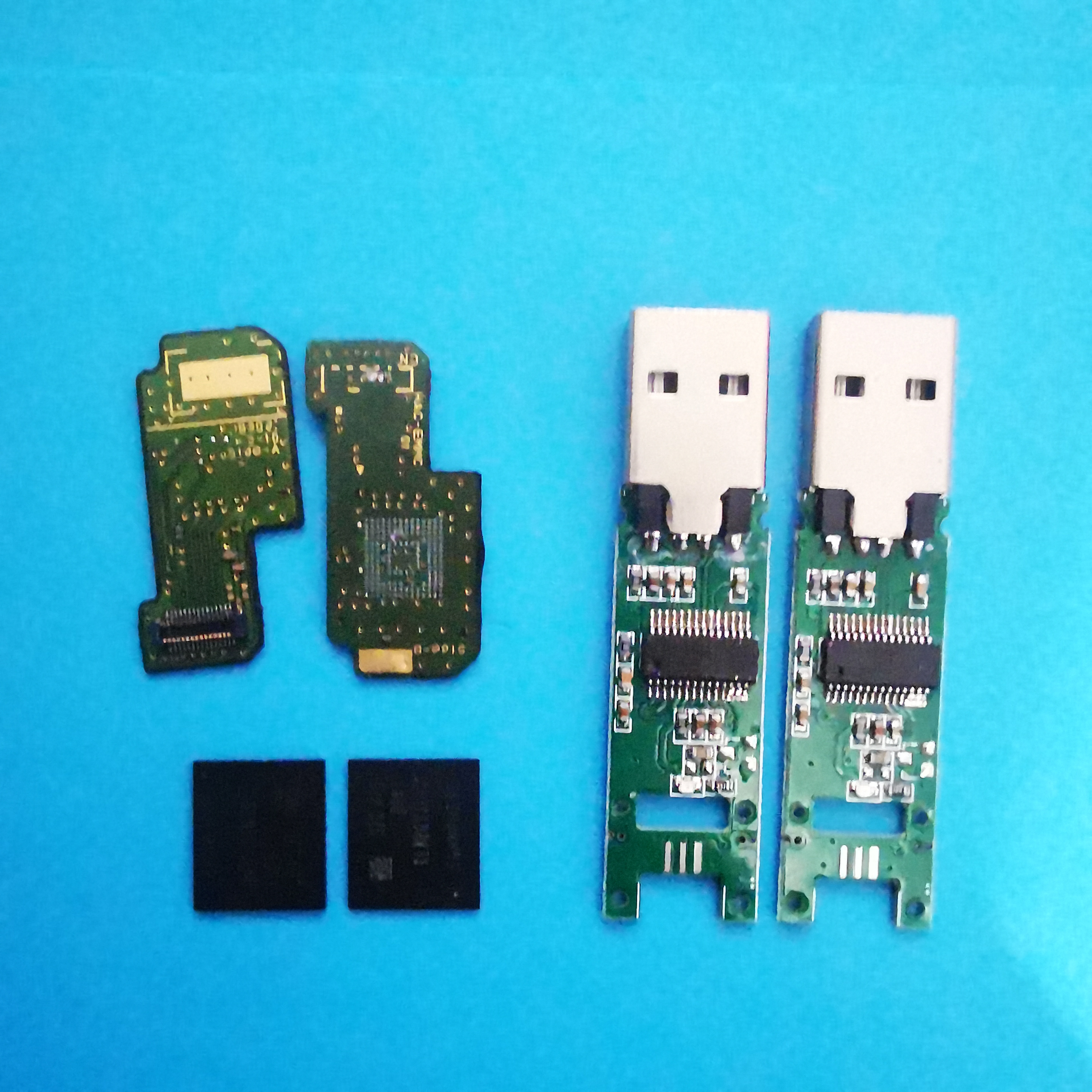

I've had these consoles for about 3 years, at the time I didn't have much experience in soldering and damaging the boards trying to replace the emmc chips from one to the other.
I didn't try to do a new reballing because the boards lost some pads. I believe it would work without these stray pads, but I haven't tried it yet.
above is the photo of the damaged boards.

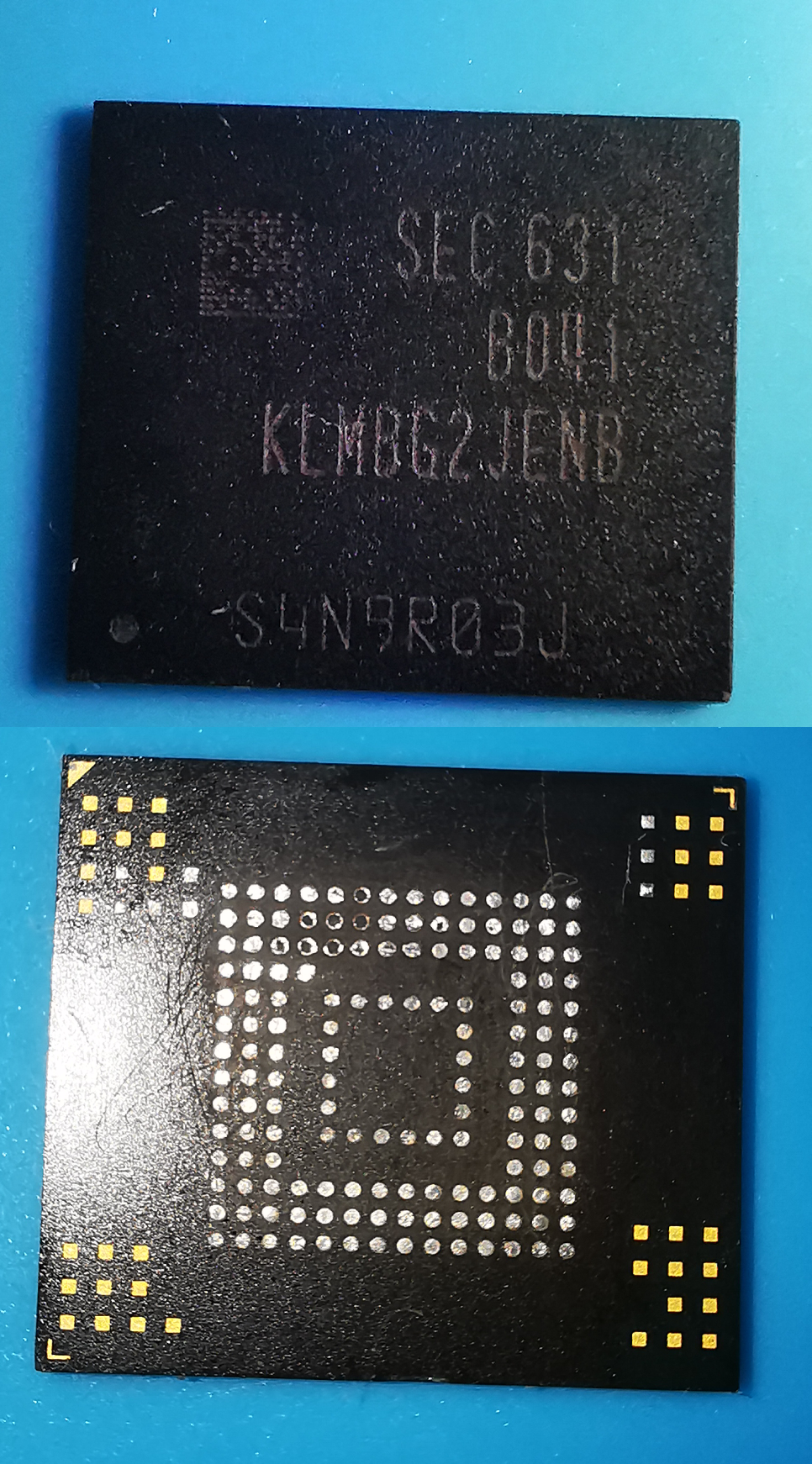

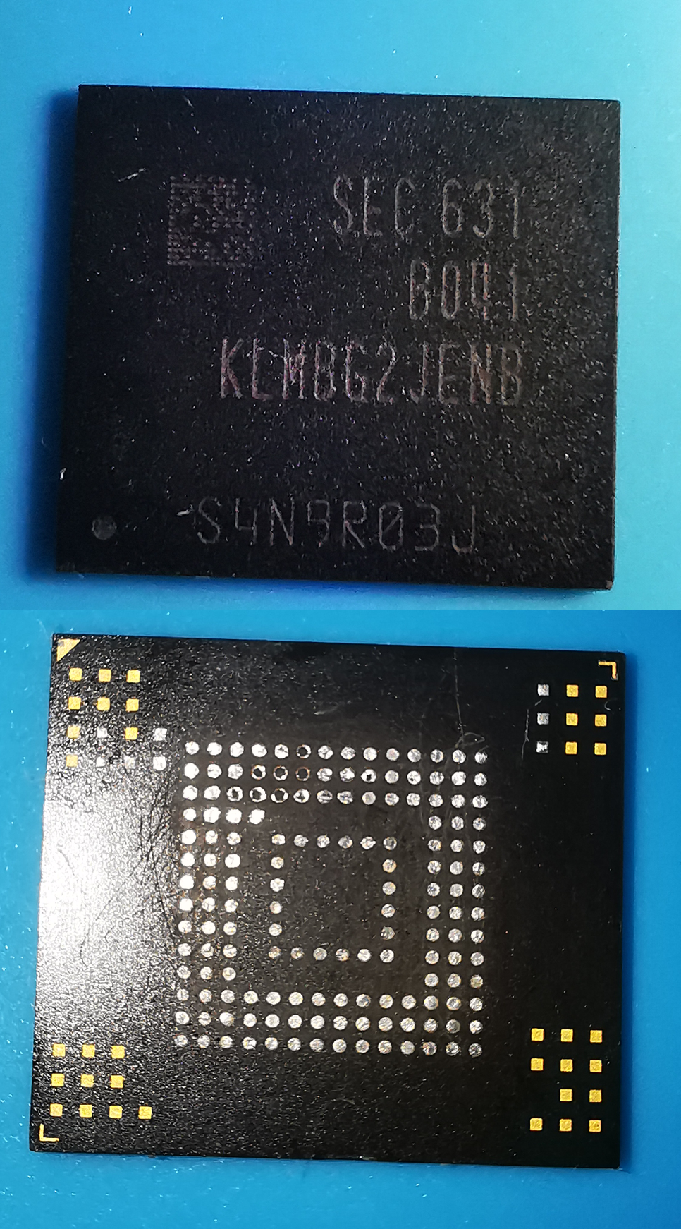

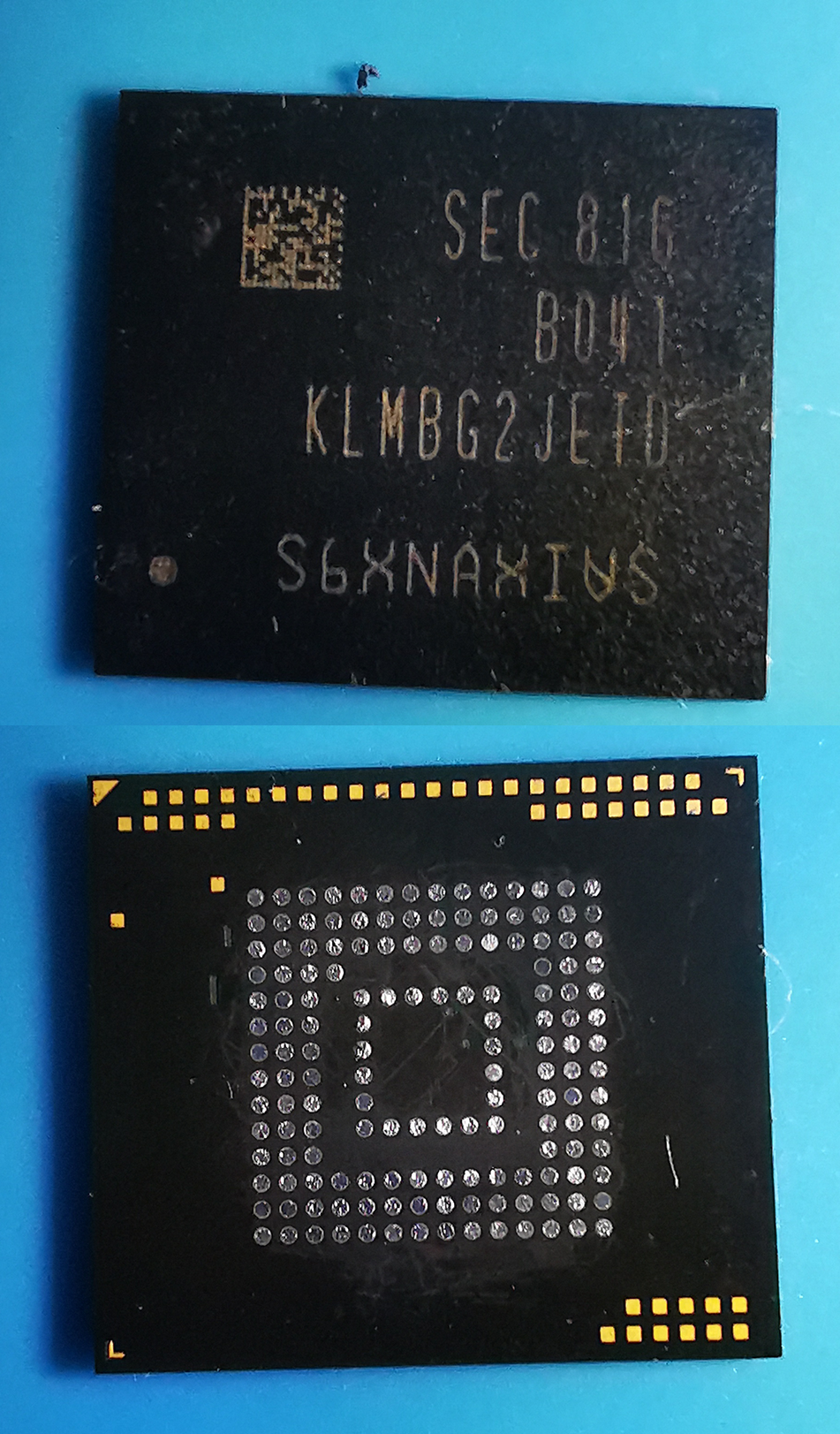

above are the pictures of EMMC chips.
I already bought two new 32gb nands to follow the tutorial and try to restore these two switches
This tutorial: https://gbatemp.net/threads/switch-unbricking-guide-for-dead-or-replaced-emmc-consoles.609891/
But I believe that the chips are in perfect condition and it would be possible to remove the data and inject it into the new chips I bought from China.

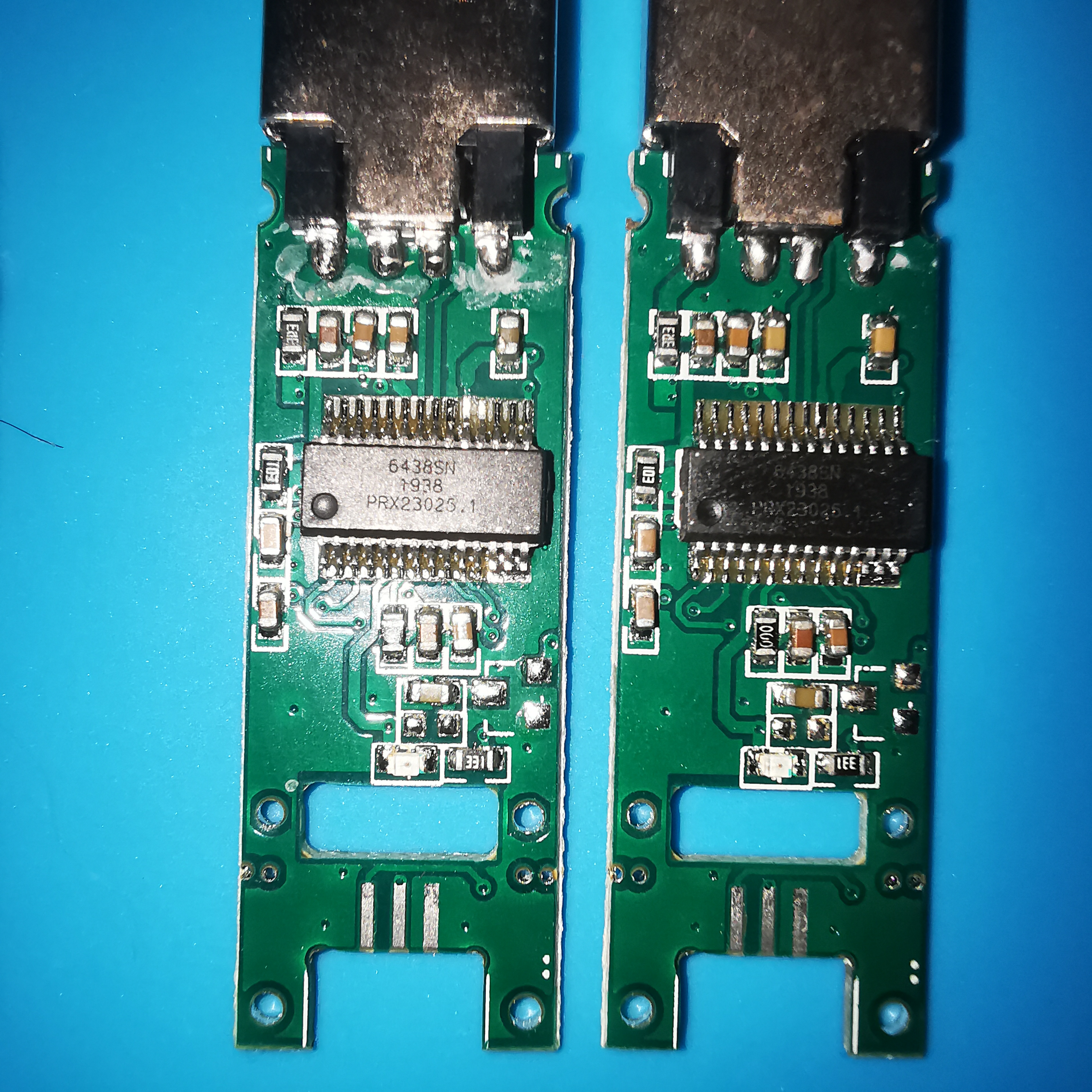

Hello everyone!
View attachment 346893 View attachment 346894
unfortunately I don't have a good emmc reader, like Medusa Pro 2 or UEFI box, they have a very high price and I don't know anyone who has one of those devices so they can read the chips for me.

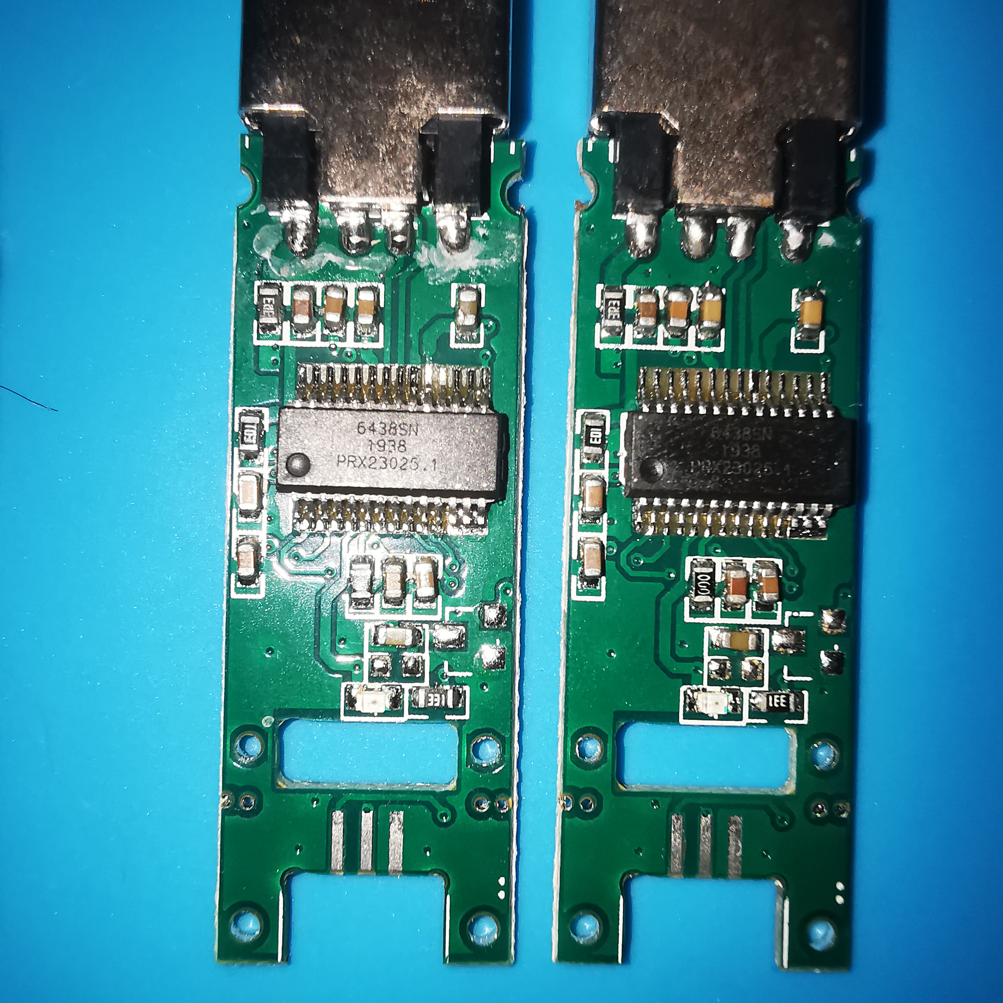

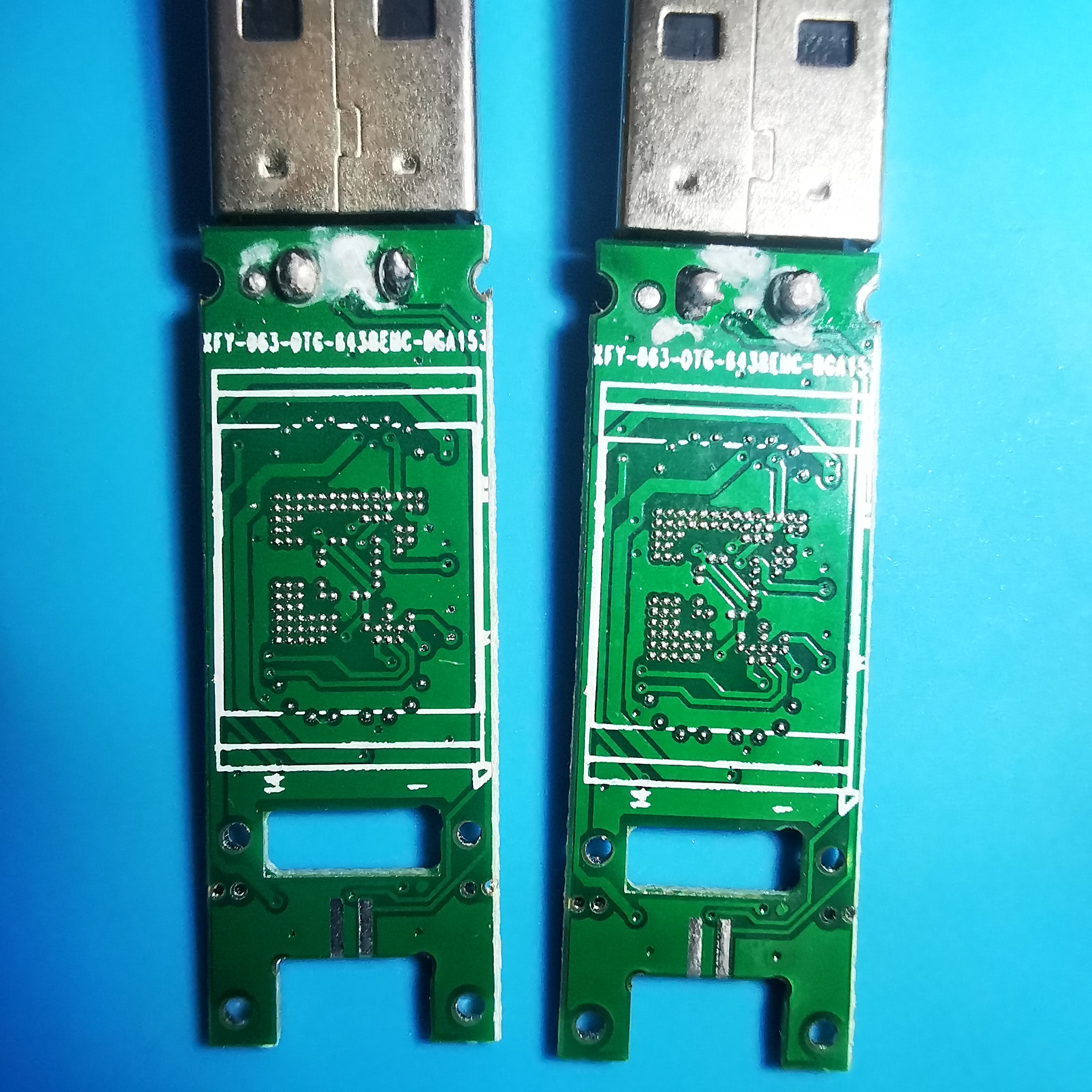

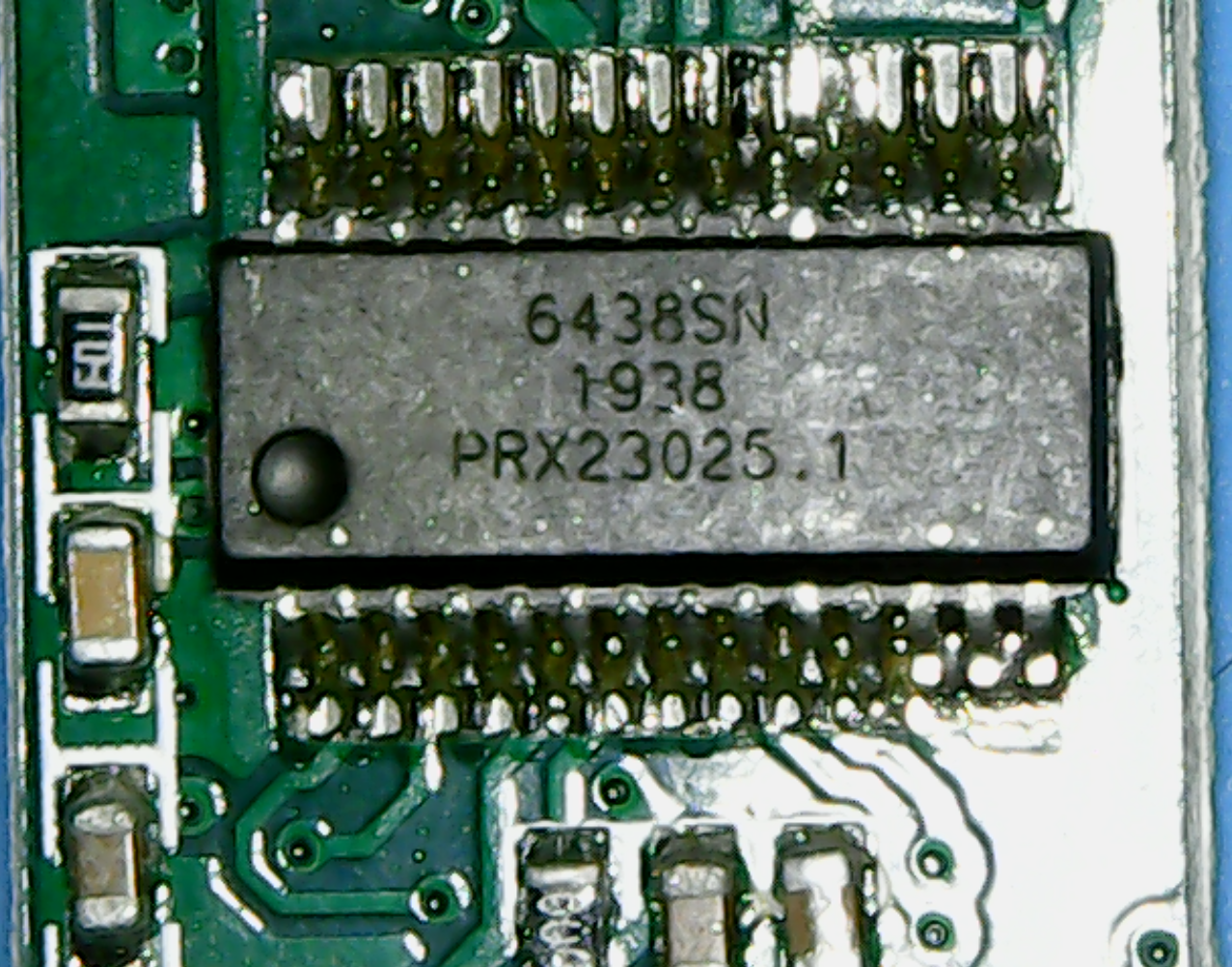

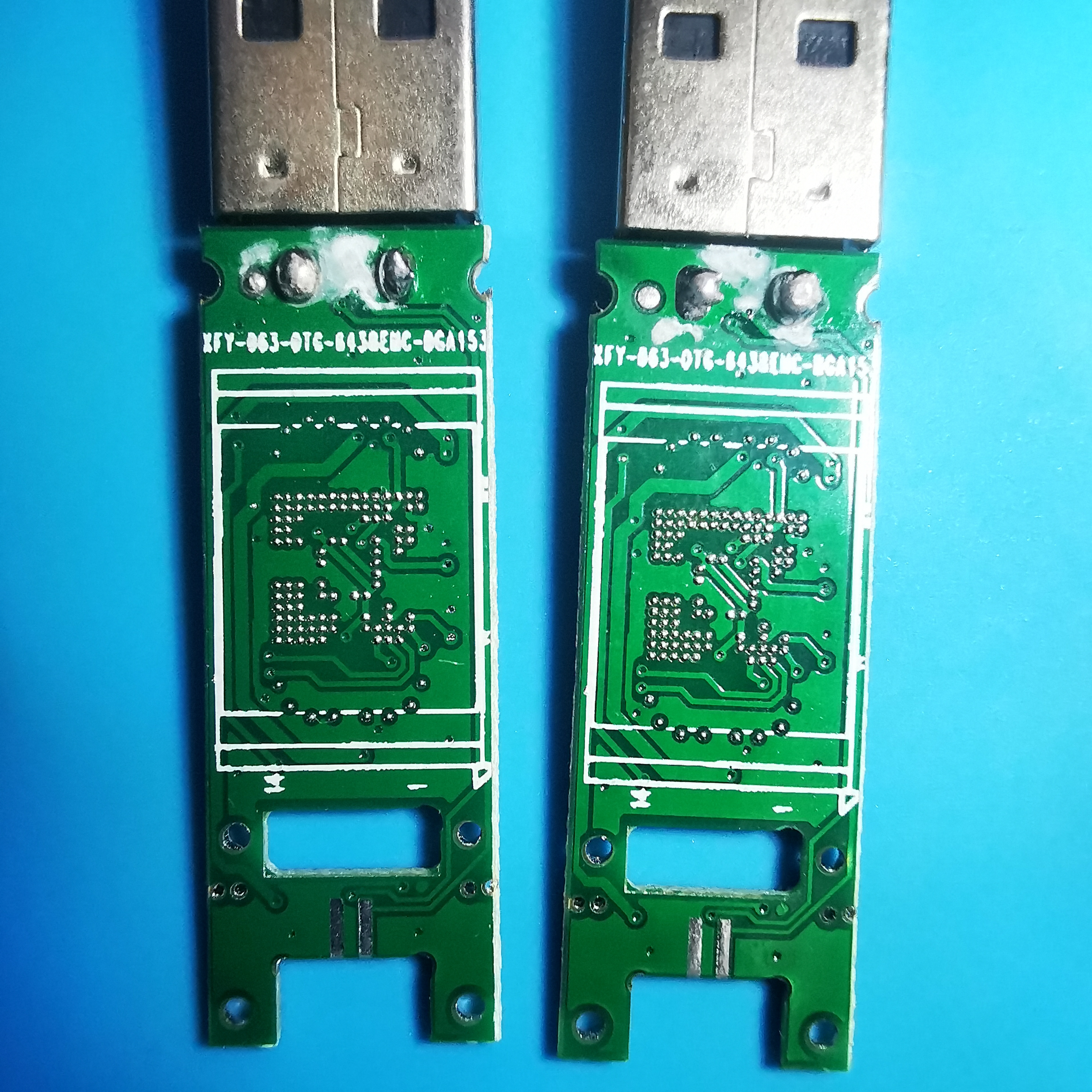

while surfing through aliexpress i found some adapters for EMMC BGA 153 and 159
I got in touch with the seller and he said he could make me a version compatible with my chips, but I wouldn't have access to the data because of the encryption (which wouldn't be a problem because I wanted the RAW data).
so I bought the adapters, but I confess to being afraid to use them, so I came to you to ask for an opinion on how to proceed from now on.
Follow the photos of the adapters purchased.
View attachment 346897View attachment 346898View attachment 346899
well, so I humbly come here to ask you for an opinion on how to proceed from now on to successfully recover these two Nintendo Switches.

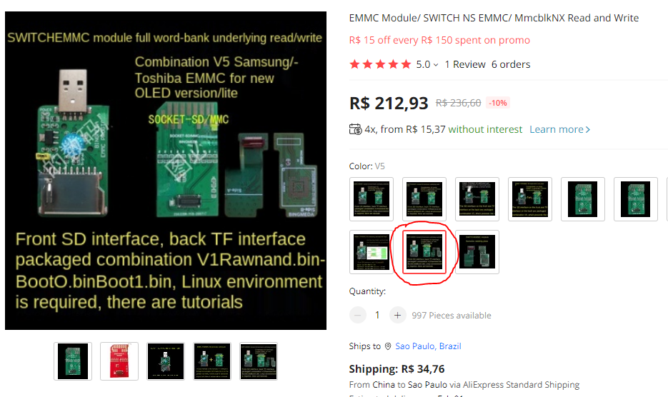

I even found this one on aliexpress (I don't know if it would work the same)
Clamshell sd emmc
I don't know if the size much less the voltage is correct.
the right would be 1.8v?
Not much information on the page.
Clamshell sd emmc

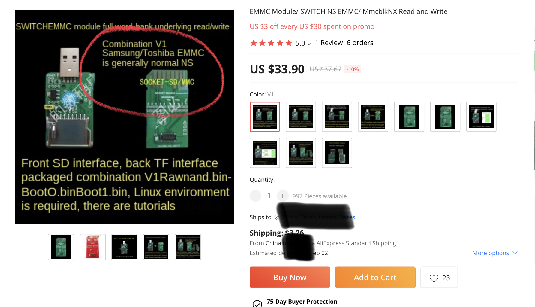

These are high shipping?
https://aliexpress.us/item/3256803361643934.html
BTW, if you have a V1 Erista you can mount the eMMC the Switch itself.
Reactions: ThiagoDaruma

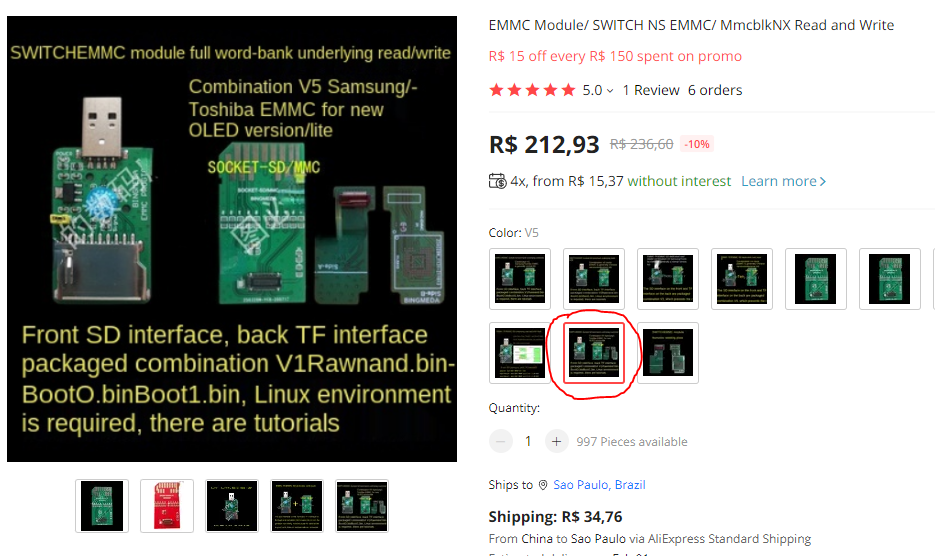

Would this be the right one to buy? "V5"
It's a fairly expensive purchase as I'm not sure the EMMC chips are working.
maybe you buy it and it doesn't work. Hehehe
You need to look at your chips and see.
I bought the V1 because I purchase a 256G Samsung chip for my V1 Erista.
I would buy a new blank emmc board and avoid the risk. See other options on the same page.
You can use your Erista as an eMMC reader.

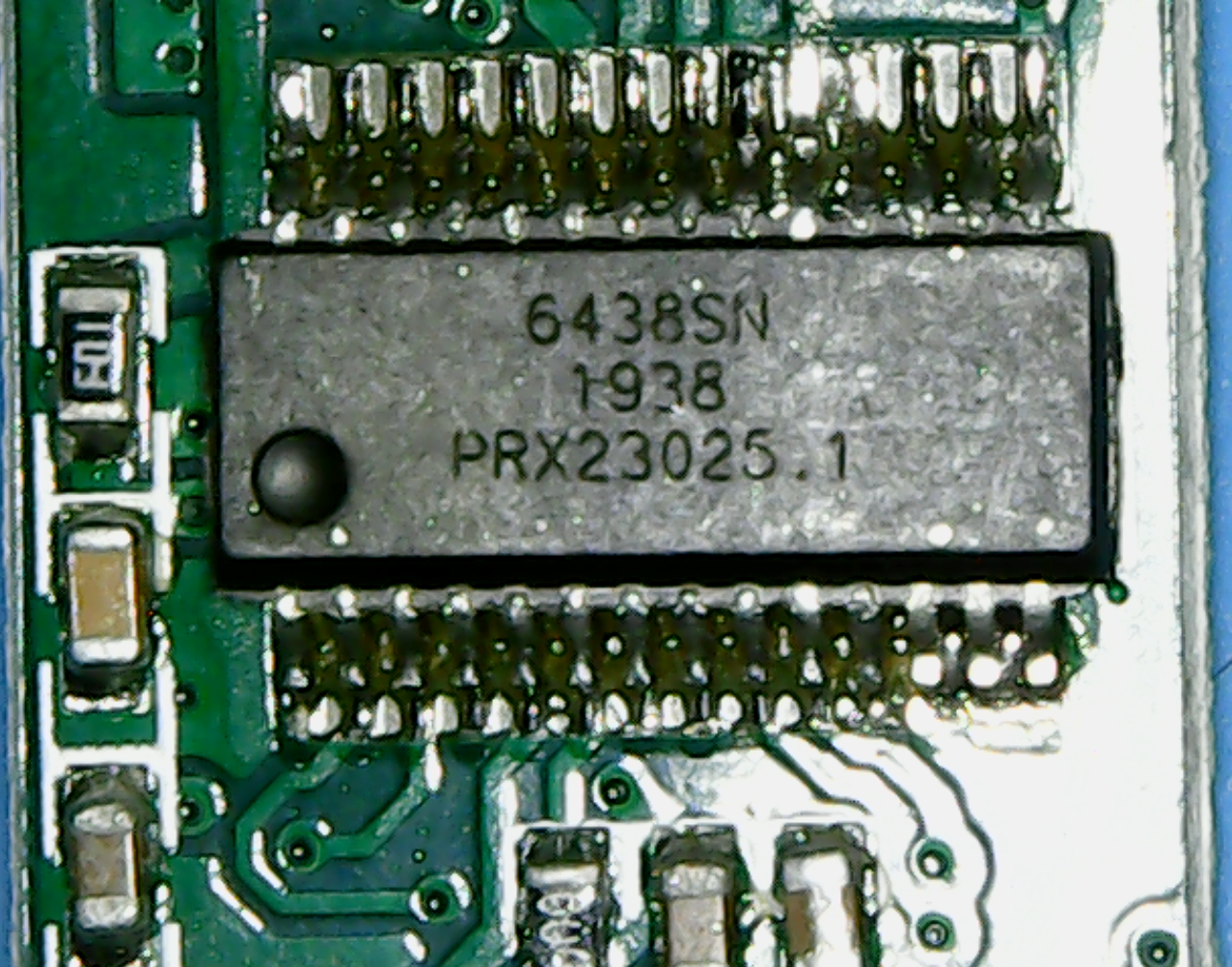

I need to think about what to do. If these adapters I bought a few years ago worked maybe I would have my problem solved
