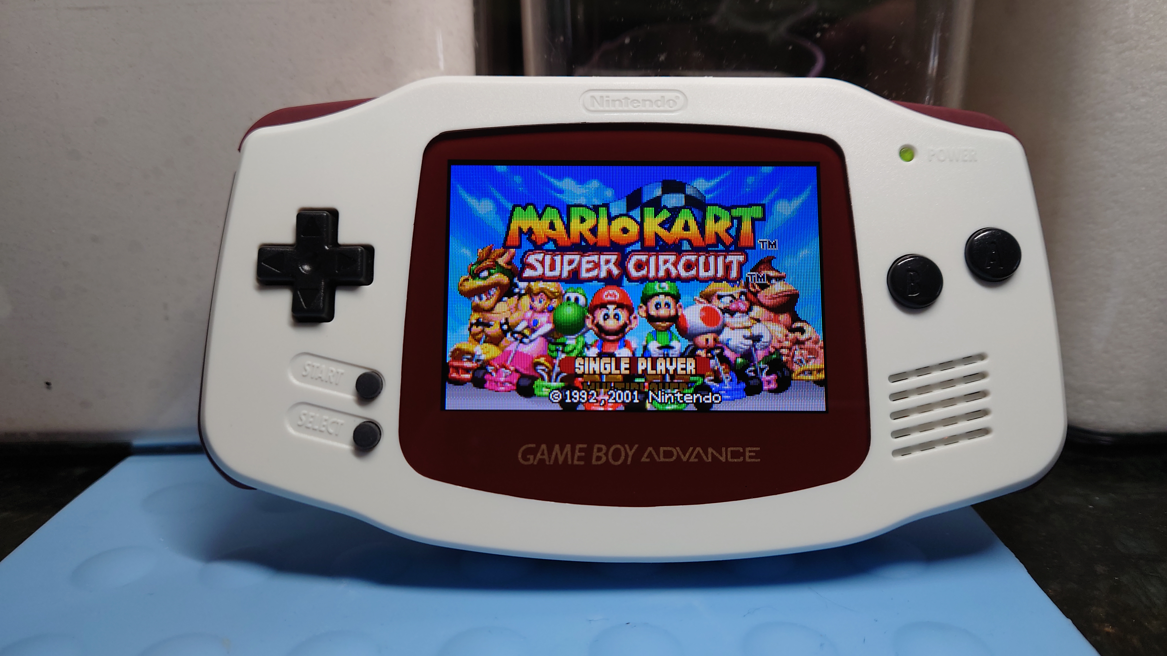

This is one of three GBA's I've 'built' using the FP ITA laminated kit. If you blow the pic up to full size you can see the screen pixels.
