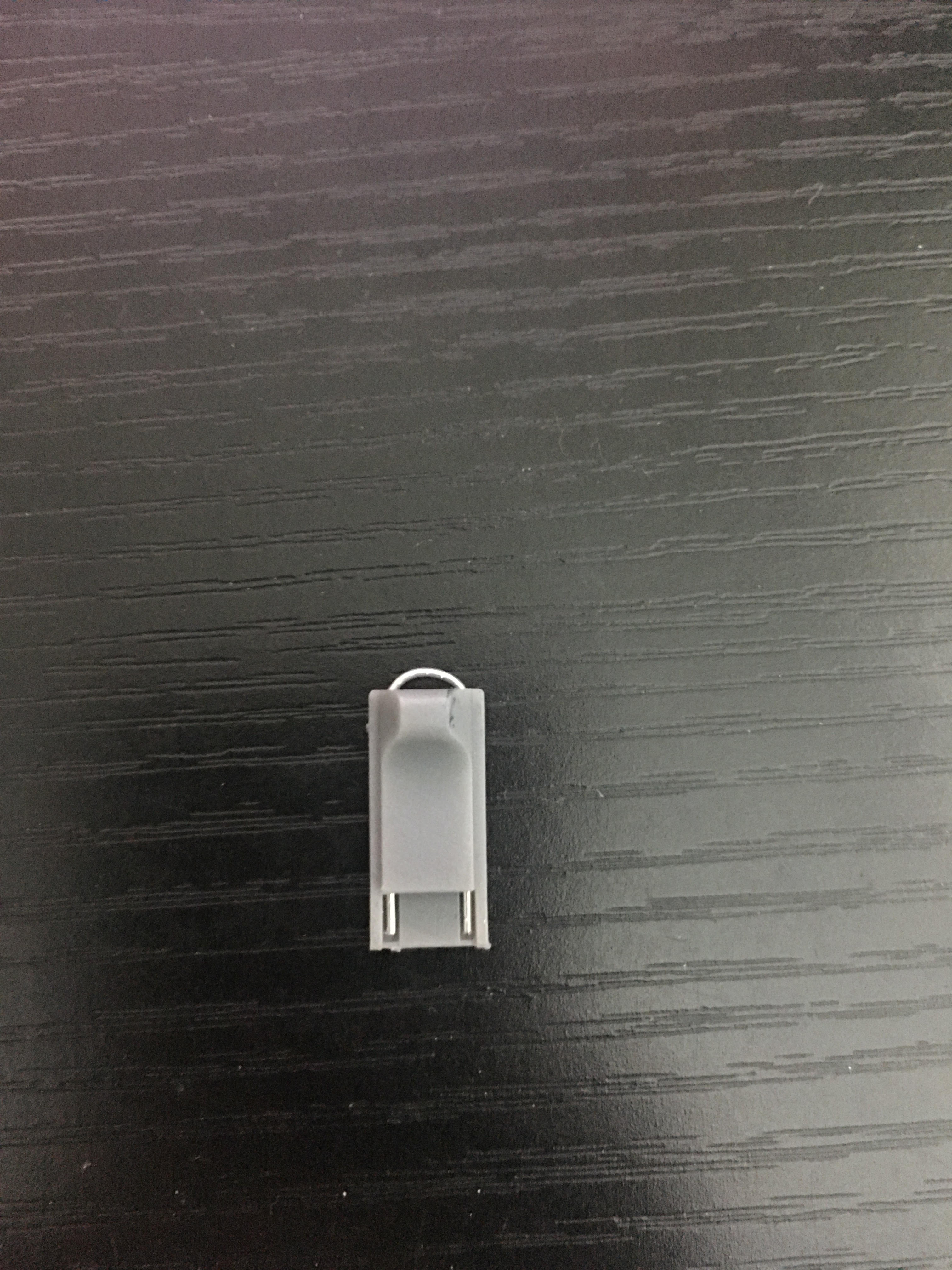

Do you have any pics of your setup?
I do
I can enter RCM once every 5-6 attempts, and ONLY if usb is not plugged (weird)
I have many jig printed so if you have suggestion to improve mine, ill take for sure!
My joycon is also soldered, so I know 100% I have a good contact (multimeter checked for continuity)
I'm starting to wonder if there is some piece of board in my switch that is going wrong

that jig looks nice... try what PatrickJr said above...
If it still can't, maybe that pins on your jig are too deep inside the plastic and not making good contact? If so maybe you can add paper below them just to rise a bit and see if it works.
Reactions: King_Knoedel
This did the trick for me at least. I'm in the middle of my first nand backup now. Thank you
