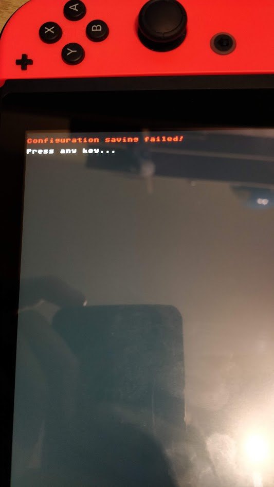

I get this error message when I change the verification options :(
This happens when you don't have an sd card normally. If you have, what's your hekate ini?
