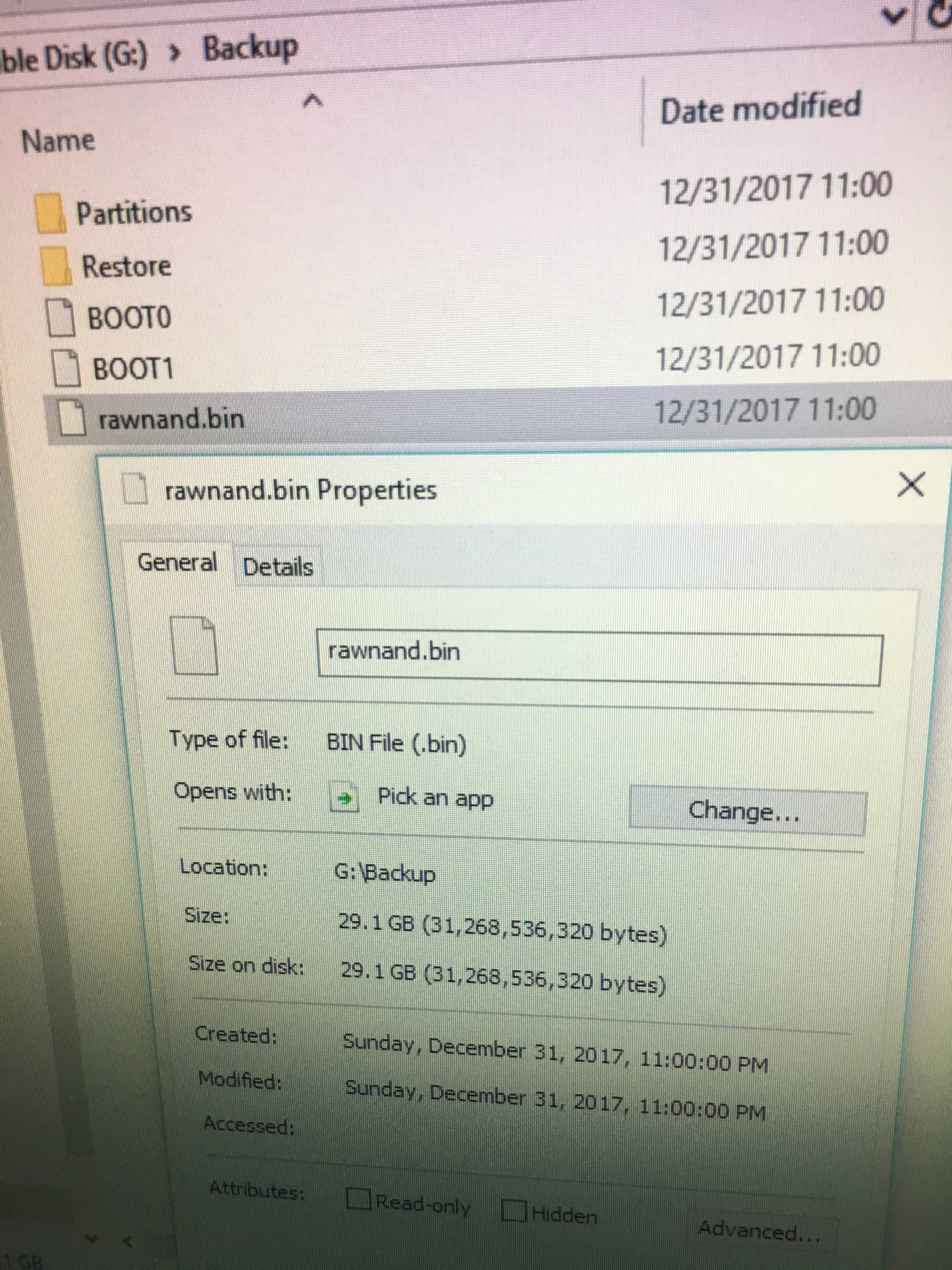

The filesize is correct.

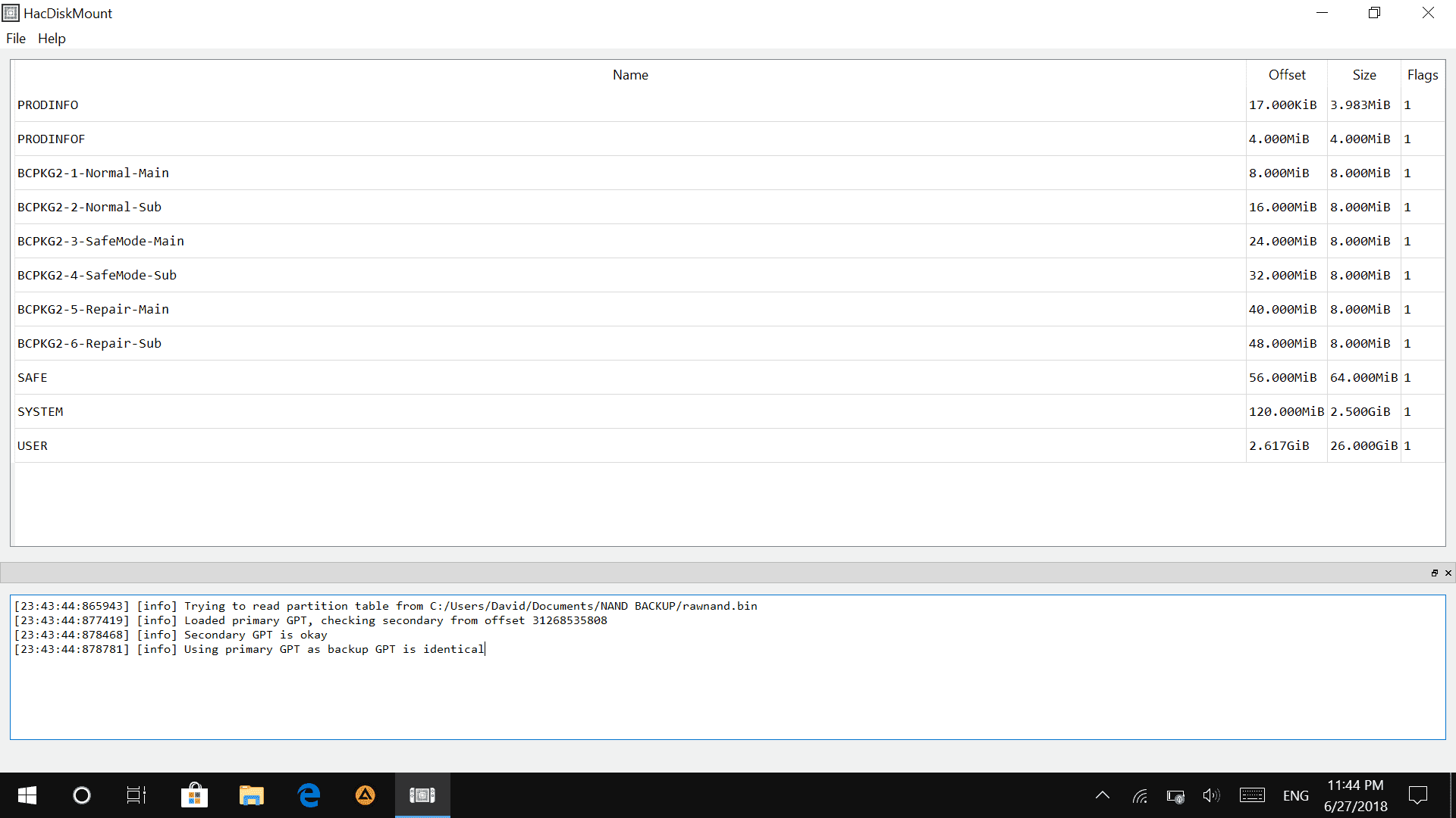

[06:14:20:146294] [info] Trying to read partition table from -snip-/raw4-20180627/Backup/Restore/rawnand - Copy.bin
[06:14:20:150584] [info] Loaded primary GPT, checking secondary from offset 31268535808
[06:14:20:150880] [info] Secondary GPT is okay
[06:14:20:151003] [info] Using primary GPT as backup GPT is identical

Actually, just open the backup in a hexeditor and go to 31268535808 (decimal), take a screenshot and attach it here.

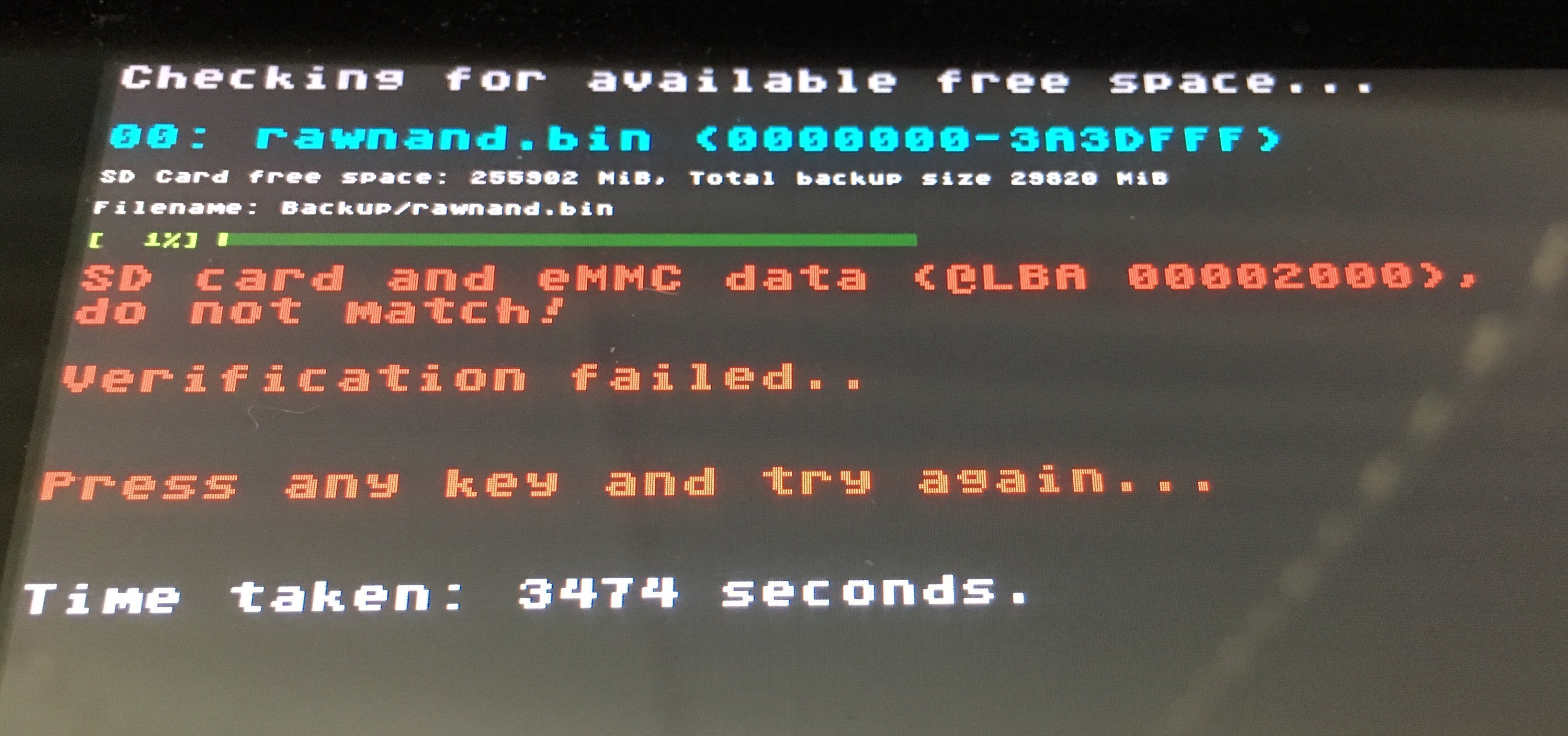

I used Horizon 5.1.0 to format the SD card again.
I ran the latest version of IPL that I compiled last night to dump boot and full nand. Took just short of an hour to do the dump.
Validation failed immediately.
The file size for Backup/rawnand.bin written is still right.
Perhaps it's extended writing to the SD card that's causing an issue, and it's just writing 00's.

*EDIT* the SD Card test did NOT come back good. It's most likely a 32 GB card sold to me as a 256 GB Sandisk SDXC. Frustrating, but I think I can solve that problem outside here and try again later. The SD Card had a nintendo album and some game updates living on it, so most likely could not fit the nand backup in the memory that was good, which I'm guessing is why all the secondary partition was read from the SD card file as all 00's. Oh, the irony of trying to hack my console with a hacked SD card.
That's unfortunate :/
I hope that you can return it and get your money back. Send me a screenshot of Print sdcard info and maybe I can tell you if they also faked the vendor details.
And yes, a fake sd card that can reply for addresses out of its real max, it normally replies with 00s or it starts sending the data from the start.
