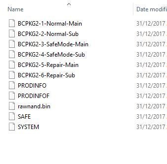

Hi,
This all started from when my switch got bricked to the Switch Logo after install the bugged Pokemon Lets Go Pikachu.nsp that was released today.
My nand dump was created on 5.1 firmware before I did any CFW stuff, using Hekake 3.2. Attached is the list of list it created:
Today I updated my firmware to 6.1 firmware suing ChoidujourNX and it was working fine until I install that NSP.
Booted in Hekate 4.2 with the files copied onto the SD card and tried to restore which didn't work.
Created the create folder structure after some reading and put rawnand.bin file into the restore folder and tried restore boot0/1 which didn't work.
Tried restore emmc RAW GPP exfat only and the restore process started and completed in over an hour.
Rebooted and got black screen only but could still inject hekate.
Tried disabling AutoRCM in Hekate, no luck.
In Hekate I did went to Launch, Stock (noob mistake) and it did some process to the kernel, not good I know. It finished to a white screen.
Now rebooting takes me to a blue screen but I can at least inject hekate.
Tried restoring GPP partitions and it errored on user but the others were fine.
Rebooted, Blue screen.
I am currently restoring the rawnand.bin hoping that fixes the issue but if not I'm not sure what else to do or what I'm doing wrong.
Any help would be greatly appreciated. I'd be happy with a switch that boots in OFW and CFW, don't care about the games or saves, updates etc.
Thanks
Update - Restoring the Rawnand.bin again didn't help. Still boots to a blue screen :-(

rawnand is paired with BOOT0/1. If you didn't restore these you can't boot.
These 2 must be exactly named BOOT0 and BOOT1
Im trying to restore my Boot0/boot1 partitions and well... it says ERROR 4 while opening back up!
You need to adhere to the folder structure.
if you have BOOT0/1 and rawnand.bin, you've put them in /backup/<eMMC S/N>/restore/
If you have only partitions and BOOT0/1 you've put them in /backup/<eMMC S/N>/restore/partitions/ and the BOOT0/1 to /backup/<eMMC S/N>/restore/
Where <eMMC S/N> is your eMMC serial number, as shows in the photos you took.
Error 4 is no file found and 5 is folder not found.
