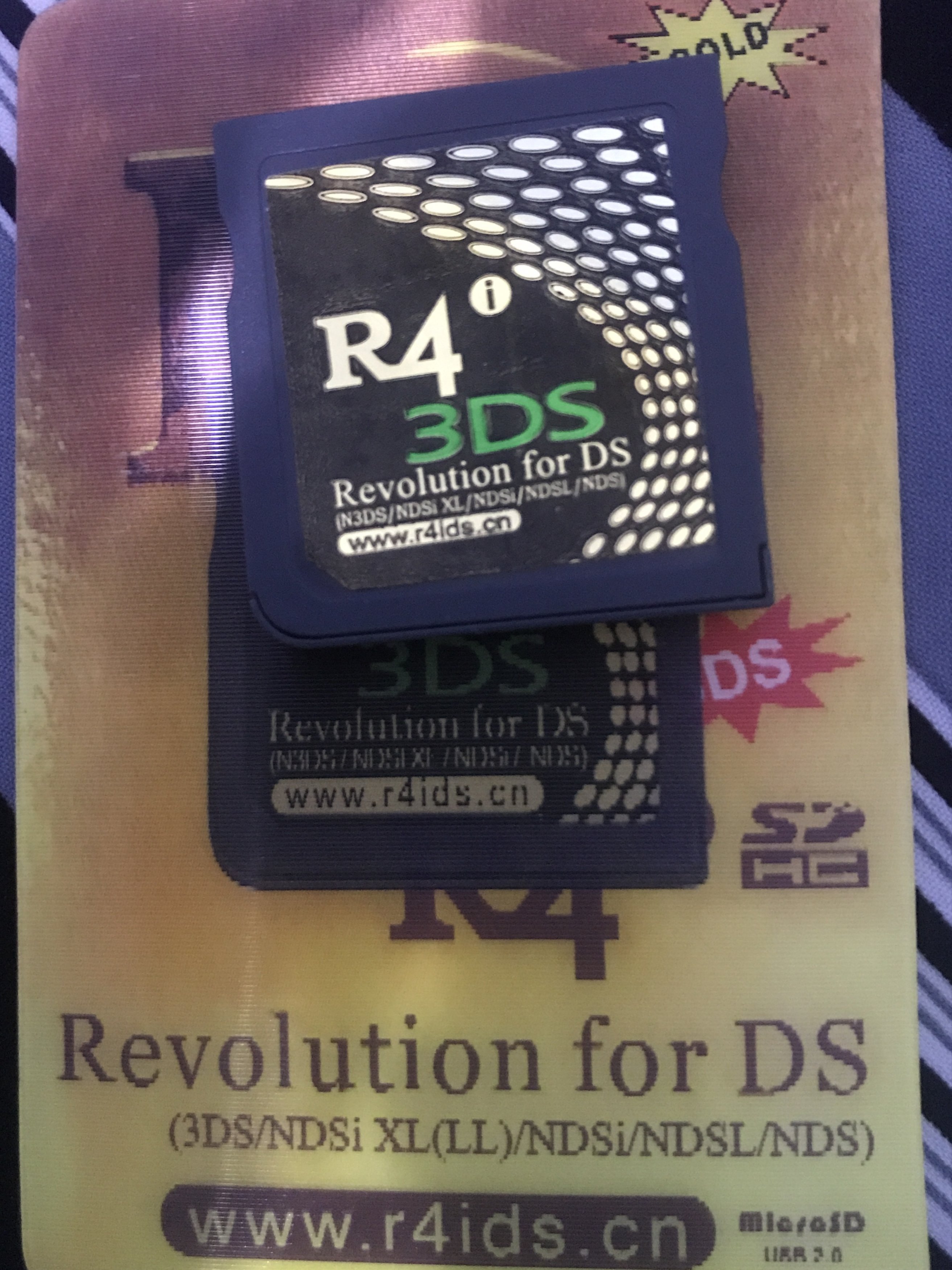

I have a Nintendo dsi version 1.4.5E.
I got an r4itt card yesterday and it’s not working.
The site is down and I don’t know which kernel to use since I can’t get the latest one from them. I keep getting ”an error has occurred please refer to manual“ error When I tried different kernels.
Please help.
This is the photo of my card

I gave up with the r4itt and I got another one. But I’m still getting the Same “an error has occurred “ issue
I can’t eat .. I can’t sleep ..
I need to get it to work

Go to the website on the box and download the newest update for the cart. Make sure you pick the right one as it looks like they do a few different ones.
Edit: Looks like the download links on the site dont work anymore. Last update was in 2013. You bought another ancient card.

The problem is being sure its for the exact right card. Installing the wrong one could permanently brick the cart.
This is indeed a problem since the cart seems to be an older version missing the "RTS" The update may or may not be compatible.
To apply the firmware update you still need another DS(-lite/phat) which boots it with the current firmware.
Revision C, means that your R4 Gold is compatible to do the firmware update with patch files.
@Potato8741 Do you have a DSLite or can you find it?
Because only on a DSLite you can run your R4 Gold and then upgrade to firmware 1.4.5.
