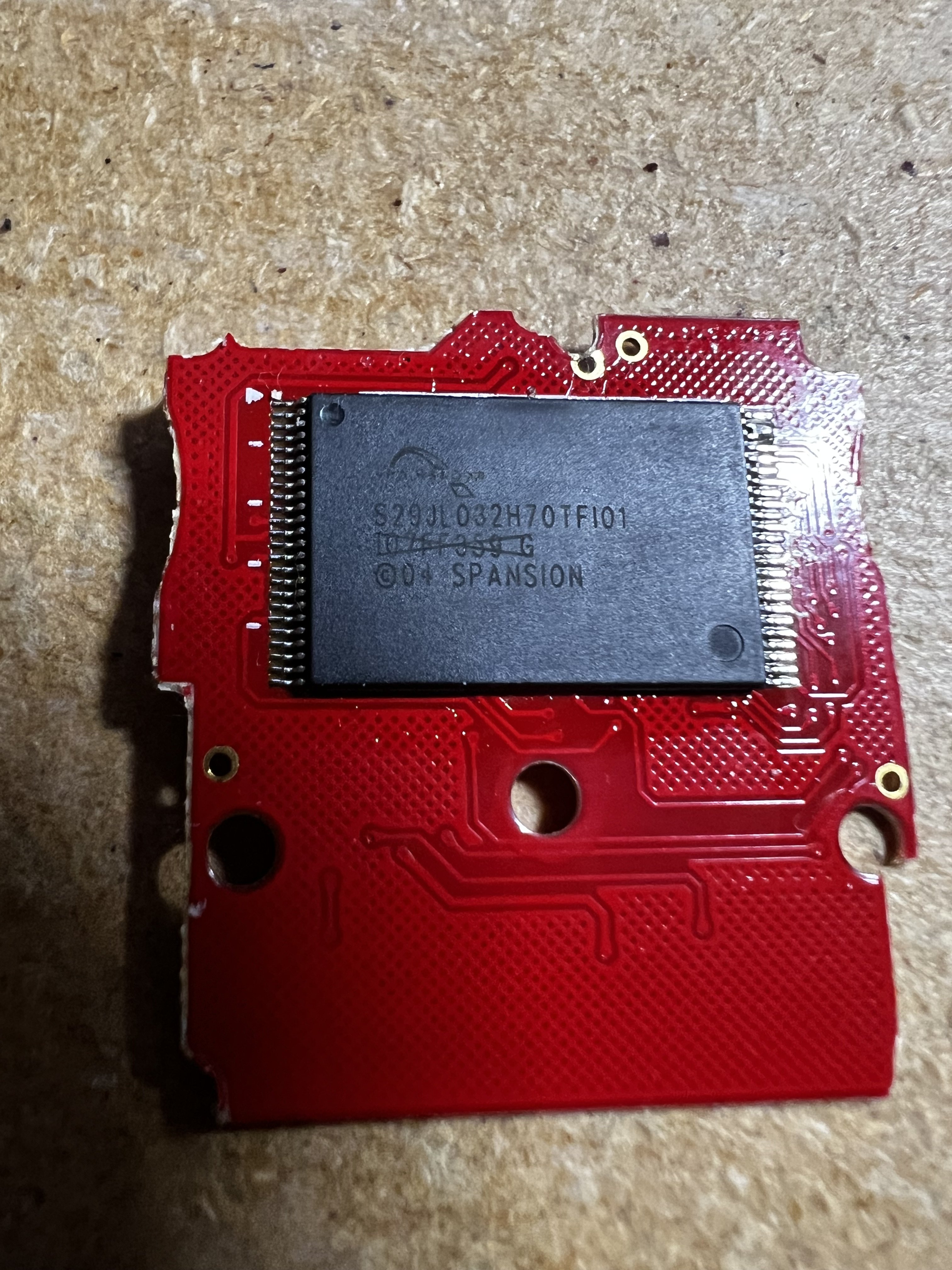

yes i understand and thank you for help, but i want to see if there is a hardware solution like to dump the nand of a new r4 and inject it in the tsop48 nand of this old r4 , any chance ?
This is not a NAND, it's a flash chip. There's a difference. I'm not 100% certain on what you're trying to achieve, but no, you cannot reprogram the flash chip to my understanding using conventional 'homebrew' methods. However, the original DSTT can be reprogrammed with ntrboot-flasher, only the DSTTi carts are unsupported like what you have there.
If your R4 operates as intended then I don't see a reason to fix it. Unless, if the cart doesn't boot, then you can fix a bricked cart by performing a hotswap with a working flashcart whilst updating, but this only works if you have an Original DS model.
reprogramme it with a nand programmer (t48)
Sure, let's assume you can reprogram the FLASH chip using hardware.
But then comes the problem of you being completely unable to understand what the contents on that FLASH chip. Much less the task of making it compatible with higher versions.
You'd be better off softmodding your DS consoles and deleting the cartridge blacklist rather than try to spend 10 years on this.

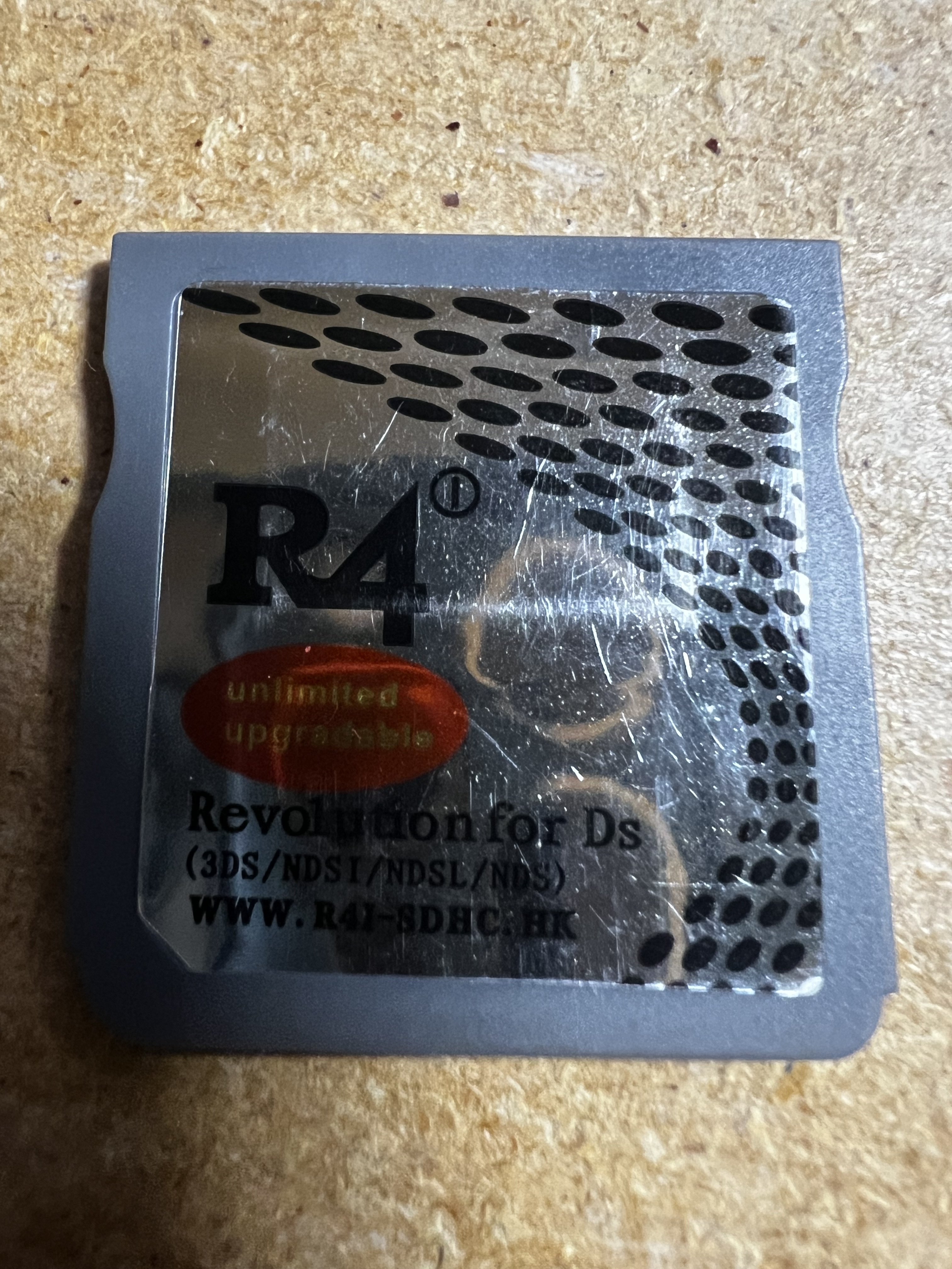

Please, I need help i have the same R4i Revolution as the picture and i have a 3DS, im desperate trying to make it work and i couldn't, as you were saying about the firmware 4.2.0, i just checked mine and i have a higher version (11.13.0) how can i get the custom firmware? Thankss
Follow the guide here for installing custom firmware. https://3ds.hacks.guide

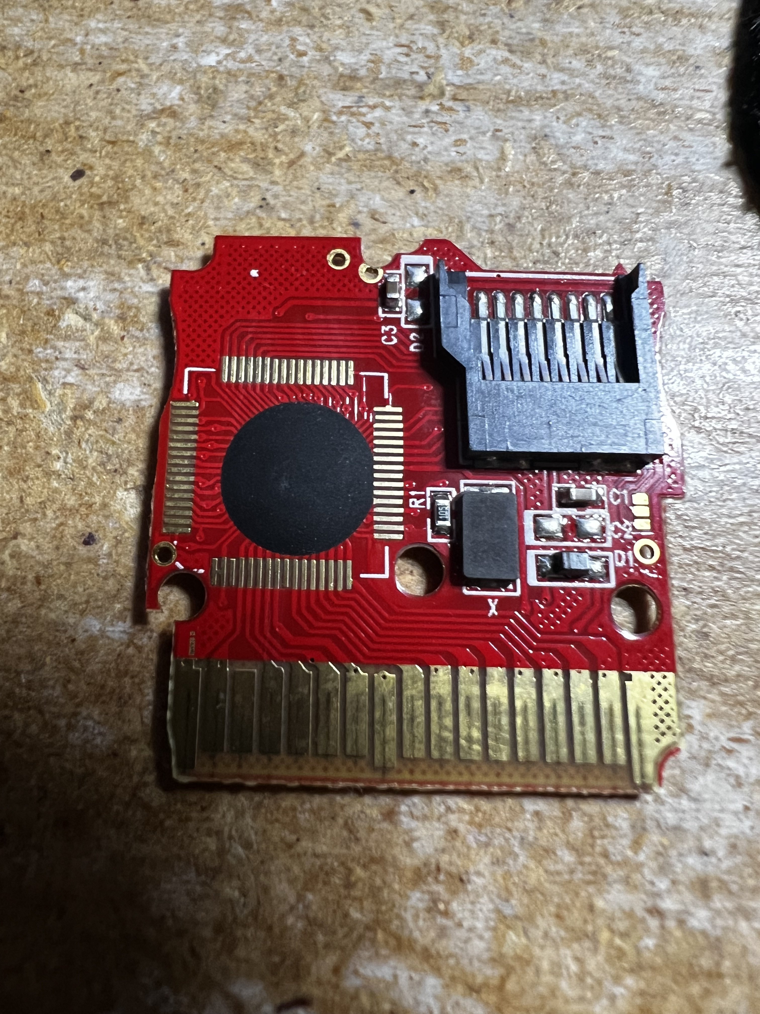

I have this cart and the update did not work for it. It seems to be similar to the R4i Advance cart as I was able to use the update.dat for it and was able to restore my cart.
I needed to get the bootloader update for R4i Advance from here: https://www.thetechgame.com/Downloads/id=73692/r4i-advance-bootloader-update-3005.html
and the update.dat from R4i Advance (English4.3) kernel from here: https://web.archive.org/web/20120831122128/http://www.r4i-advance.com:80/en/down.asp
After running this I was able to boot my cart again. Not sure why the official update posted above by @SylverReZ did not work for me.
I used NTR Launcher and the DSTT stage2 loader to get my not working cart to boot to perform the update. Also it looks like you can just run the update from the R4i Advance 4.3 kernel (bootloader.nds) not required. Hope this can help anyone who’s cart doesn’t boot after using the normal update.
