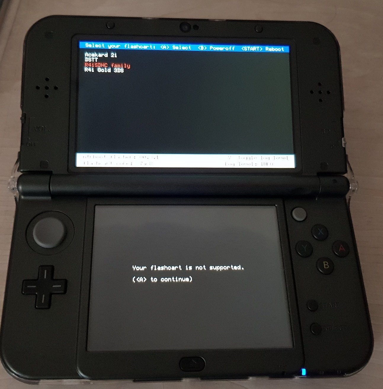

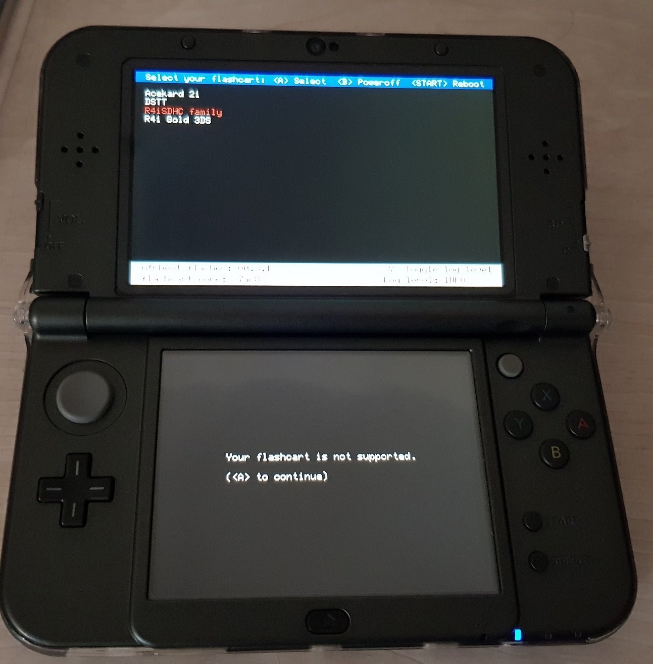

the ntrflasher is unable to find the r4 card
It stated flashcart is not supported
I have tried section v

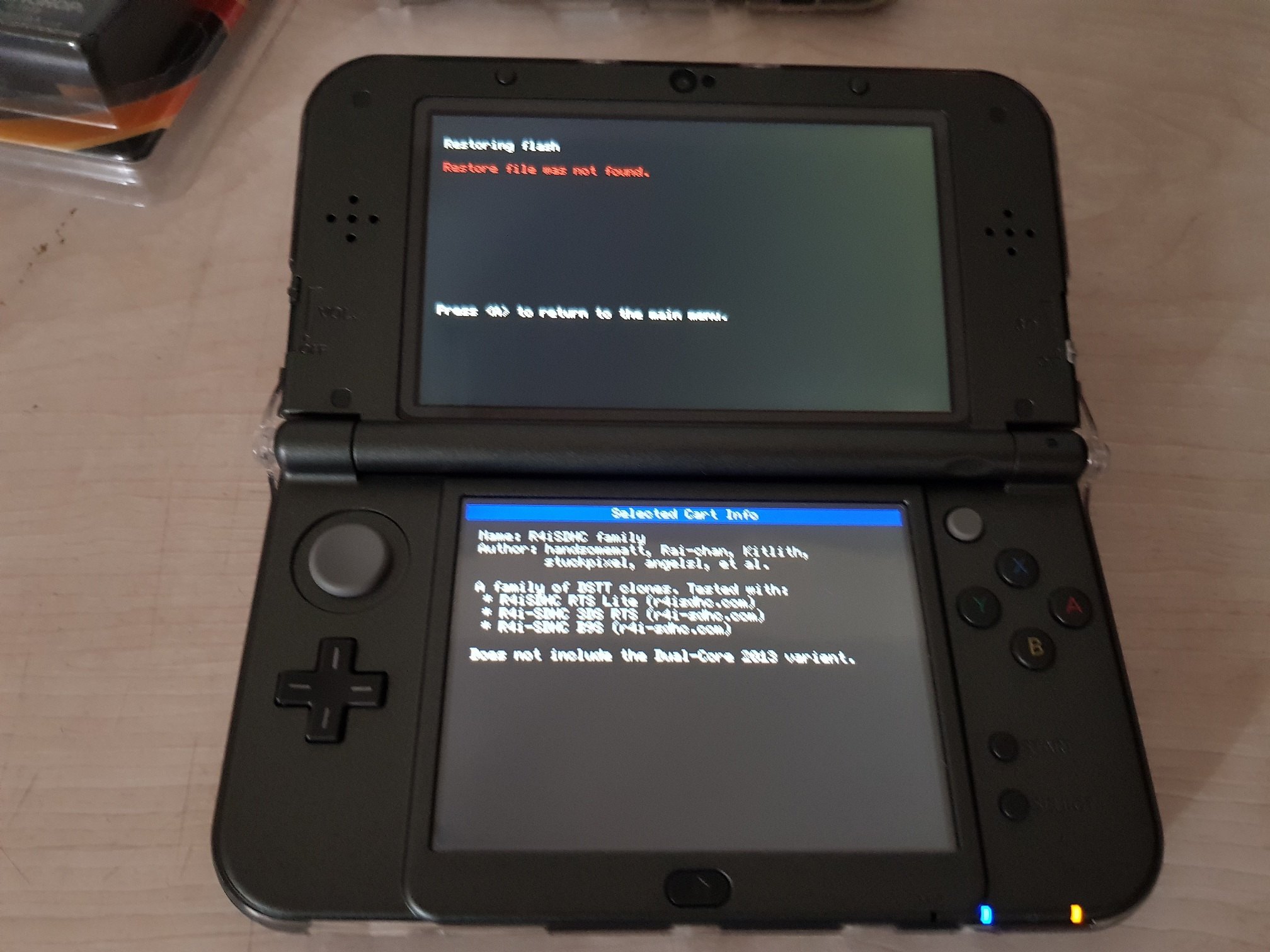

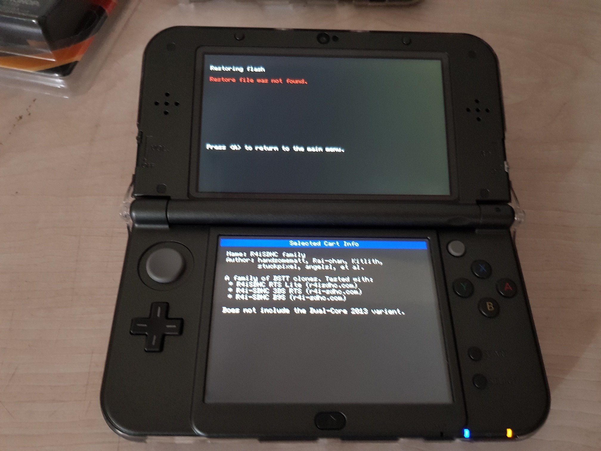

20180225_171148.jpg with this special version, it is able to detect the flashcart now.
But it is unable to find the backup.bin
I have put it in ntrboot folder
both backup.bin dont work
do you have the r4isdhc-backup.bin for r4i sdhc 3ds without rts bin
The flashing is sucessful after i have renamed to r4isdhc-backup.bin. but the R4 card doesnt show metroid in the menu

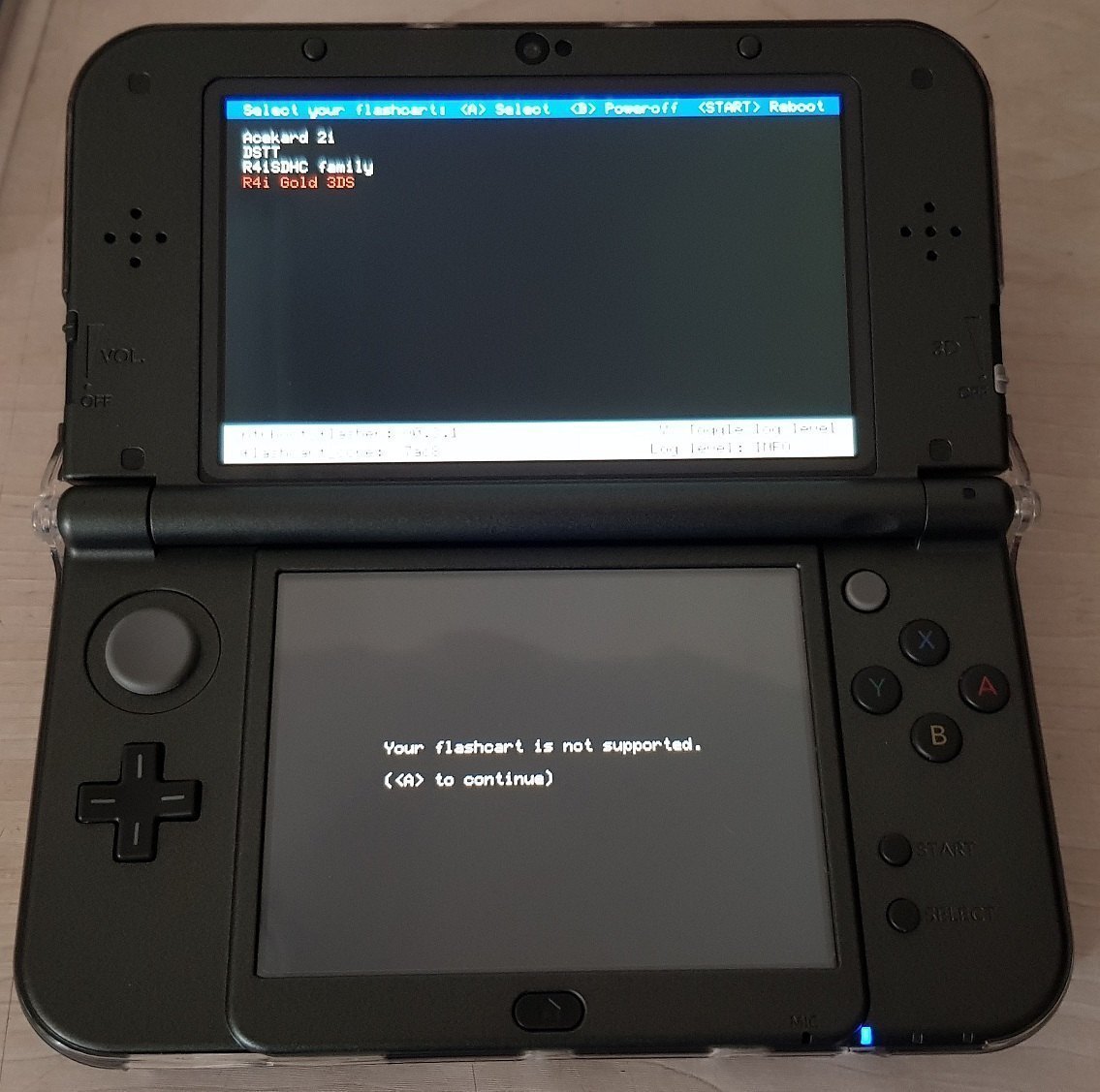

after i have flashed R4i 3DS Rev C non RTS backup.bin , it will hang the 3ds.
so i tried another file. now the flashcart is not supported again
Are you able to design another ntrboot software so that i can try all the backup.bin without getting the error "flashcart is not supported"? Thanks
