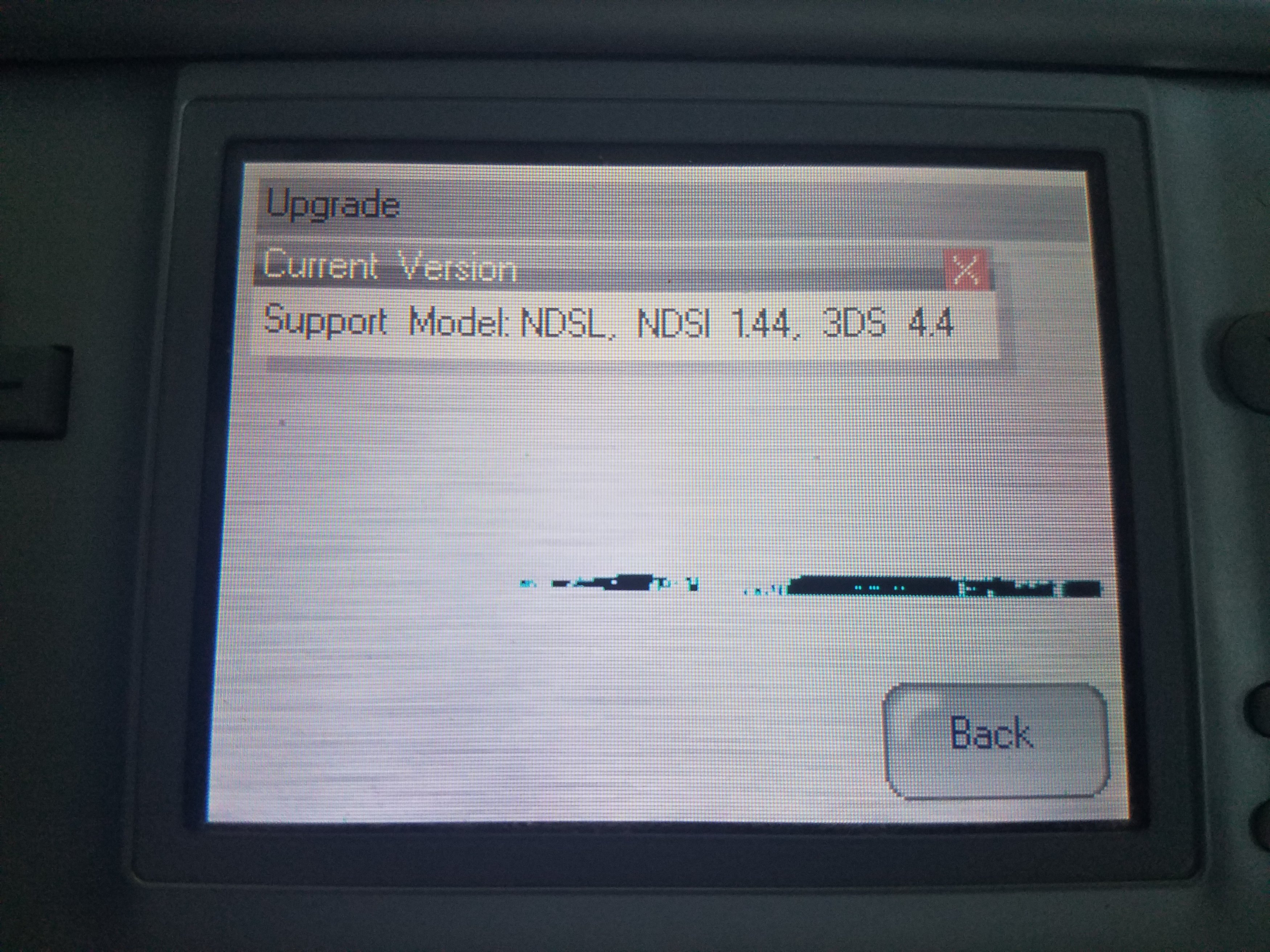

Hello GBATemp! I'm new here, so please excuse the lack of formatting. I have an R4i 3DS that my dad bought for me back in 2013, and I never got it to work on my 3DS. I'm not even sure it is an R4i 3DS. Everything I've tried, everywhere I look, there's no fix for getting this to work on my younger brother's original 3DS running 11.13 or my own New 3DS XL, also running 11.13. Anything I try to get it working ends up with a black screen with some text (shown below) It works just fine on my old DS Lite, though. I've since been using some cheap flashcart that I got at a fleamarket, which for some reason does work on 11.13. Can anyone lend some info or help? Thanks!
Here are some images that may help.

I don't think it has to do with the menu, rather the firmware like JuanMena said. Something of interest is that the R4 that does work on my 3DS is almost identical to the one that doesn't work, other than the fact that it has a bomberman land icon instead of a metroid prime hunters icon. Another thing worth noting is that the working R4 card, under upgrade, says "Current version, 3DS 7.2", while the non-working one says "Current version, 3DS 4.4". Would there be some way to upgrade the non working one to the same version as the working one?

Ok, so new update. I've gotten the problematic R4 to upgrade to 3DS 5.0 using a thread from GBATemp, and the cart now looks like "Touch! Bomberman Land", just like the working R4. The problem is it still throws the same black screen error as before on the 3DS running 11.13. I've seen some posts saying that some old R4 flashcarts only support 3DS 5.0, and can't go further, and that seems to be the case for me. I would somehow need to get the problematic flashcart to upgrade to 3DS 7.2 compatibility like the working flashcart, but that doesn't seem like it's going to happen anytime soon. Again, as previously stated, I have no current interest in homebrewing my 3DS at the moment, and have noted this fix. If there is any further help you can provide, that would be greatly appreciated. Thanks!
The Problematic Flashcart (again):
The 3DS 11.13 working flashcart:
New Touch! Bomberman Land Icon, like the working flashcart:
3DS 5.0 upgrade succeeded, yet still fails to boot on 3DS.
