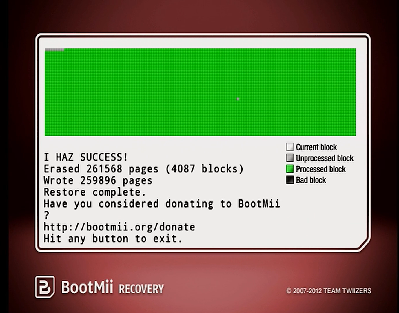

I know, im stupid. My wii is full bricked. Turn it on, straight to black screen. Bootmii via boot2 was unavailable and I think I forgot to install priiloader and just launched the app and got distracted...
I attempted to install another system's nand onto this console, it gave this screen, then upon restart appeared to be bricked. I attempted to do savemiifrii with a ccp to gcn adapter and a taken apart ccp but nothing different happened just same boot to black.
Can anyone help me pls im so lost
