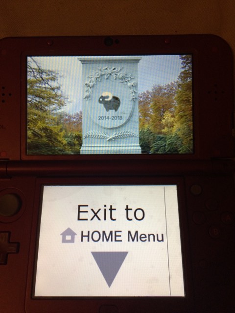

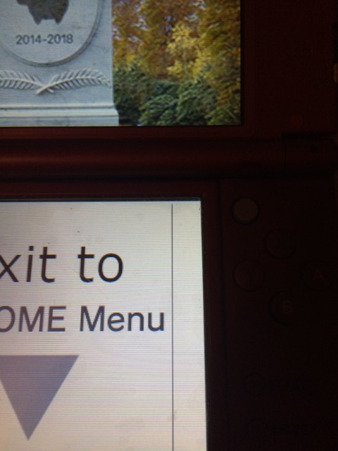

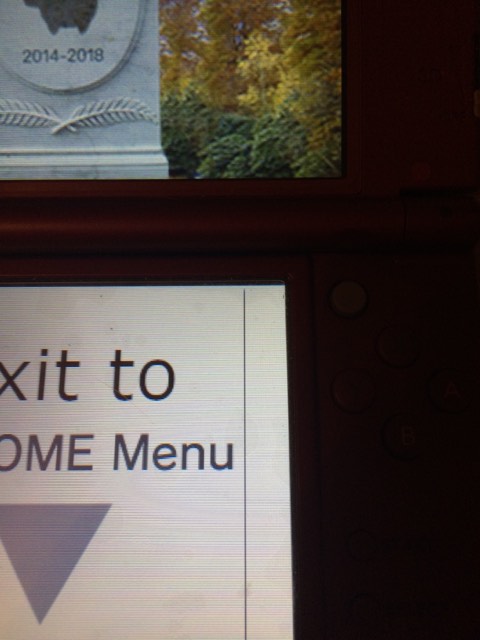

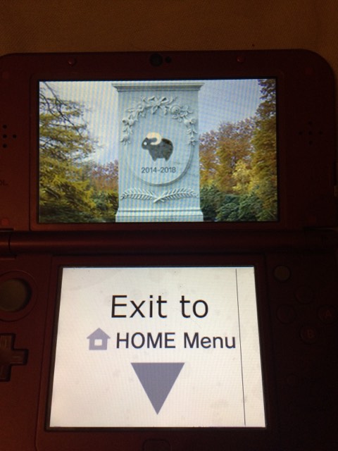

well im getting ready to do this soon myself so i will update on my status. i still dont think i can decide wether or not the line on my touch screen bothers me enough to replace the whole screen. seems tricky not ripping those ribbons.
here's some pics. i did nothing for this line to appear, it just came out of no where.
View attachment 173699 View attachment 173700
is it only this one app that it appears or is it on more?
