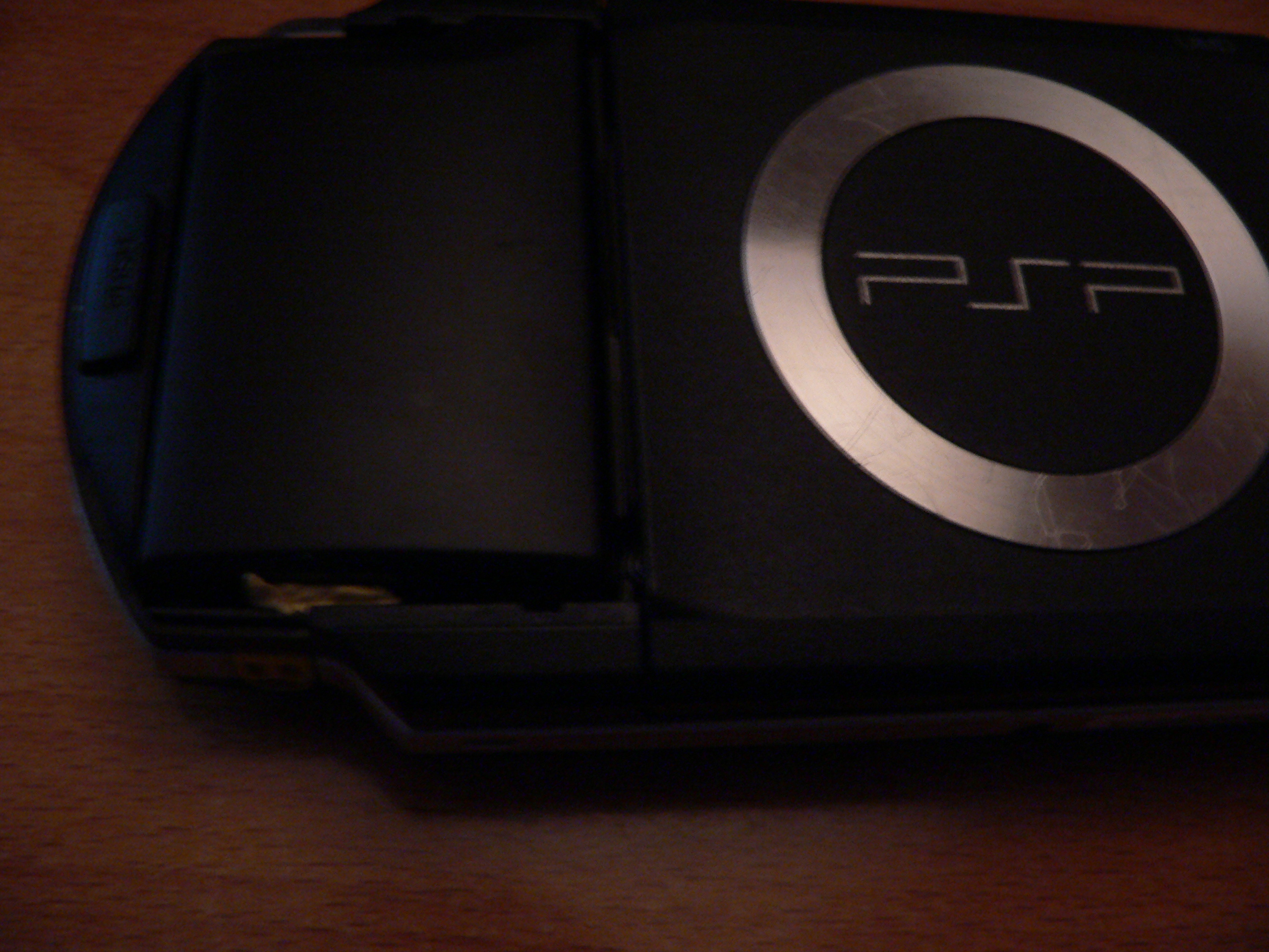

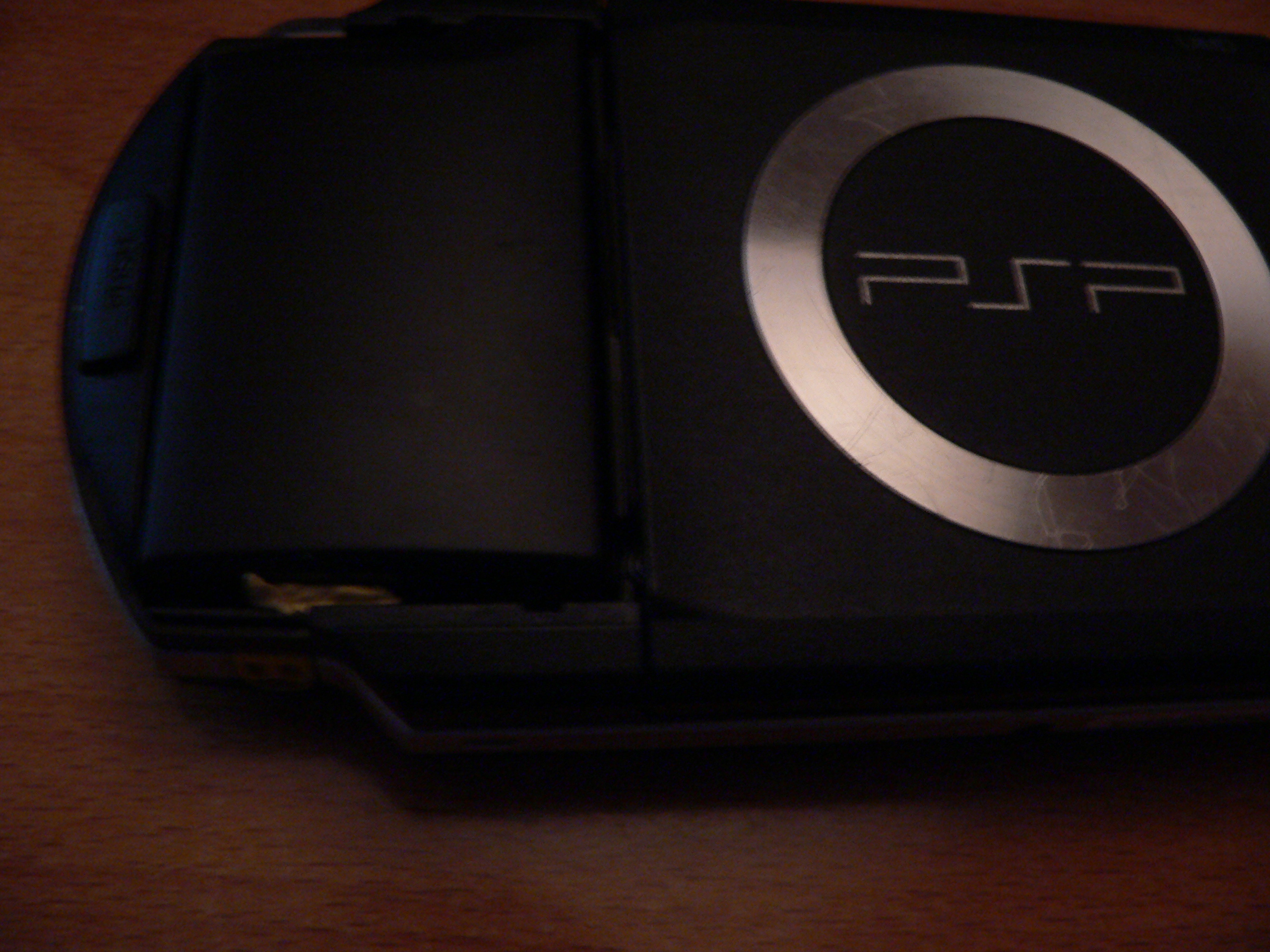

I have this Behavior on my PSP 1004 with an 3rd party Batterie sometimes.And then there is no Charging possible.:(
There is a tiny,little "Leeway" between the PSP Batterie Housing and the Battery itself.
Sometime I put a little Piece of Paper into the "Void"
When I pull it in/out,it works again.:)
