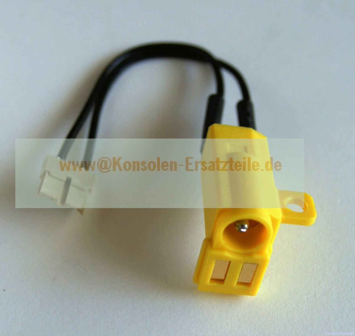

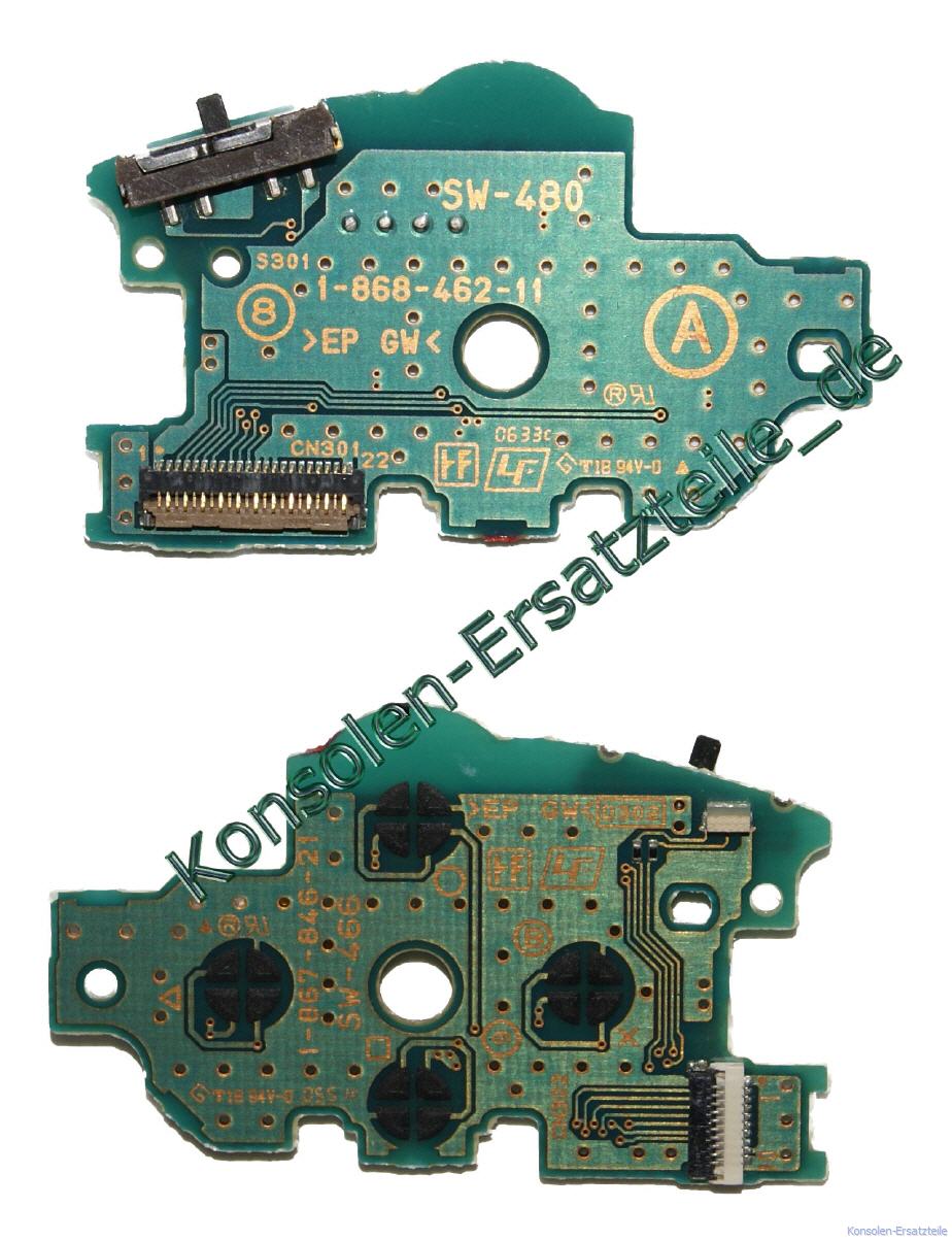

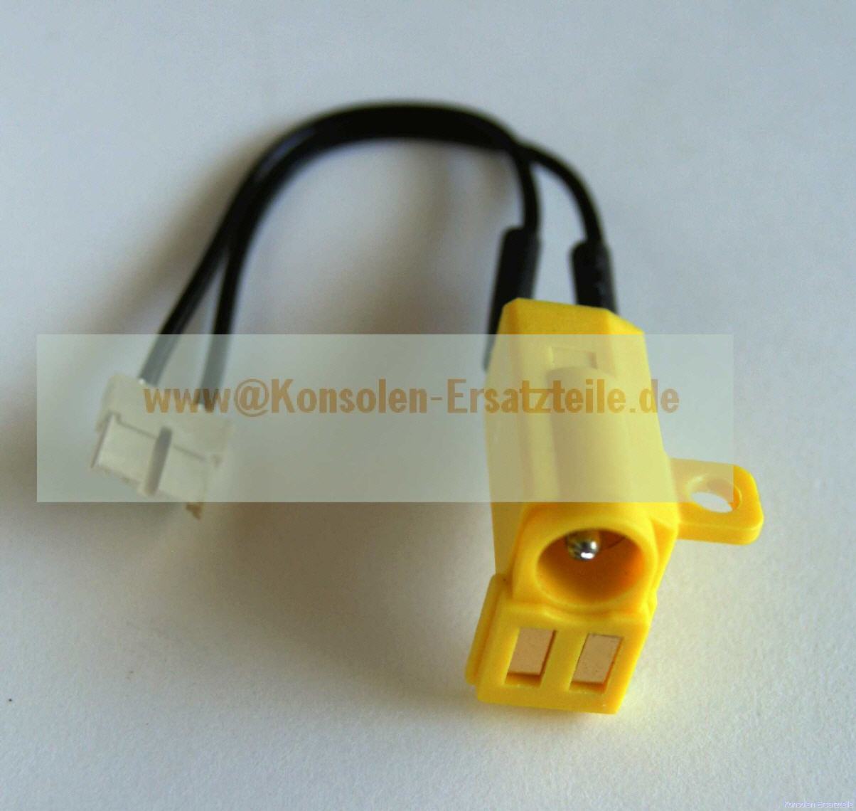

Hi how are you? I updated to the latest version 6.61 last night I put the memory stick of my psp 3000 with more or less 15 games and everyone loads without problems also try with umd games and load without problems the lens is perfect, yesterday I played until it stayed Without battery, the LED never flashes when it has low battery, when the PSP went out due to the battery the orange light is still on, the PSP does not have a charging pin, therefore I cannot charge it, but I charge the battery in another PSP that I have, if I put the battery of the fat in my other psp that is the 3000 it is charged without problems and the light when it is not charged is green as it should be but in the fat it is always orange, if I go to the psp battery in the fat it appears that It is being used normally without charging, just put a battery the orange light turns on without turning on the PSP, that's what happens, my question is if the battery runs out while not using it
Hello.:)
Thank you for your detailed error report.
It is hard to tell the only possible solution to find that out ist to put the battery fully charged in the 1004er and put the PSP aside and leave it for a few hours or 1-2 days.Then you maybe see if the Battery display shows a unusually fast unloading/using of batterie or not.
Parts you maybe can replace:
Charging connector
ON/OFF/LED Switch
Together max.10-15 Euros (you can search on Amazon/Aliexpress)
I do not find a replace part for the Battery/Contacts because I fear that all on the Mainboard and replace THAT I think that is not economical.:(
Thank you.:)
