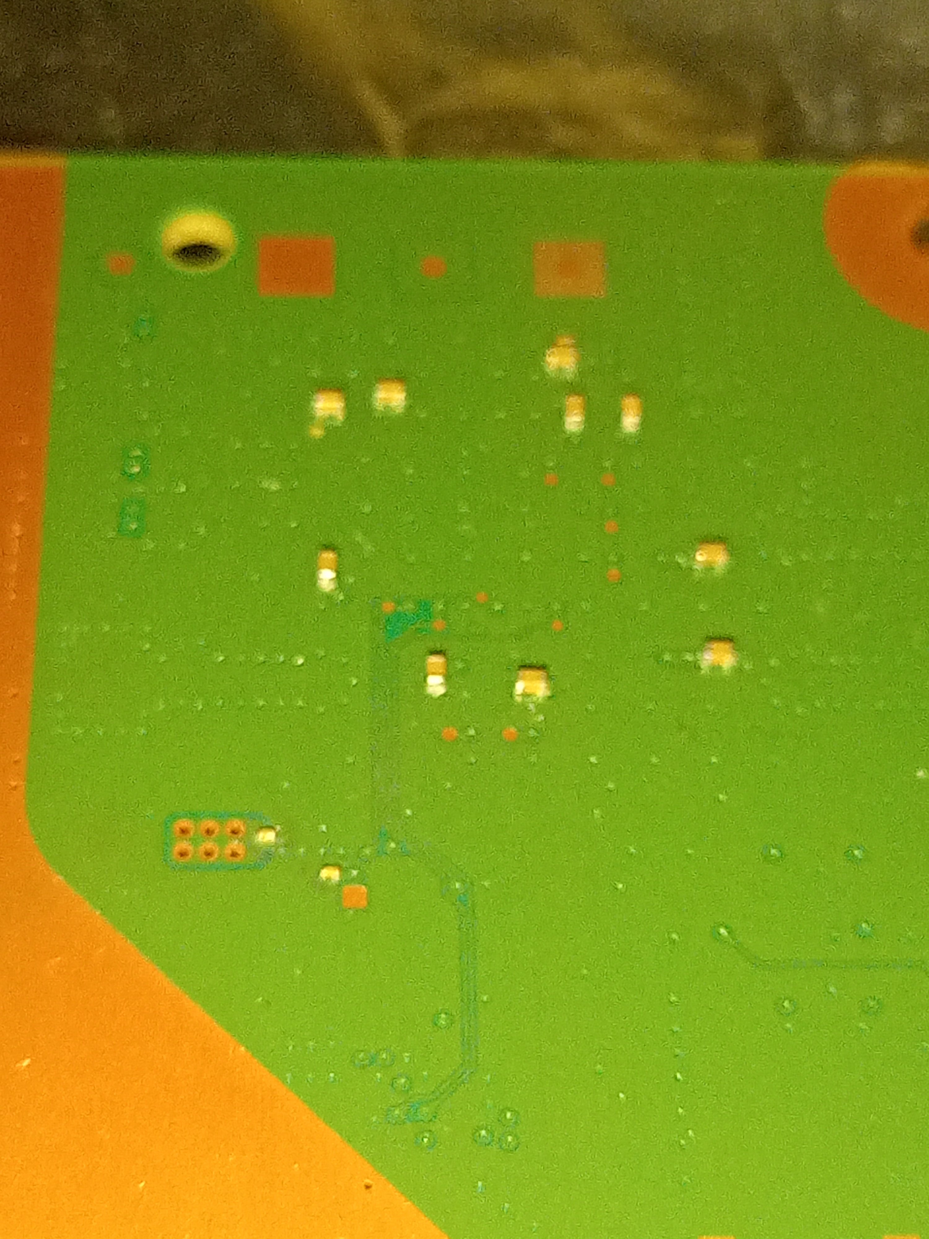

I'm trying to eradicate a short on a EDM-010. The short is after the 5v 3v chip TLV62090RGTR on the back of f7002. I have been advised that it may be a cap on the underside of the wifi chip.
Does anyone know the value of the caps there are 10 altogether
Found out they are 10uf 0402.Removed four that were shorted but short is still there.
Does anyone know the value of the caps there are 10 altogether View attachment 476772
how about the 2 small ones ???
Both little caps are 1000PF (0,001µF) X7R 0201 10% 50V.
Before removing caps on the backside of the Wifi, I would check if one of them is getting warm by injecting 1V.
