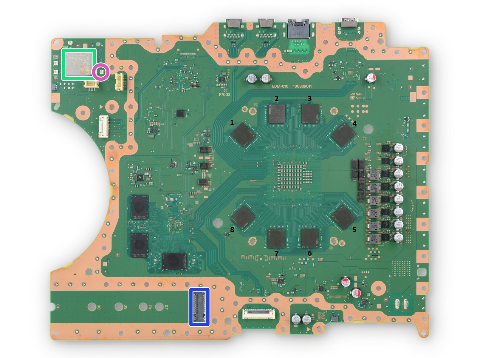

I have a PS5 that died after a fall. When I connect the UART, I get the error code 80801110: Severe RAM GDDR6 (Bank 5) - Single Beep, 1 second blue light, off.
How can I find out which RAM it is, and how can I tell if the APU isn't communicating with that RAM, or if the RAM is broken?

For error code 80801110 RAM #5 would be the RAM chip in question.
It could be the RAM chip itself or the BGA connection to the board or also the other end at the APU or its BGA connection(s) for this RAM chip.

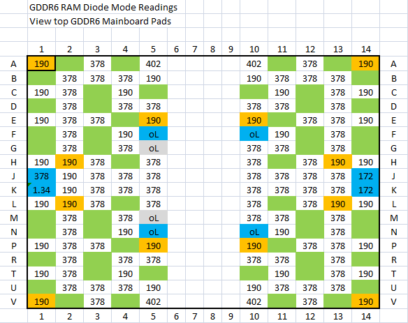

I would desolder the ram chip #5 and check the pads on the mainboard for correct readings.
If the diode mode readings are fine, I would replace the RAM chip direct and not try to use the old chip.
At checking the pads, I usually look for missing or far off values (for ex. 'oL' instead of 378 mV)
Working on APUs is definitiv something for very skilled and experienced persons.
A single APU can not be replaced. As you wrote, it is married to other components.

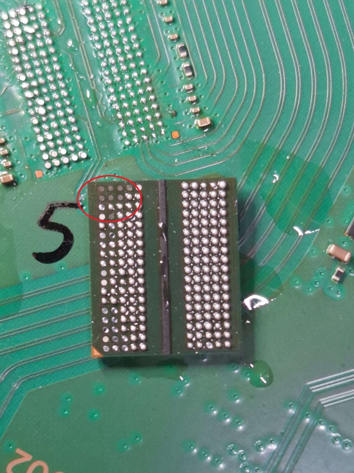

Ok, i´ve found gray pads in ram chip...
I´ve desolder incorrect ram number 1, uart send two errors: RAM 1 and 5.
Resolder correctly ram #1, and error from ram#1 gone.
Changed ram #5, same error.

I mistakenly performed the reballing procedure on memory module #1, and the UART returned an error in banks 1 and 5. I improved the reballing process (using solder balls instead of paste), and the error in bank 1 was resolved. I replaced RAM module #5, but the error persists, leaving the APU as the last resort.
