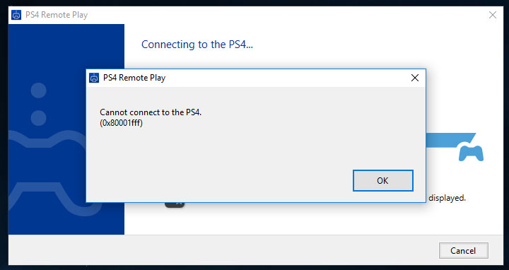

Also I found out that the PS4 needs an active internet connection to connect with Remote Play.
I tried for ages to connect but I kept getting a 0x80001fff error in the app.
I realised that the problem was the PS4 I was testing it on had the lan and wifi mac addresses blocked in my router (to block internet access but allow normal network access)
When I allowed internet access again to the PS4 it connected without the error. (Obviously I still used AlAzif's DNS to block sony update servers)
hmmm... my PS4 is blocked by router and works fine.
Yeah its weird.
With my PS4 wifi and lan mac filtering enabled it wont work for me. it says conected on PS4 then on the Remote play it gives the 0x80001fff error and it says disconnected on the PS4.
I turned off the mac filtering in my router and it works.
The solution I use now is to use my PC IP as primary DNS and AlAzif's as secondary DNS.
This way I can connect to my DNS Exploit Server program on my PC if I am testing my exploit menus and if my server is not running on the PC the PS4 defauts to the AlAzif DNS to give a protected internet connection.:)
I used to prefer using mac filtering in my router because it blocked all internet access to my PS4 but I still had full local network connectivity.

I've just done some more testing and I definitely cannot connect to Remote Play if I have mac filtering enabled for the PS4 in my router .
When I turn it off it connects every time.
The missunderstanding I had earlier when it would connect is because I didn't restart my PS4. As soon as I restart my PS4 it will not connect if mac filtering is on.

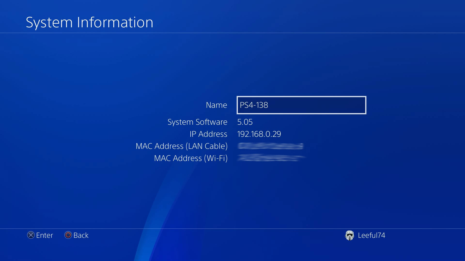

Question. How do you block internet access ? Curiosity.
Log into your router and look for mac filtering.
Add the mac address of your PS4's Wifi and/or LAN adapter (can be found in PS4 system settings under your firmware version).
This will block your PS4 having any outside internet access but will still allow it access to your local network.
I know how to access into our router and find Mac.
All I have to do is find Mac from PS4 and add it to our router ?
Yes, There is one for your WiFi and one for your Lan.
Enter both or just the one you usually use to connect your PS4.
You can test if it works by trying to load google in your ps4 browser (it shouldn't)
Also test your FTP. (This shows you still have local network access)
