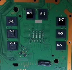

Got same uart reading on recent received ps4 fat/SAA-001 . Mine is DCT0, DCT1 disable. It's the 8x DRAM. Anyone knows which side is DCT0. DCT1?

look at this picture. you must resold or reball 0-1 and 4-5 rams and if it didn't work must replace them
