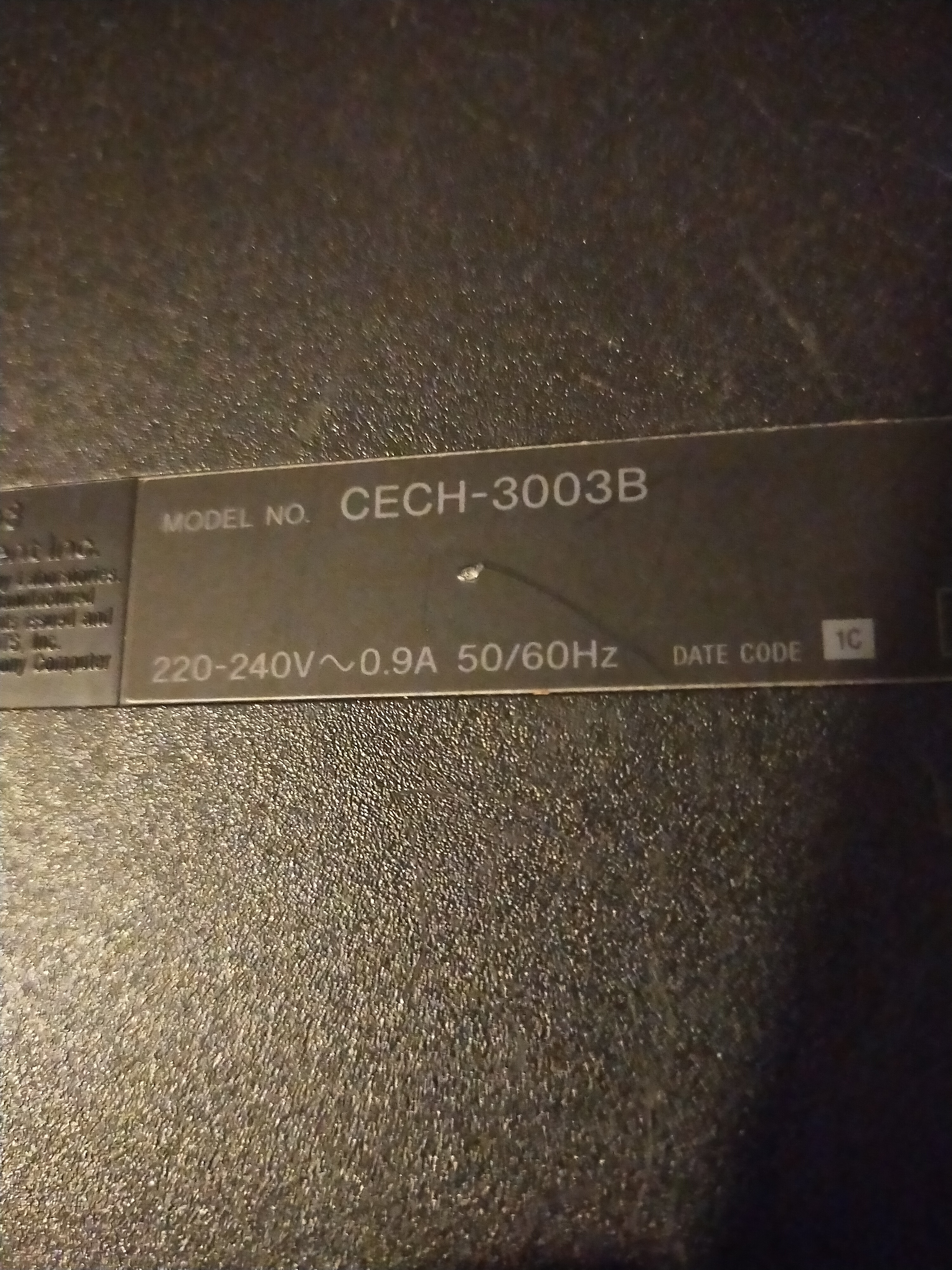

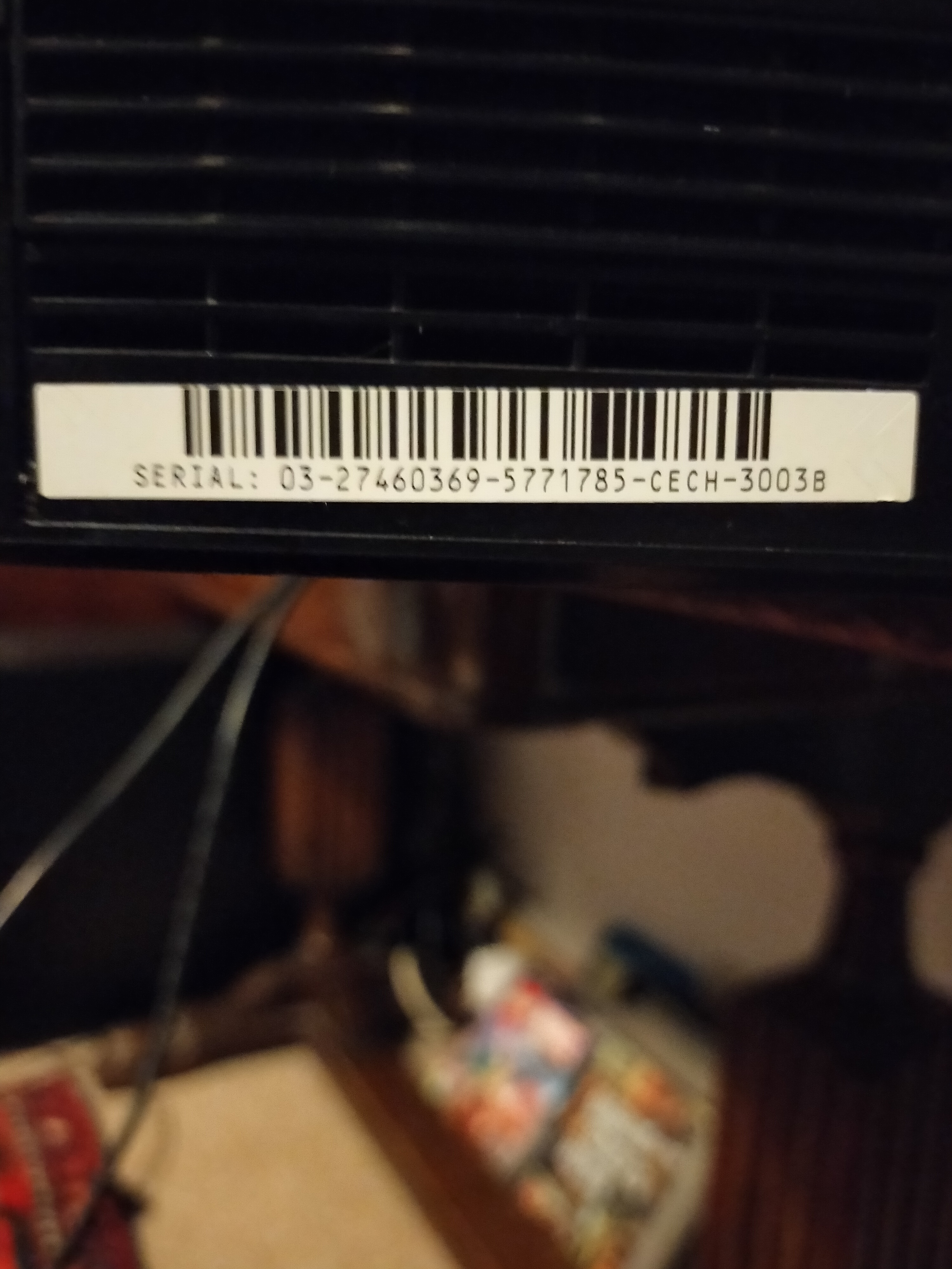

They're connected to the same module, yes. What kind of ps3 is it? Nand, nor, or emmc?
