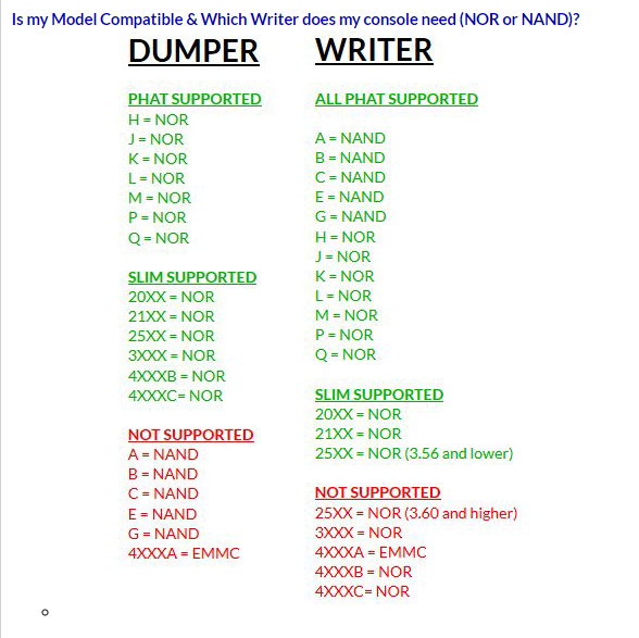

1) Take a look at the table in the picture, check your model #
2) If it is linked, one system get banned, the rest get ban.
3) Hacking ain't too hard, there is a chance of brick if not done correctly.
4) Free PS3 games, PS2 games if it fat model and emulator stuffs like Retroarch

If you have a phat it is most certainly hackable (or downgradable to a lower, exploitable, firmware version, rather). The question is whether or not Sony patched out the most recent exploit in the 4.83 update. Since I hacked mine at 4.82, I haven't really been keeping up with developments that's been going on since.
If 4.83 has no working exploit you might have to get a nand programmer to accomplish a downgrade. I'm a bit hazy on the details, I'm afraid, but here you can see an overview of what's needed for different models of the PS3.
http://www.psx-place.com/threads/chapter-ii-hardware-needed-for-ps3-downgrade.336/
(That site is also a good resource for PSX hacking stuff in general).
There are stores that does it for you, for a fee of course. At least here, I would be very surprised if that's not the case in the UK as well.
To avoid getting banned there are applications that do the job, spoof firmware versions, clear logs and stuff like that (PSNinja I think it's called, at least one of them, there are probably others). As far as I know it does it reasonably well. I only tried it once, and I had no issues. I have since removed the PSN account as it's pretty useless now that the system is busted wide open.
As to what you can do, as previously mentioned you can play JB (jailbroken) scene releases, or backups you made yourself from your or your friends discs, regionfree, directly from the harddrive; can install all PSN titles, you can use a better mediaplayer that doesn't suck as hard as Sony's own crap - no more converting or remuxing mkv's to mp4. Play PS2 and PS1 images directly from the HDD as well, and emulators. In my mind there are absolutely no downsides to hacking a PS3... but then again, I don't care about online or multiplayer stuff. If that's very important to you you might want to think twice about doing it, since there is a risk of getting banned no matter how careful you are.
Hope that helps a little.
