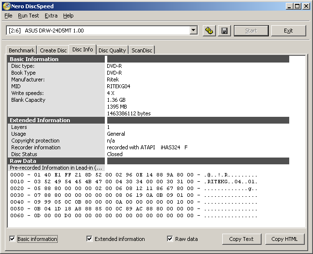

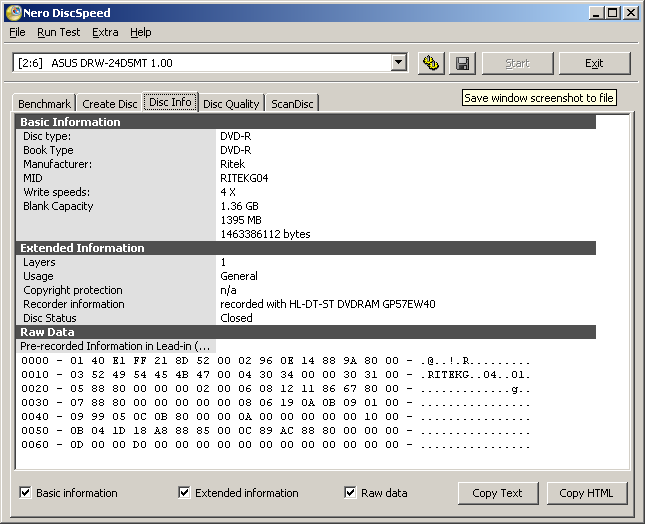

I took two RITEK-G04 mini DVD-R and burned two copies of Pokémon Box with two different writers. DVD-R from the same batch.
The first one was recorded with some external drive. Could as well have been "Amazon's Choice for DVD Burner" a few months ago when I ordered this – to have one external drive for the case I have to deal with modern laptops and need DVD access. Recorders leave their name on the disc.

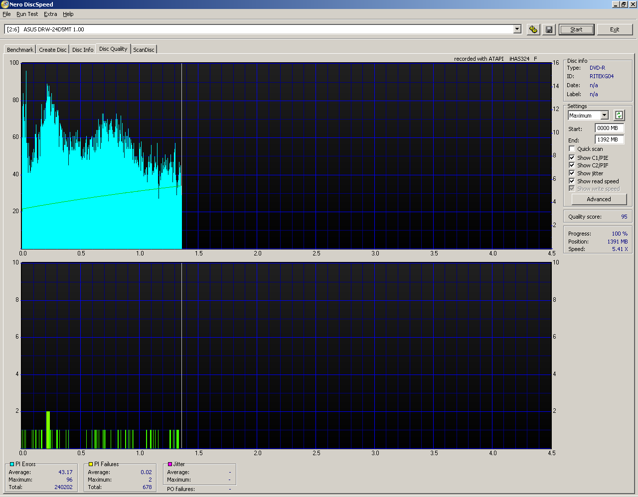

The second one is a full-sized Lite-On drive promising real time adjustment of writing strategy for good burns on unknown and poor blank media.

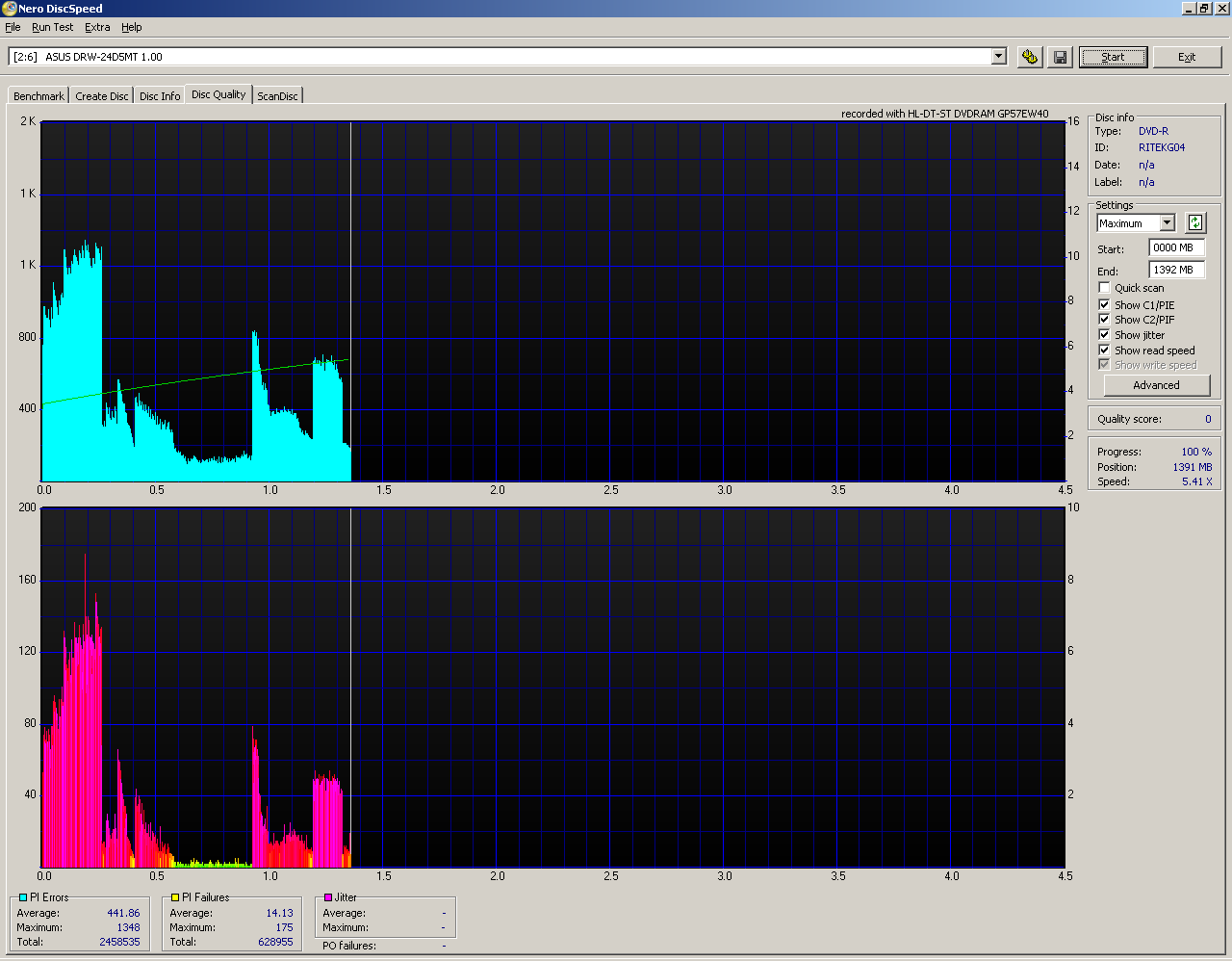

Now have a look at the scan results when checking the burn quality. The external drive delivered a garbage recording. (Lower left corner shows the total errors). This external thing clearly had no idea how to properly handle the medium. Next to incompatible to these blanks. The worst part at the beginning might be still recorded in CAV mode which needs on-the-fly adjustments to the writing strategy.
This is an extreme case of bad burn quality. I've rarely encountered something like this:
The big Lite-On drive seems to do as the bold claims in the adverting says: Almost no Pi failures and a lot less Pi Errors (note the different scale on the upper graph reaching only to 100 and over 1000). The result is not overwhelming quality, but acceptable
