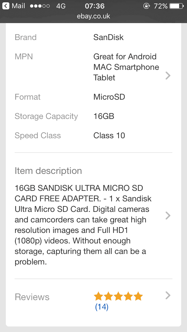

That looks correct - have you tested your card with H2testw? Files disappearing is a symptom of a fake card.
I'll have to do that when I get home. However I use an SDHC with my 2DS and I just wanted to ask if that's fine? Because I bought a new SD adapter on eBay two days ago. It should be arriving at my house today. I took the shots on mah phone.
