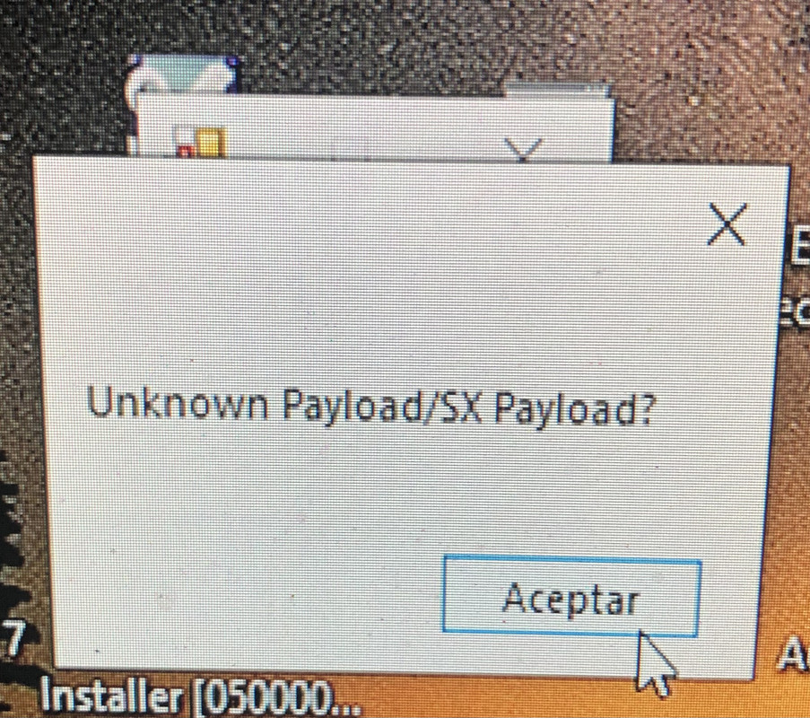

I usually buy them on Aliexpress in this store, recommended by Sthetix, but I put the firmware r 0.30 because 0.62 gives boot problems over time. But only this one has failed me, could it be that the chip is defective? The pauload checker gives me this warning, I think it is not good, I will try another firmware to see.

That only means the firmware is unknown to the checker, the checker does not know all firmware available. It can be taken to mean that the firmware you have is NOT spacecraft 0.10. For an OLED this in is important and what you want. The modchip likely has nothing to do with the problem other than it necessitates fiddling with the volume and power ribbon. Another member also had an issue with the volume buttons but no firm resolution. The troubleshooting would be the same though.
