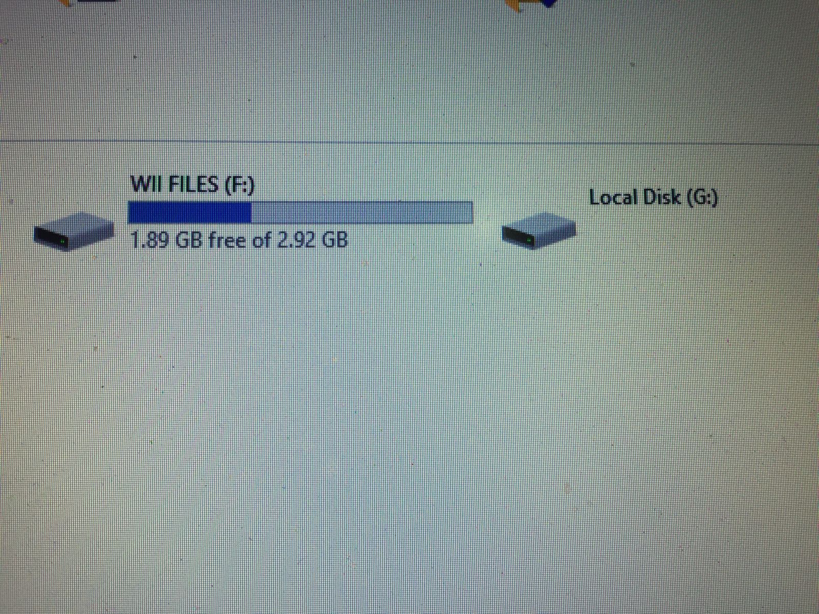

This is my old ass hard drive which seems to be faulty, it makes noises and sometimes my games freeze, but it still seems to be working. I've tried cloning it a few times but it doesn't seem to work. is there any other way I can use a different hard drive?
This is how my hard drive shows on the pc
This is what's on the hard drive.
This is what's on the SD card in my Wii
This is what my homebrew channel looks like.
And these are what the games look like when connected.
I hope these pictures help you help me :yaywii:

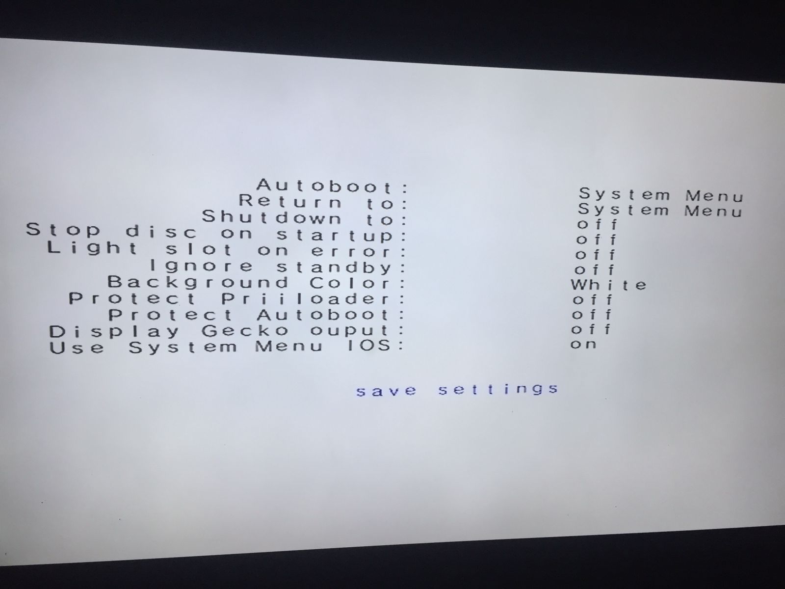

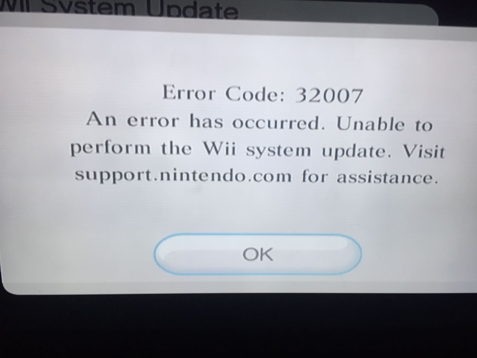

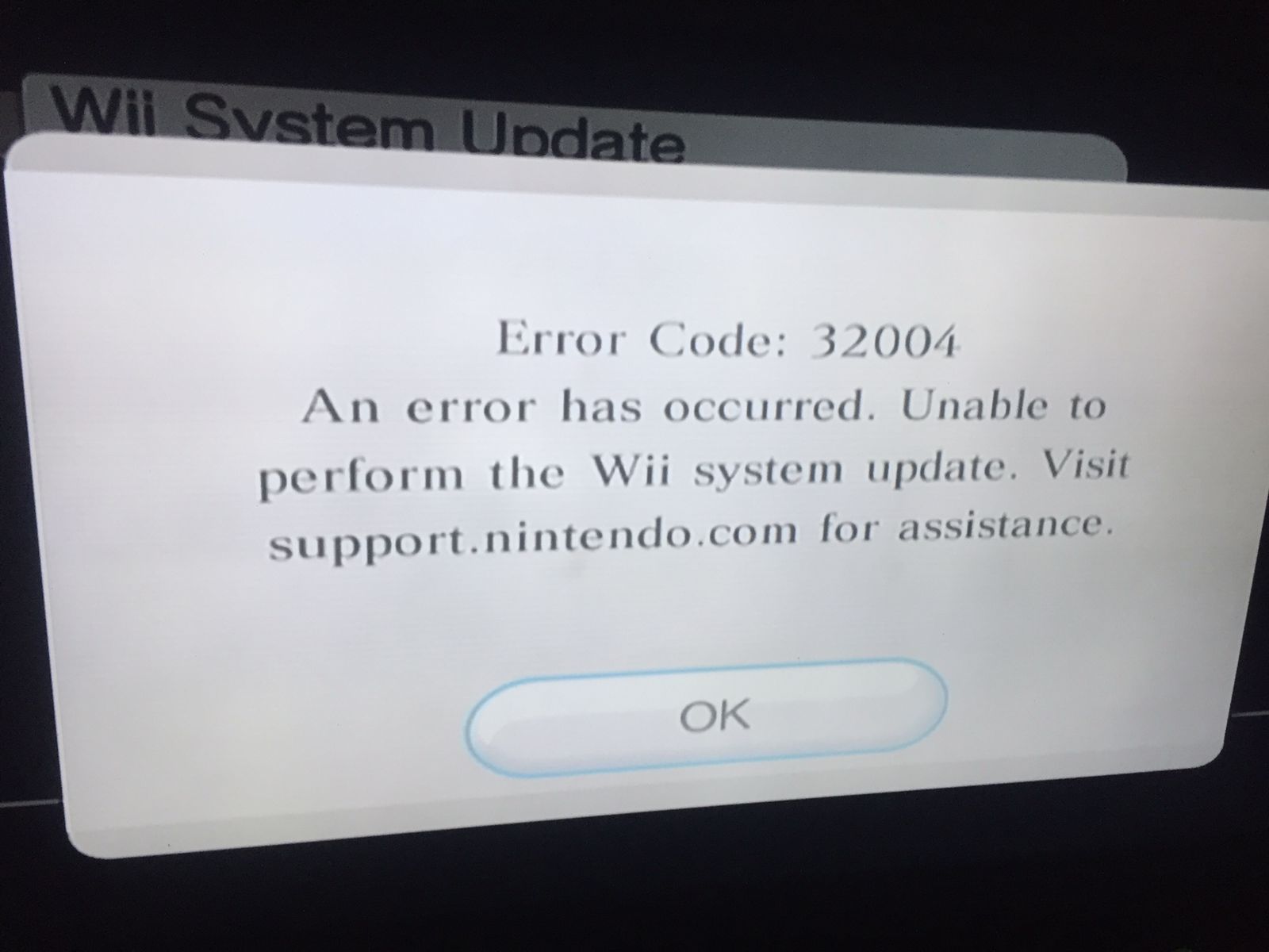

Okay guys I did a NAND backup and connected to the internet to do an update but...
Your Update is blocked by some Softmod and/or Modchip Settings maybe...
Did you maybe have the PRIILOADER installed ?
You can check it by PRESS ans HOLD the RESET Button on your Wii and Power it on.
If the PRIILOADER Screen appears,you can ENABLE the System Update Option in the Settings.
If not,we could use more Information about your Mod Chip please.
Thank you.
Good Luck.:)
dudeitsdelport
Jul 22, 2021
10

Hello.:)
Thank you.
Good Luck.:)
I don't see System Update Option...
Also are you guys sure connecting to the internet wont mess anything up..?:blink:
Reactions: Alexander1970
Alexander1970
XP not matters.
Nov 8, 2018
14,973
Austria
2,497
Austria
I don't see System Update Option...View attachment 270968
Oh,I am sorry,it is under "System Menu Hacks" on the Main Screen:
- Block Online Updates
No,the Softmod stays intact,maybe only the USB Loading related cIOSes must be re-installed.

I've tried cloning the hard drive but it wont work...:cry:
Uh, not cloning just good'ol copy& paste, if you can't move files there's a possibility the file/s are corrupt. Also if you don't care about whats on the HDD, just set up the new HDD clean without all this hassle.
Reactions: dudeitsdelport
dudeitsdelport
Jul 22, 2021
10
23
61
South Africa
So I can only access the files in the F drive... and if I just copy those files no games show up when I plug the new hard drive in the Wii
I guess I wouldn't mind starting again on the new hard drive but I have no idea how to do that.. and I don't know where to get games..
Alexander1970
XP not matters.
Nov 8, 2018
14,973
Austria
2,497
Austria
First Step:
You need only to format your HDD with FAT32 (by the Way,how big is the new one please ?)
Second Step:
You can use the Tool "WiiBackup Manager" for transferring your Games to your HDD.
https://wii.guide/wiibackupmanager.html
Third Step:
You can use Original Wii Discs/Games and/or
you can use Google or your favorite Search Engine to "get Games" please.
Maybe archive.org is helpful....
and if the USB Game Loading is still not working,please do not forget:
- You can use the Part from this Guide
https://wii.guide/cios.html
to install the missing cIOSEs 249 and 250 (251 is not really needed,but it do not hurt your Wii if you want do do it).
Then you can connect your HDD and try your Games/USBLoader.
These are important for USB Loading and missing on your Wii.
Good Luck
