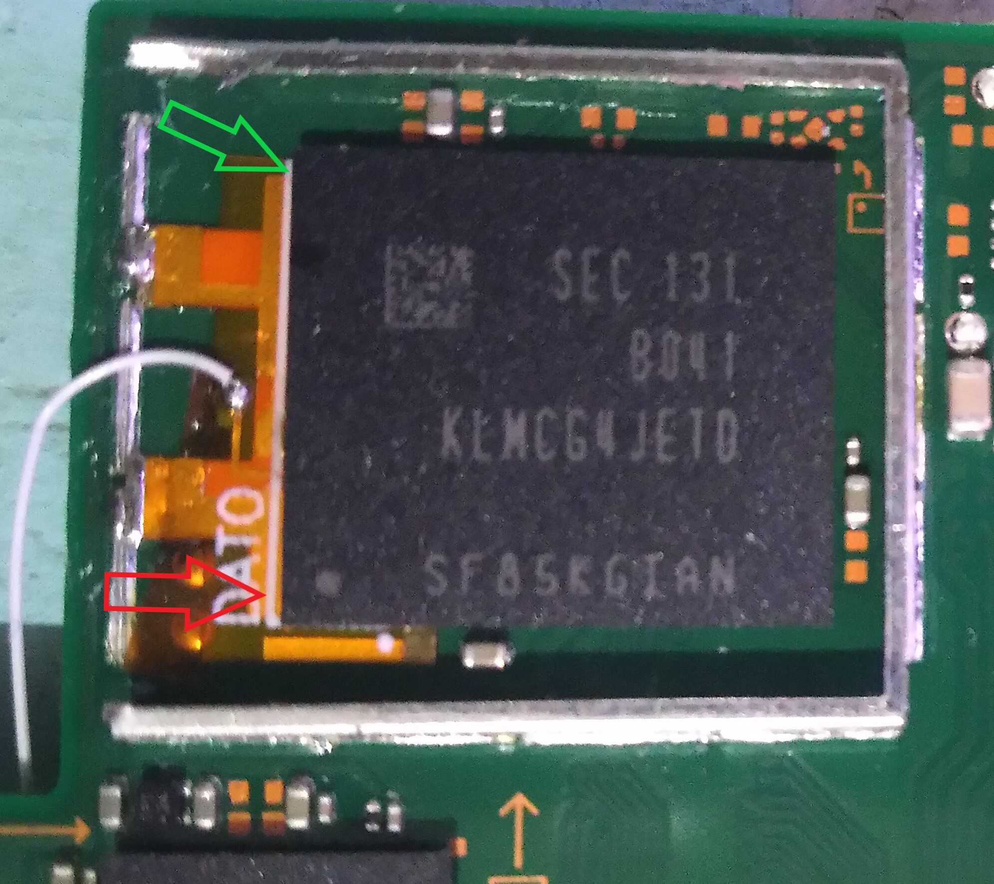

That, or shitty connection. What are the readings on other points: CMD, CLK?
Pico is clearly giving you a DAT0 related error.
I'm giving you as well this image:
That alignment is not good, you do the math.
what do you mean alignment is not good? do i move it forward? left or right(facing from the left)? does that white line need to disappear under the chip?
cmd 492 clk 788
He meant when you look at the red and green arrow you can see the alignment is off.
you the white line should be perpendicular or align with the edge of the chip?

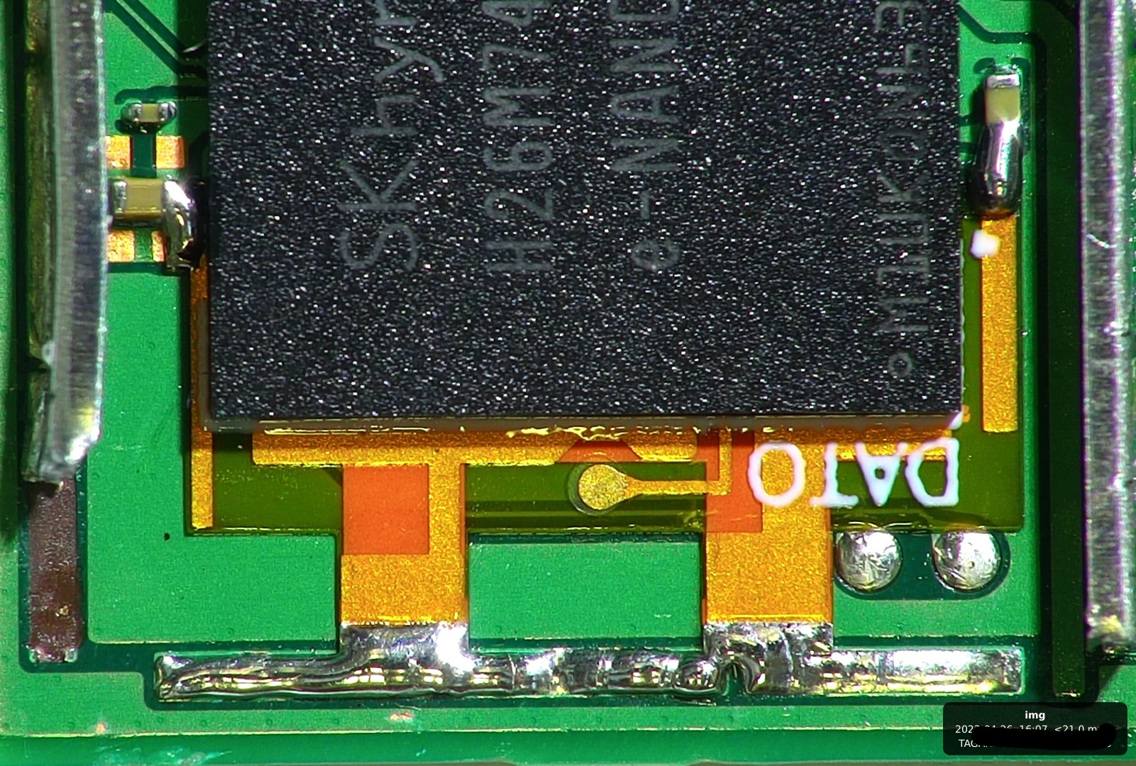

Exactly, the white line needs to be aligned with the eMMC, it should not go under the chip though (check my install below, the adapter is not the same, though you get the idea).
For re-aligning, you need to desolder both anchors, re-align everything and take a reading to ser if it changed.
When satisfied, just press the adapter gently under the chip with tweezers and solder the anchors. Take another reading.
can you give me advice how to move the dat0 adapter? current reading is 798
When satisfied, just press the adapter gently under the chip with tweezers and solder the anchors. Take another reading.View attachment 367315
what reading should i get in my multimeter? im confused with it since its giving me whole number rather than decimals...
I have another multimeter that displays the whole number, 798 is the same as 0.798V.
With the red probe on the GND and the black on the DAT0 point, you should get from 0.4 to 0.6 V. First re-align the adapter, it's not good yet.
Reactions: WalangAlam
