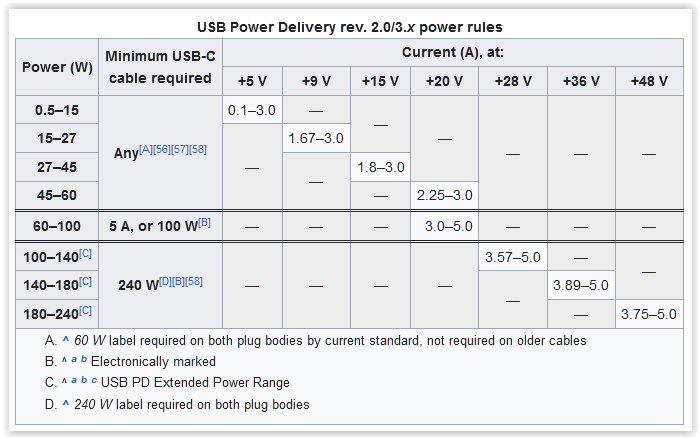

USB PD 2 & 3 standards handle more current:
USB Power Delivery 2.0/3.0​
Profile​
Voltage​
Current​
Power​
Supported devices​
15 V0.1 - 3.0 [A]10 Wheadphones, small accessories
29 V1.67 - 3.0 [A]15 - 27 Wsmartphones, cameras and drones
315 V1.8 - 3.0 [A]27 - 45 Wtablets, and small laptops
420 V2.25 - 3.0 [A]
3.0 - 5.0 [A] *
45 - 100 Wlarge laptops and displays
So any 35W or superior USB-C charger can do the job.

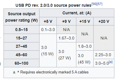

Chargers I have are 5V 2A, it makes 10W. With this table, does it mean I need a 45W charger ? I also saw that the regular Wii need 12V 3.7A so 45W to works. How a regular charger could power the Wii Wii U if can only handle 10W. Sorry I'm so asking

Don't worry, is better be sure than sorry.
as that table describes yes, you console can consume up to 34 Watts (also this study confim it: https://www.nrdc.org/sites/default/files/video-game-consoles-IP.pdf),
The Wii U PSU is a 75 Watts one but normally the console only ask up to 35 Watts max so the cable adapter can use any 35+ Watts USB-C PD charger as stated on the description of the adapters

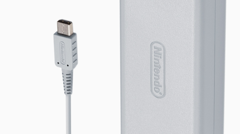

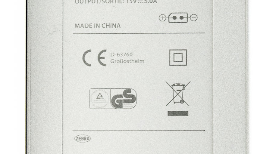

Here is the official Wii U power brick (from my room)
yeah at the official page of Nintendo support is hidden but there is:
