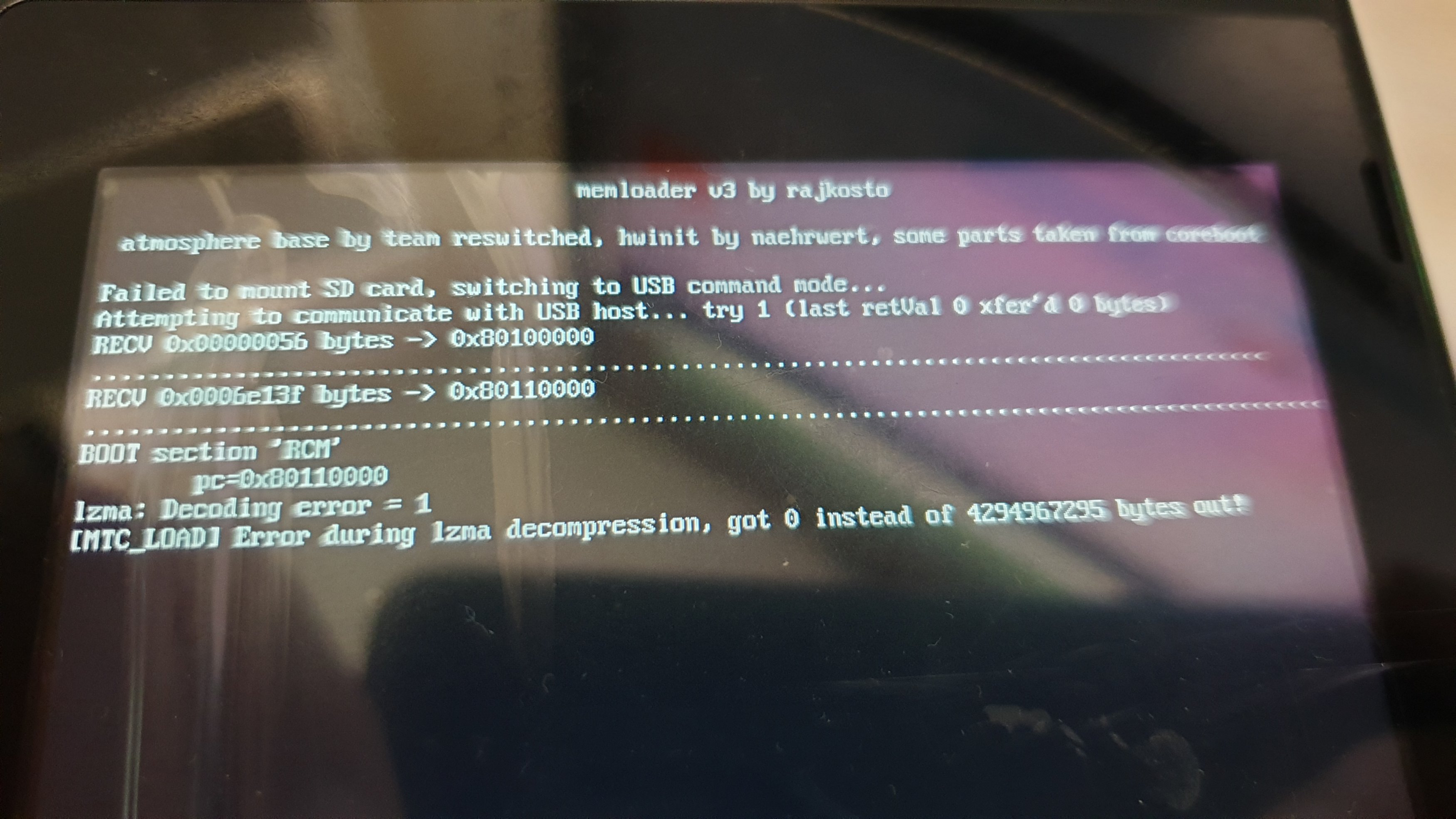

since its onyl showing a bluescreen when not in RCM im not able to do a factory reset.
I see . Can you be able to initial emcc and dump the NAND backup?. If so that mean Emcc is still intact and you could try to restore backup. Sorry I could't help you more, may be can can try to PM @Canna He is expert.
thats exactly what i want to do, but im not able to launch anything that let me dump NAND. Like i said in the first post, only small tools seems to work (e.g. briccmii, biskeydump and so on).
when i try memloader v3 i get this...
all others, (KOSMOS, Atmoshphere, hekate ReiNX) leading to black/ grey screen.
Payloads injectet with TegraRCMGui on Win10 and Win7.
Nmmm I see on Hekate can you be able to check the Emcc partion table?, Just to check if Emcc is fuction or not. Replace Emcc is do able and there is a tut on YT

And most important, this 20€ i can throw in the bin instead and get the same.This all aren´t booting. Why i should buy a licence for a software wich didn´t launch on my switch.
It seems more and more its a hardware related problem, and this problem is preventing the it from boot (Atmosphere SXOS, ReiNX......) (except the little tools) So have to figure this out first.
If you already open up the swith to replace LCD you might want to open it up again to check all the cable connection may be it loose up since you mention it has been drop. Also might as well check EMCC chip too if it become loose. Good luck :)
Sorry could't help you more since I read another tread about blue screen the way another member recom is to restore nand, but since your swith does not respond to Hekate, then something is wrong. Let me know if you find out something.
I came across this processor. after the fall, a blue screen appeared, rcm worked, but when the processor decayed, I saw that there was damage.
