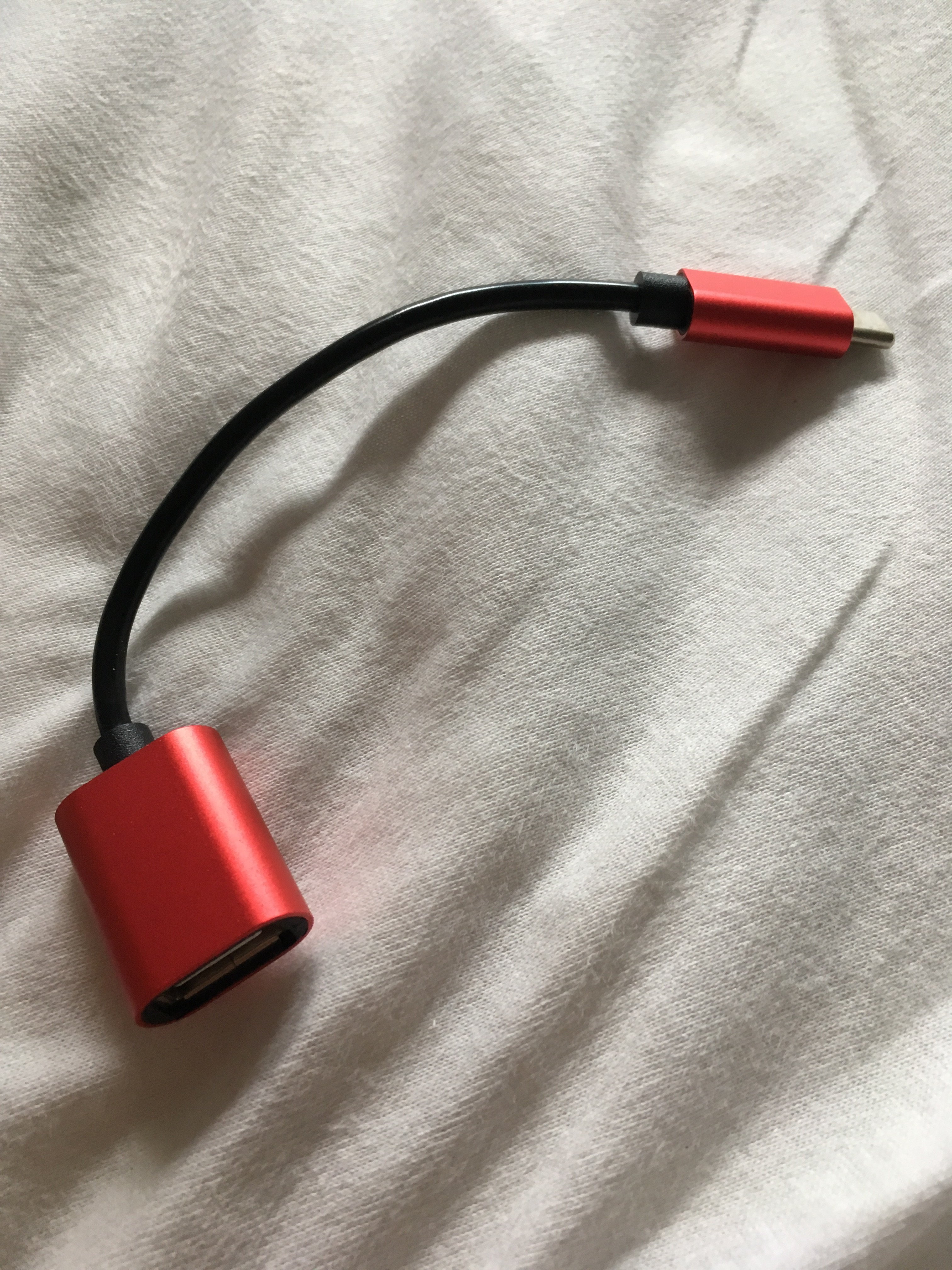

I got this USB C cable from my mayflash Controller Dongle. Can i host a payload with jailbroken iphone with that and a normal Lightning cable?
