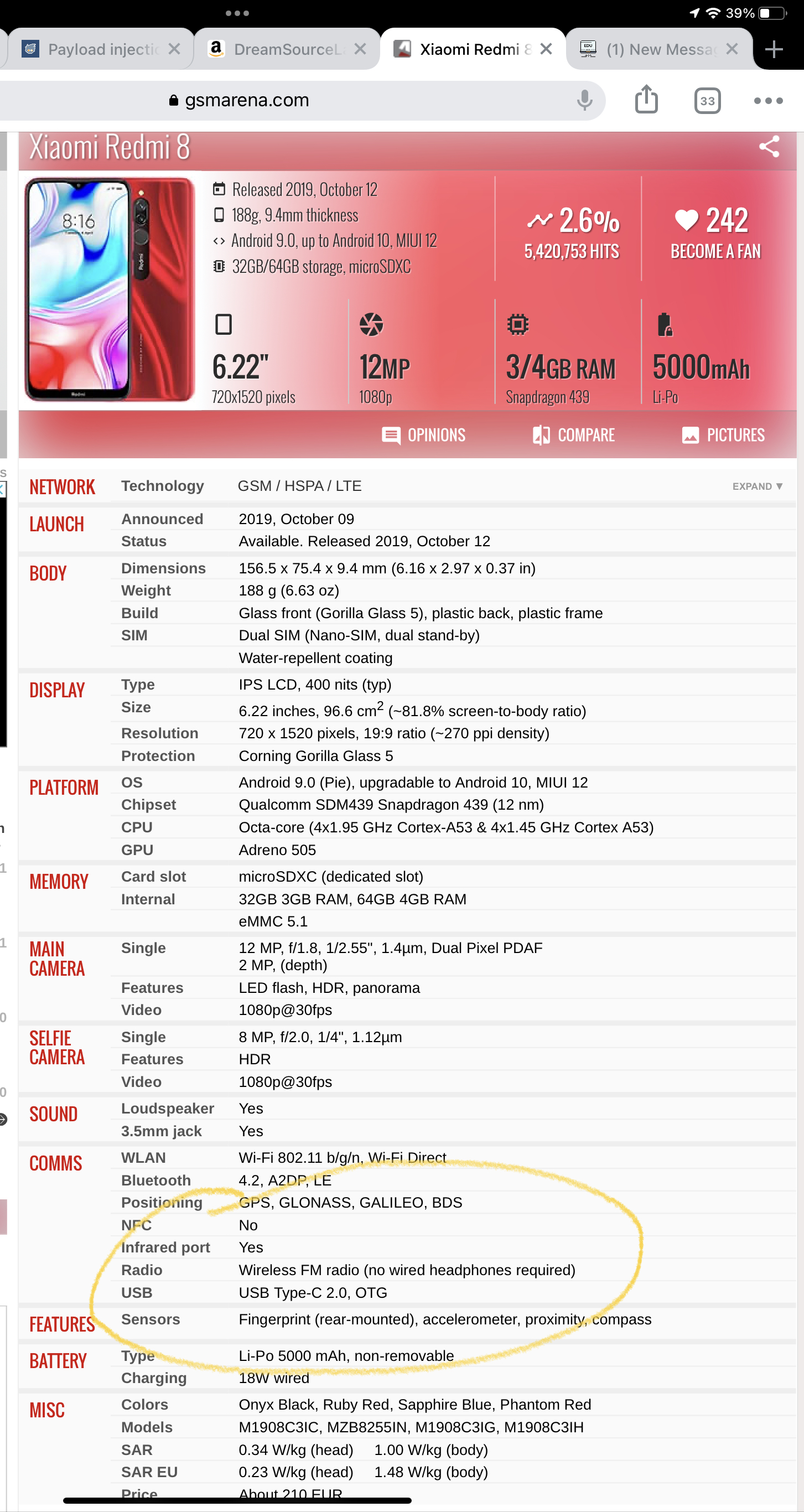

You might be on to something then…
The Enhanced Host Controller Interface (EHCI) specification describes the register-level interface for a host controller for the Universal Serial Bus (USB) Revision 2.0.
XHCI Mode = Smart Auto – The on-board USB 3.0 port function like a 2.0 port before OS USB 3.0 driver load. If you reboot the OS, during this reboot BIOS phase, BIOS is “Smart” enough to avoid downgrade the USB 3.0 port back to 2.0 functionality before OS USB 3.0 driver load
https://www.gsmarena.com/xiaomi_redmi_8-9800.php
I've stumbled on that https://forum.xda-developers.com/t/...-usb-2-0-devices-to-behave-like-xhci.3835603/
I've got a Mi 10 Lite 5G, which seems to have the same specs (USB C 2.0, OTG), I'm using the exact same setup with the adapter and all, and it works fine. So my guess is that I have an xhci driver but you don't (you have ehci). I have a custom rom installed (xiaomi.eu, latest stable MIUI 13 available for my device) so maybe it's thanks to that ? Idk. Did you rooted and installed a custom rom on your phone or is it stock ?
I don't see any magisk module on the manager repo that could help so I have no clue how to fix that, but at least you know the cause
