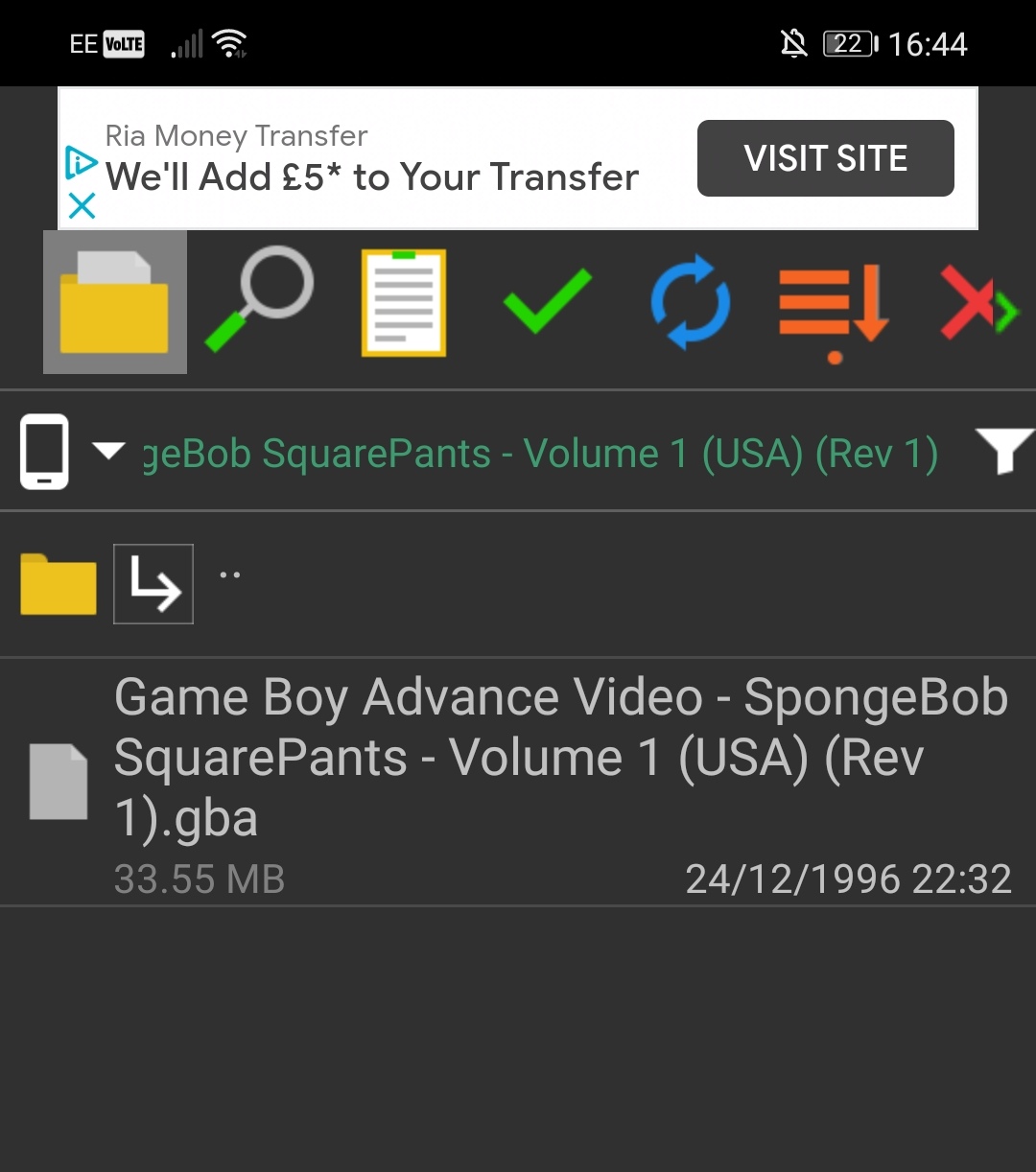

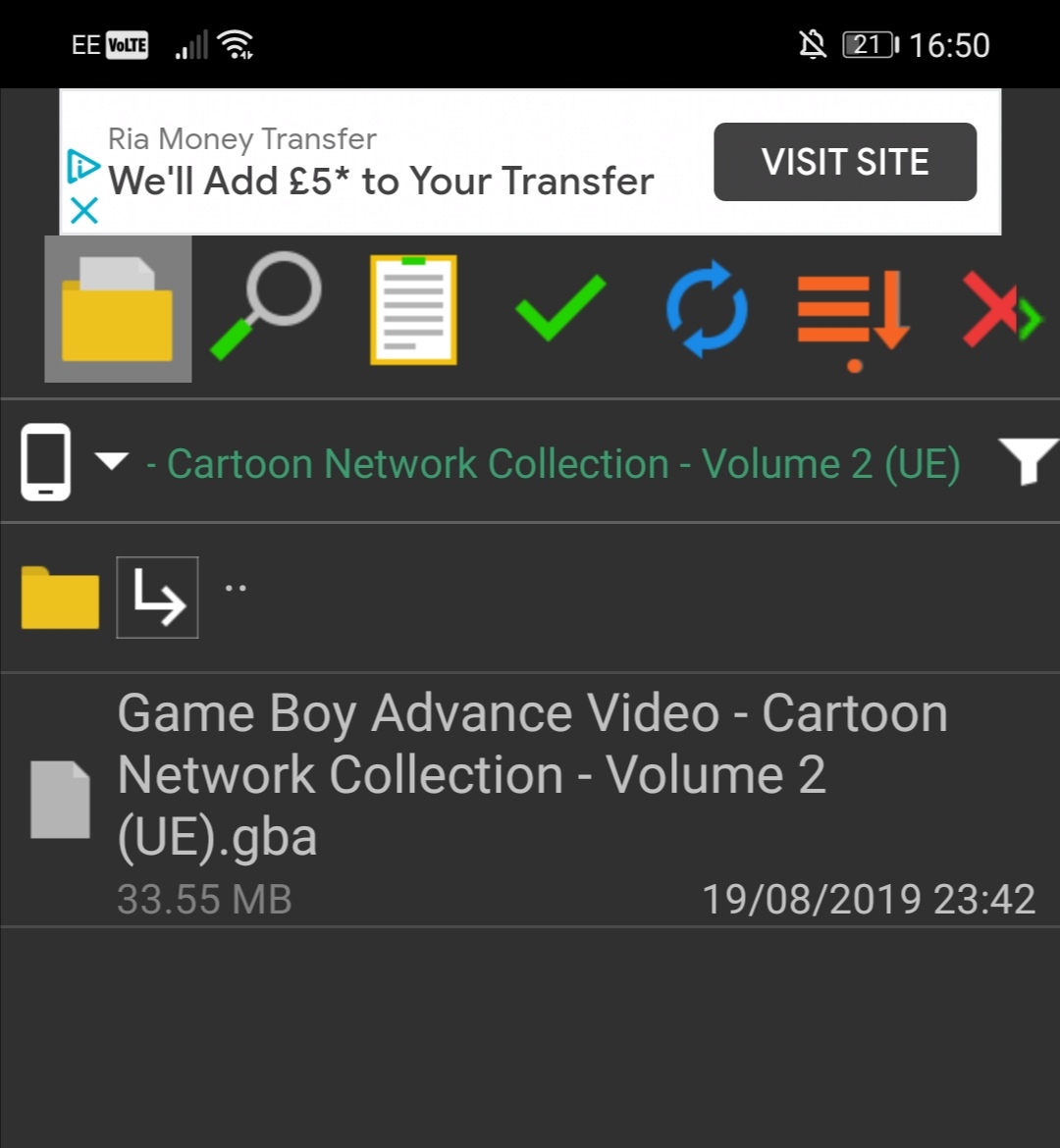

Here is a thread where two of the most knowledgeable people on the temp @FAST6191 and @KleinesSinchen confim that the Video Paks came on 64MB carts they also talk about how the carts use bank switching to get around the 32MB limit.

I see there is a common theme of discussion in this thread: sizes.
It is not a problem with open_agb_firm! All open_agb_firm does is setup the GBA hardware, and from there it is real GBA hardware with custom-made hardware made to emulate common cartridge accessories, like RTC, along with very popular save storage methods like SRAM and EEPROM.
As for the 256Megabit (32Megabyte) limitation: that goes all the way back to the original GBA hardware. To put it simply, there are not enough lines to select where to read the data from, thus creating an arbitrary limitation.
This is the same reason why a byte can only store from 0 to 255, two bytes combined can represent 0 to 65535, etc. The amount of numbers you can represent is limited by the amount of bits/switches/lines you have, and the amount can be calculated from how many of you have. One byte is 8bits. You can toggle those bits on or off. If we count all possible on and off combinations, we get 256 possible combinations for 8 switches. The reason it's from 0 to 255 instead of 0 to 256 is because 0 is also part of the combination list (all bits are off). If you can't imagine this, have a list of numbers, and start counting from 0, and count 256 numbers. You'll count the 256th number being 255. Just as a sidenote, you can calculate the amount of unique combinations for a given switch count, which is 2 to the power of n, where n is the count of the switches. 2^8 is 256 for example.
Going back to the address line issue: even though a real GBA cart only has a 16bit address bus, it's doing some clever logic inside to decode the 16bit address into two 16bit values. The problem is however not on the cartridge side, but inside the GBA SoC: when Nintendo designed the GBA's memory map, they decided that 25bits of address space is more than enough. If you calculate the amount of bytes you can address with that much, you get that 2^25 / 1024 / 1024 == 32Megabytes.
The reason GBA Video can do more than that is because it actually includes a mapper chip. Mapper chips are special chips which help overcome this exact problem, where due to hardware limitations the system can't address more than a specific size. Usually they work by intercepting when you write into ROM (which stands for READ-ONLY memory). Because you can't rewrite READ-ONLY memory that way, it's perfectly valid to intercept the write, and mapper chips interpret these writes as commands. So by writing special values to special places in the ROM, you can tell the mapper how to setup the 32Megabyte addressible space as if you have soldered in new ROM chips.
tl;dr:
- 3DS contains real GBA hardware
- open_agb_firm is NOT AN EMULATOR!
- 32Megabyte limit is a hardware limitation
- GBA Video contains a special chip to overcome this limitation by letting the video player to tell the chip which parts of the ROM you want to read
