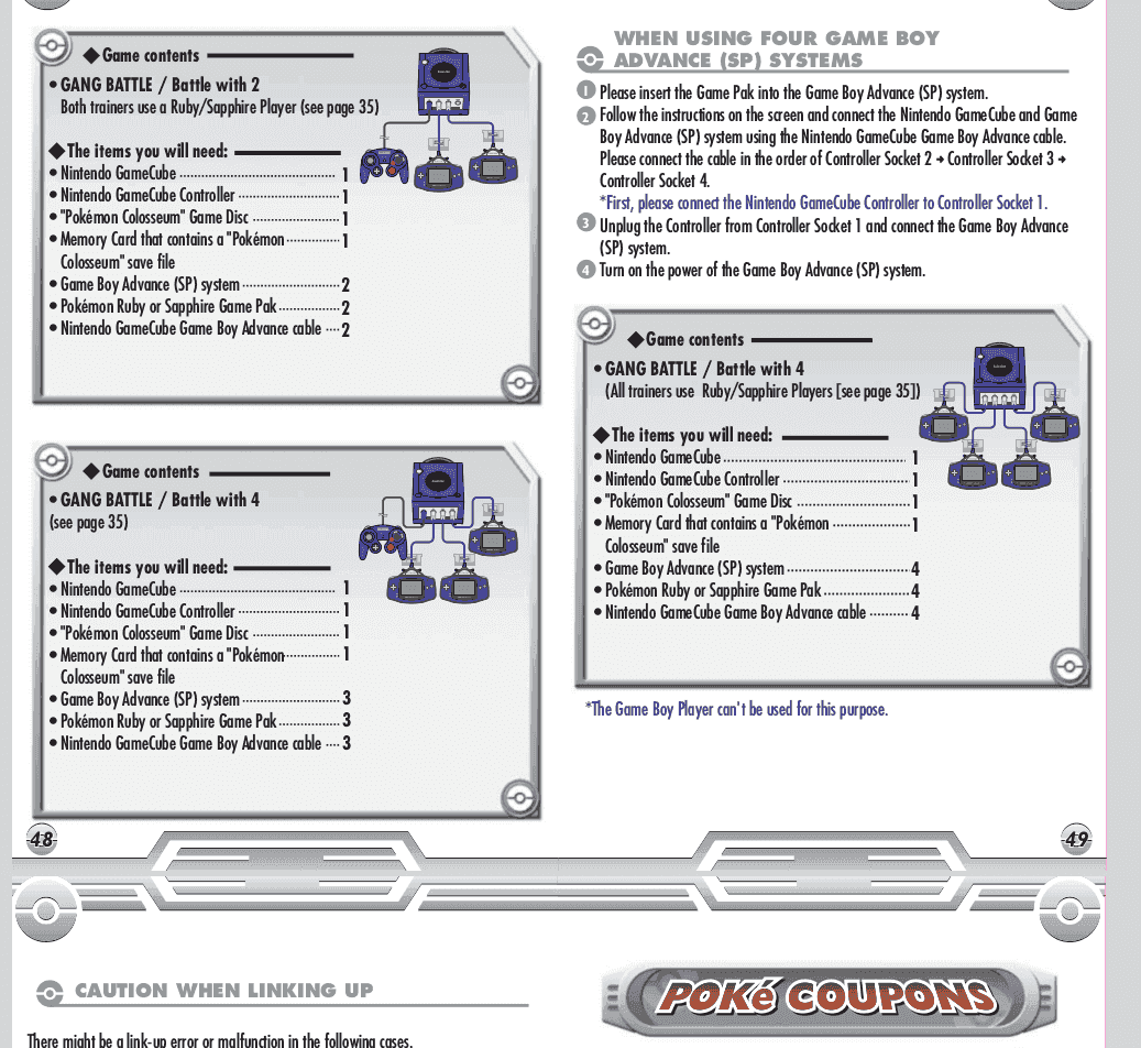

That said when people here are asking about the gamecube they probably mean the games that speak to GBA games via a link cable -- things like Sonic Adventure, pokemon colosseum and the other pokemon games on the gamecube. Much like the pal park thing for the DS games if the host game is trying to read with a Flash read protocol then with flash carts using SRAM it not work and it would fail.
I don't know precisely what happens here for the gamecube stuff -- it might be that the gamecube game sends a multiboot file to the GBA which reads the cart* which would prevent you from booting the flash cart and selecting a game in the first place. I imagine you could possibly set a boot check/NOR read and leave the file in the faked save memory.
Here is a screenshot from the manual for pokemon colosseum
As you just leave it to boot and don't have to do anything in the GBA game like set up a link battle it is probably a multiboot loader it sends.
*most gamecube-gba link games are just a multiboot file that takes input from the GBA and sends the GBA screens for maps/inventory/similar. No game cart or flash cart worries for those.
