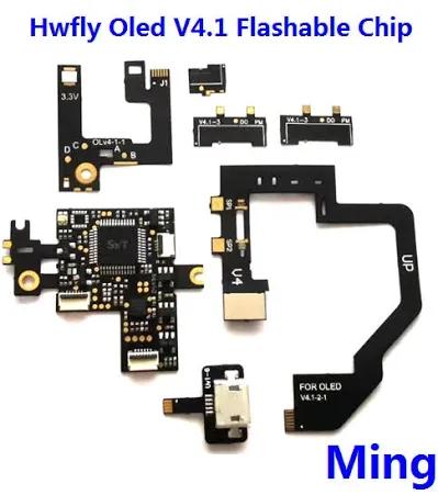

For reference, after searching around I found this image of the chip and cables I have

1. No matter what chip you are using, you need to connect same 4 wires: A/CMD, B/RST, C/DAT0 and D/CLK (and 3.3V/GND of course).
2. Seems like the ribbon cable also has a part next to J1 that needs to be soldered to the chip.. You can verify the connection with a multimeter first, usually these filtering caps are connected in parallel so you don't need to solder to every single one of them.
3. If you are doing a friction fit you better use the full width adapter as it has 2 anchor points and is more secure. Since you are reflowing the chip it doesn't really matter, but usually I use the corner adapter since it's easier to work with.
4. That bug has been fixed in spacecraft 0.2.0. Even with older unflashable chips affected by that bug people tend to say different things, but yes it's fixed.
P.S. Try not to use this adapter as it puts stress on your fragile A and D points. They used to include this adapter with unflashable V3 chip and it won't align properly. Connect it to the modchip and use multimeter to find alt points, then solder to the modchip directly instead.
